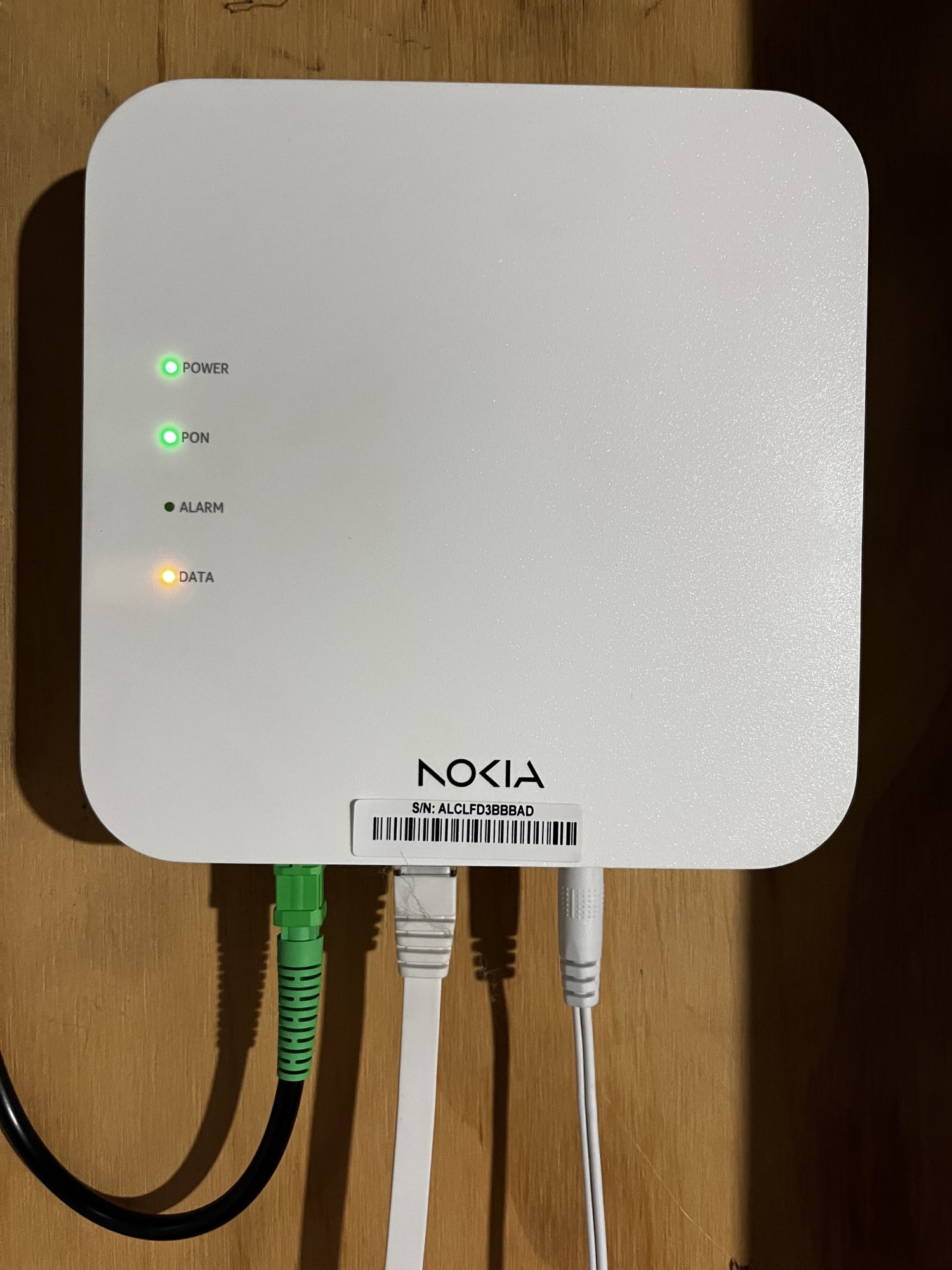

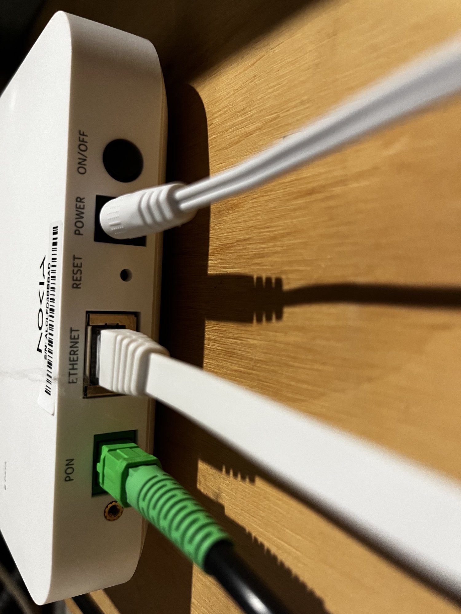

I'd like to move the ONT upstairs to sit with the eero and duplicate what I had in the cable network. I just need to know the patch cable to buy. Pic of the numbers on the cable currently going into the ONT.

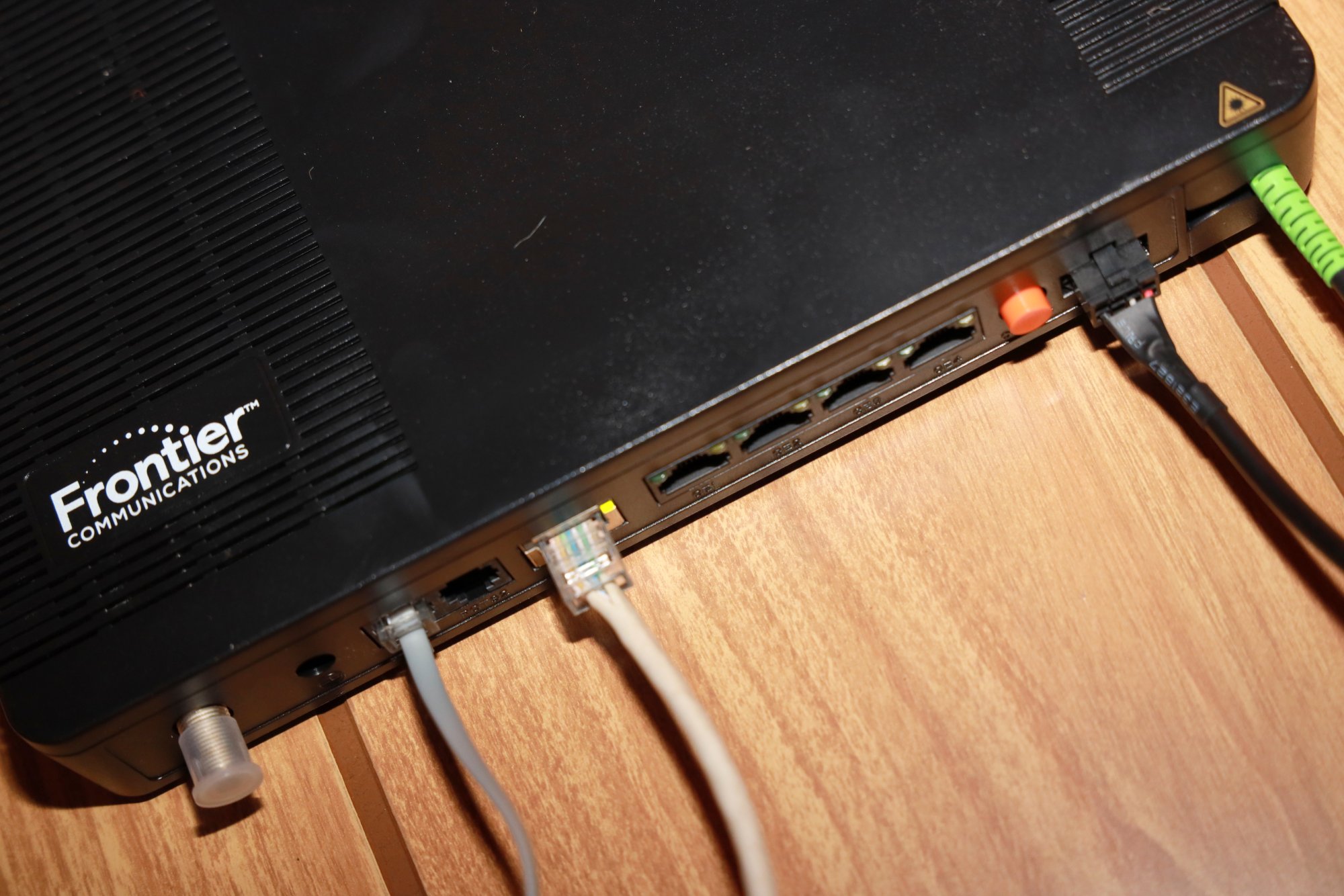

It would have helped if you showed us a better pic of the ONT.

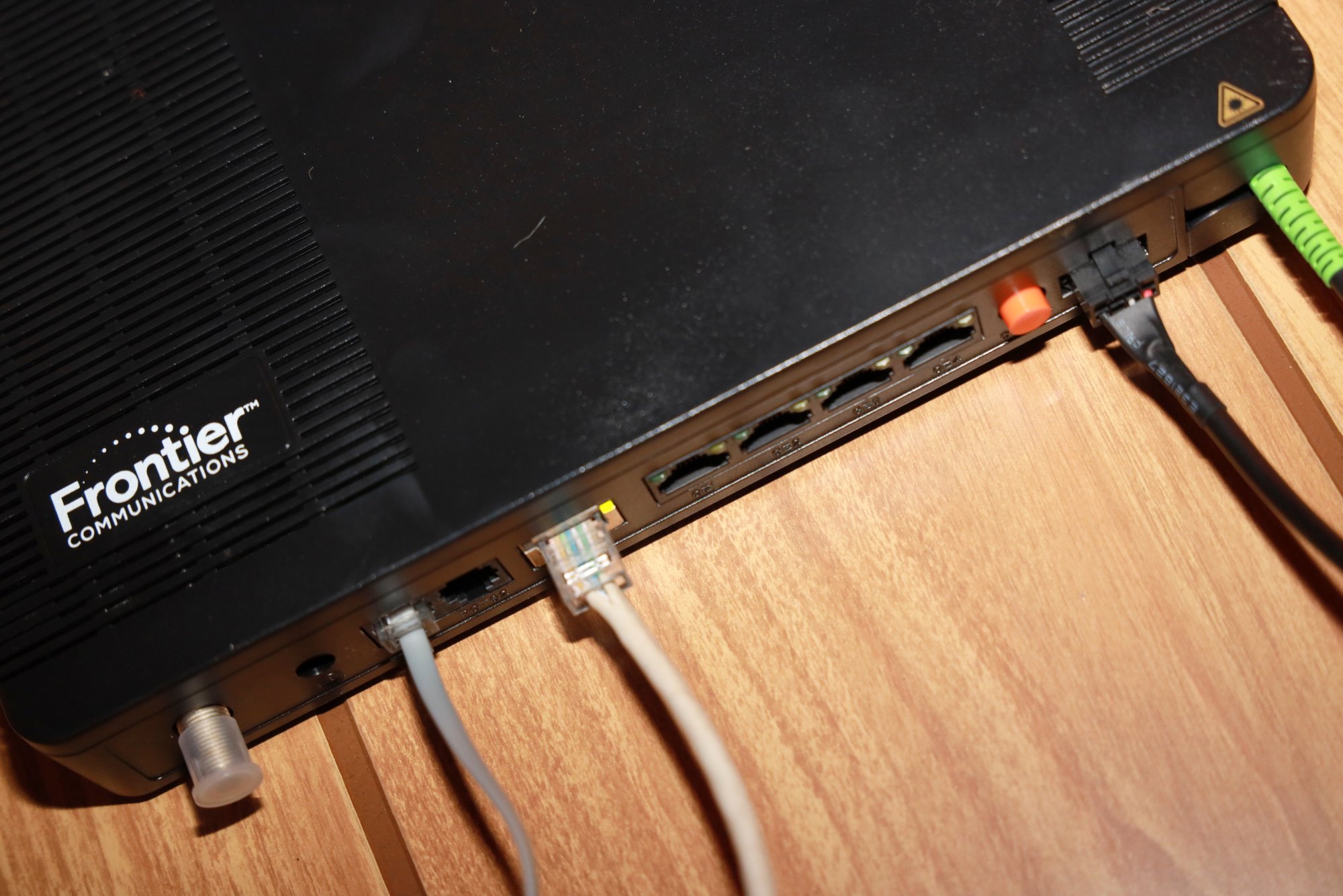

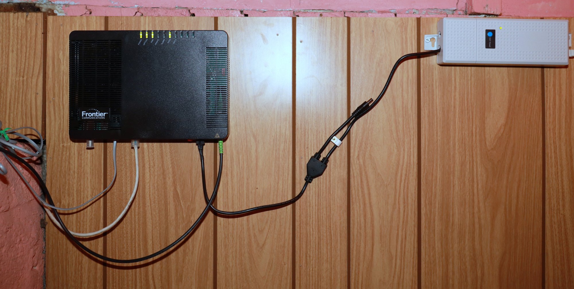

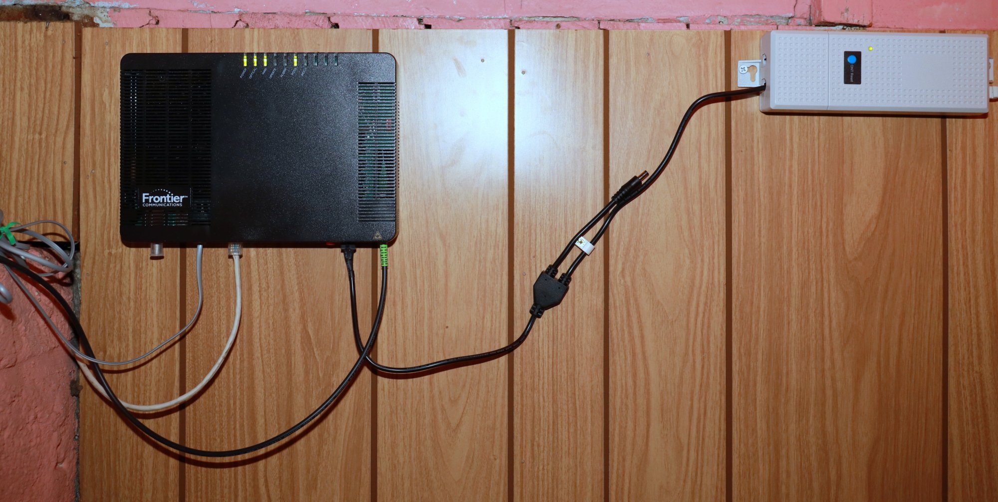

I have Frontier fiber, with an ONT that looks like this:
On mine, there is a group of 4 ethernet ports together, and a "separate" ethernet port as well. See pics.
The ethernet going to the Eero should be in the "separate" port.

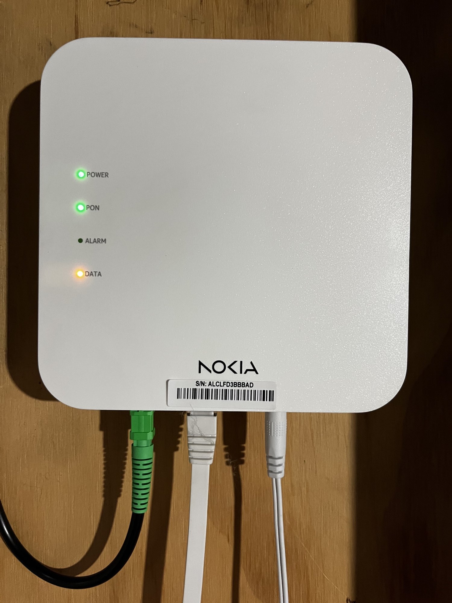

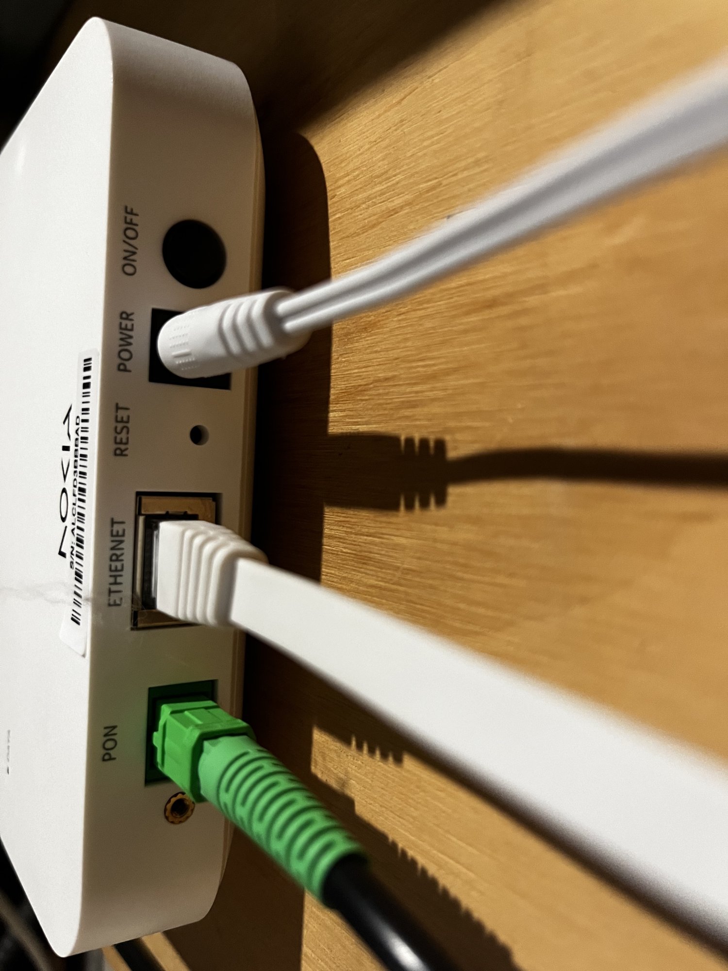

Hey, I'm attaching more pix. Please read my response to SG above too, I added some more details.
It's a 1gb plan
I wasn't thrilled about controlling the eero through my phone, I said that, but wasn't offered another option. He knew the rest of my network was upstairs and left me the CAT6 to run later (I kind of don't want random people banging around in my plaster walls anyway, so I was fine with that)

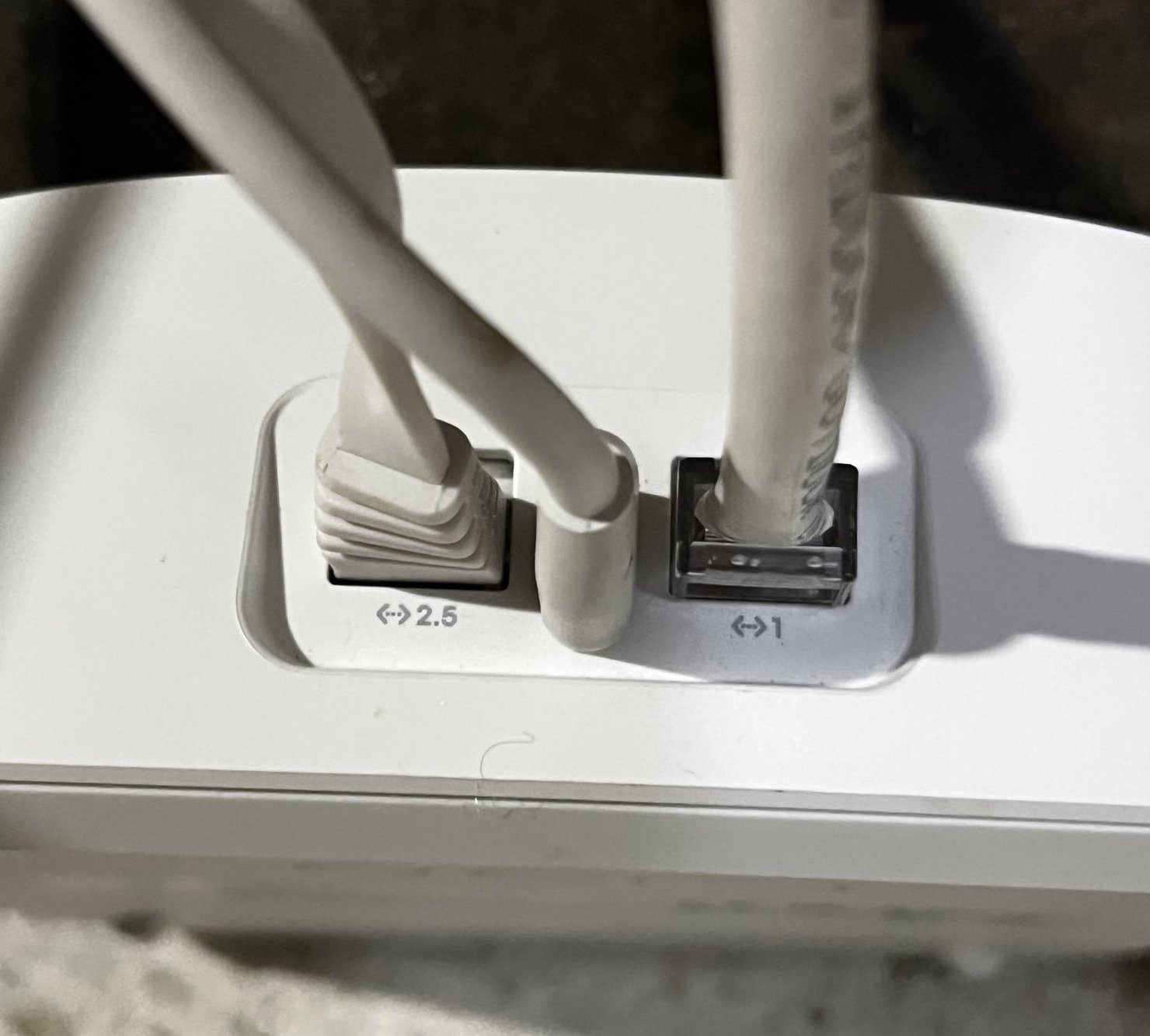

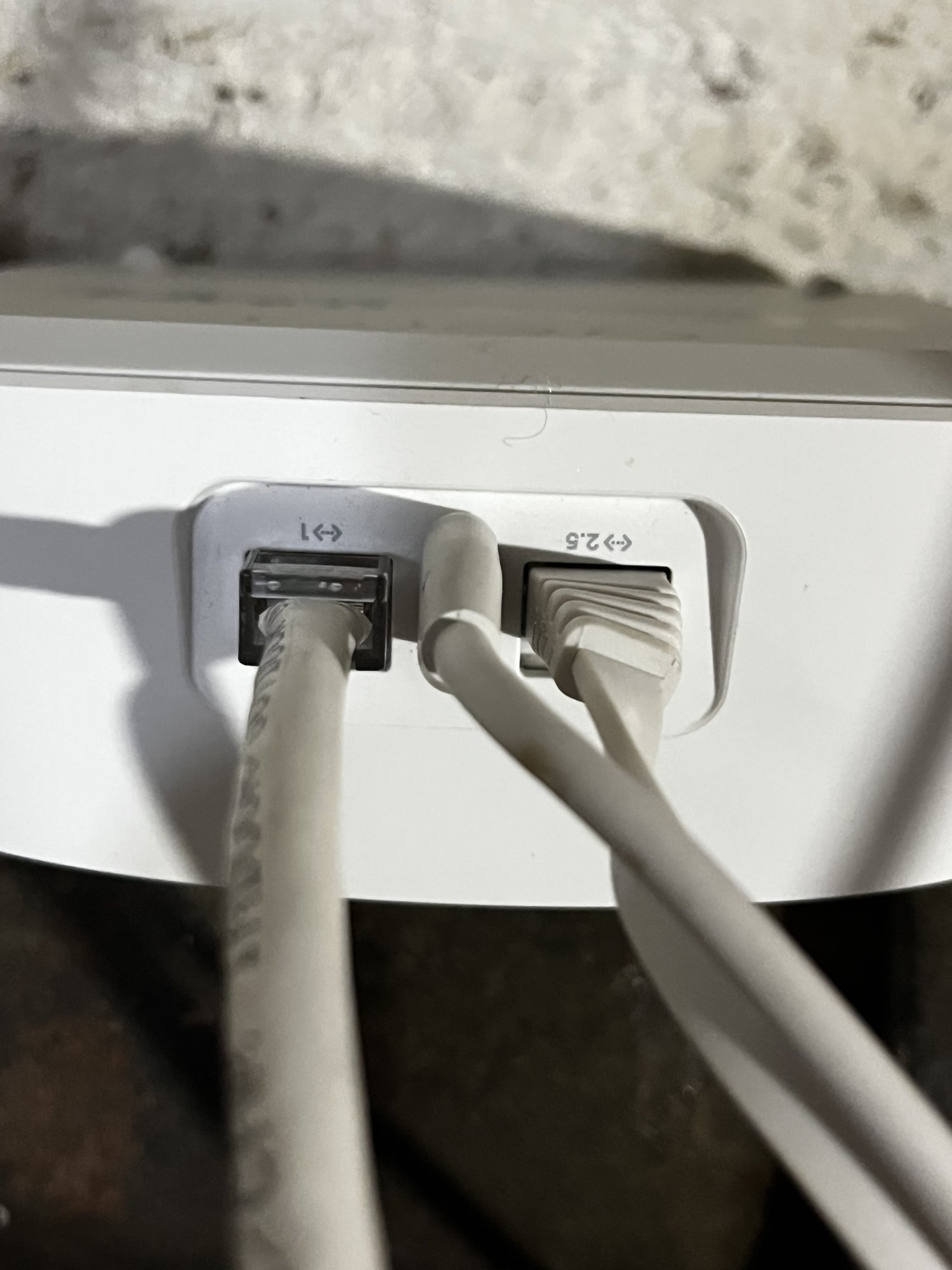

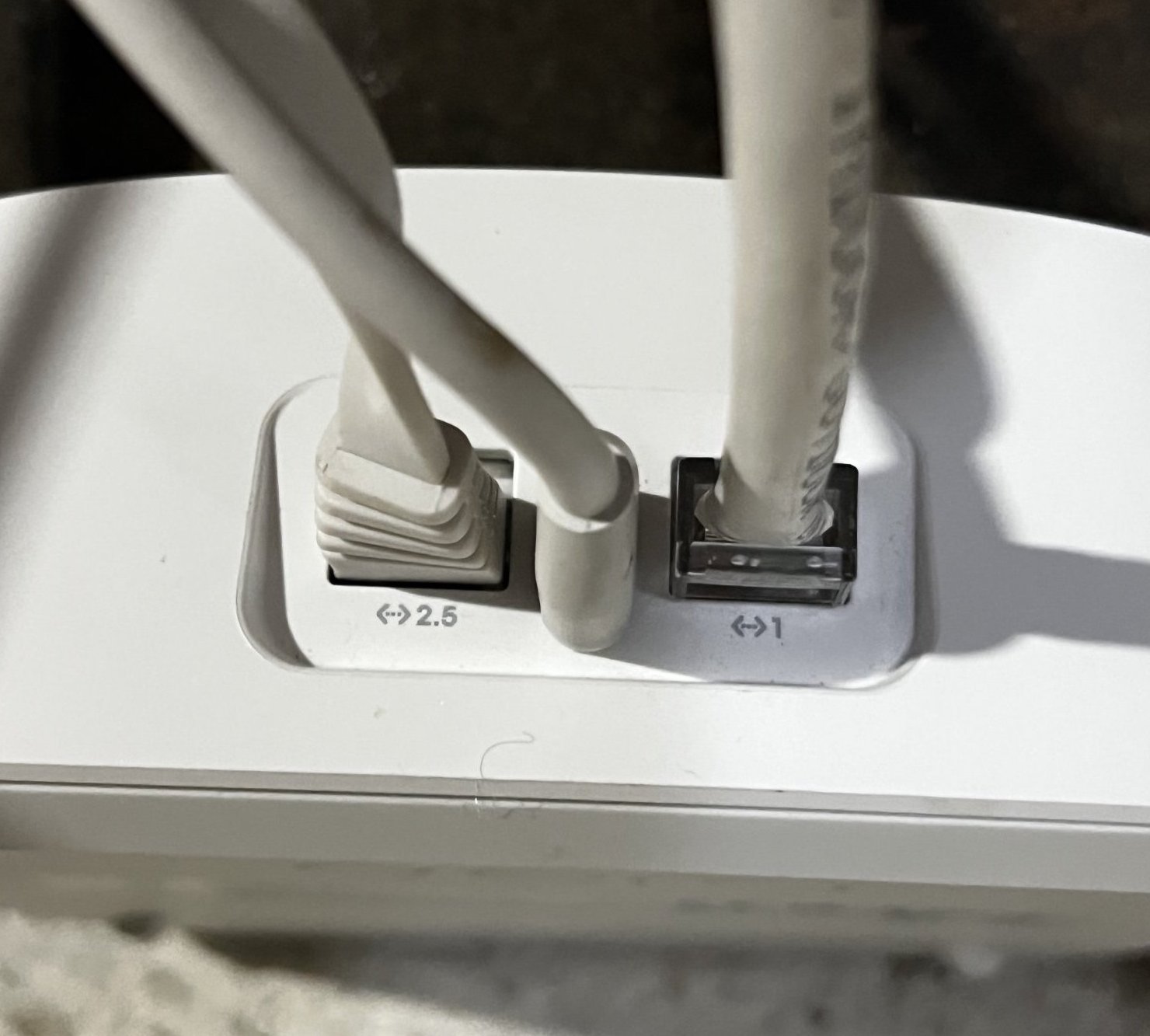

Re this pic:
This is the back of the Eero, right?
What is the 2.5 for?
What is the 1 for?
I'm going to take A GUESS that the 2.5 port is ethernet "in", and the other "1" port is for attaching other ethernet devices?
I'd start out by taking out the cable in the 2.5 port,
then
UN-twisting it,
then
RE-connecting it being careful not to apply any undue pressure on the connection.
REASON WHY:
Perhaps "the twist" is affecting connectivity.
Next thought:
Can that 2.5 ethernet cable (goes to the ONT, right?) be REMOVED and REPLACED by a different cable? For test purposes?
Where does the "1" cable go?
To your switch?
What happens if you remove that cable, and just run with the 2.5 cable?
Does it affect speeds in any way?
Just asking questions for things I'd try myself.

Re this pic:
What is the 1 for?
then
UN-twisting it,
then
REASON WHY:
Next thought:
To your switch?
The twist is because I flipped the unit for the pic, it's straight otherwise. That is the eero.
That flat cable is the one they provided, from the ONT to the eero. It's not very long.
When the eero is upstairs I am not using that cable.. though I could use the cable from the eero to my switch. Then I have the round CAT6 that is in "1"
This morning I plugged that flat cable from the ONT directly into the win laptop (unfortunately my MBPr doesn't have an ethernet port) and that's when I got 700+ speeds (with everything, including me, in the basement). It does work well at that point, it just doesn't fix the really slow wifi speeds (which is most likely a product of being in the basement)
The "1" cable goes to the switch. That is the CAT6 that was left by the tech. Full disclosure, I added the ends. It's possible I guess that one of the ends is having an issue, and I can remake them. I would think I'd be having "no network" issues if that was the case though.
The "2.5" is ethernet in from the ONT. If I leave the eero in the basement and run everything off wifi, nothing is in the "1". That's how the tech left it.
Replacing the CAT6 in the "2.5", yep, thought of that but I will need to find another long cable to see how far away I can get the eero out of the basement. I should have a few patch cables kicking around to test with, I'm trying not to dismantle the entire office but I do have to eliminate the possibility of issues with the CAT6 he left me (aka my ends).
Right now the wifi is downstairs so anything that's on wifi is pretty horrible.
So I think my next step is to find a long cable. Actually I can try that, and also try to move the eero upstairs and use the flat cable between that and my switch. I have tried a couple of different patch cables between the eero and switch but it wouldn't hurt to use theirs.
I did order a new switch but it won't be here till Sunday.
Thanks for the ideas!
