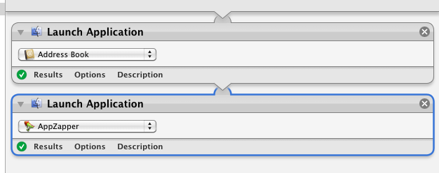

You could create an application in Automator that will open both programs on a single click. Obviously have the corresponding apps in the correct sections. Once you have saved the application put it on the dock and it should work nicely.

Thanks very much for the speedy replies...I'll have a go this afternoon. Hope all goes to plan!
Jon
Edit:
Well I shouldn't have doubted that it would be easy, never mind trying this afternoon, it only took a minute!
I've done it with the script editor, and with automator as well. Not having used either of these before, what the difference between them? It doesn't seem to make much difference which one you use for this example?
Thanks again though for your help.
Jon
