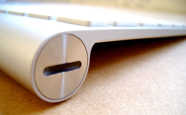

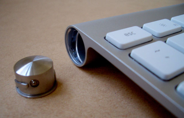

Opened the corroded battery cover
I found white dust on the outside of my keyboard, and discovered the cover to the battery compartment was fused on tight.
Solvents and lemon juice didn't help in dissolving the corrosion. I enlarged the slot on the cover with a Dremel tool, clamped the keyboard to a work bench with a wood clamp, and applied extra twist to a very large screw driver with a vice grip. Even after I managed to turn the cap 1/4 turn, it still did not turn easily.
A corroded battery cap can be removed, but may require strong-arm tactics like these.

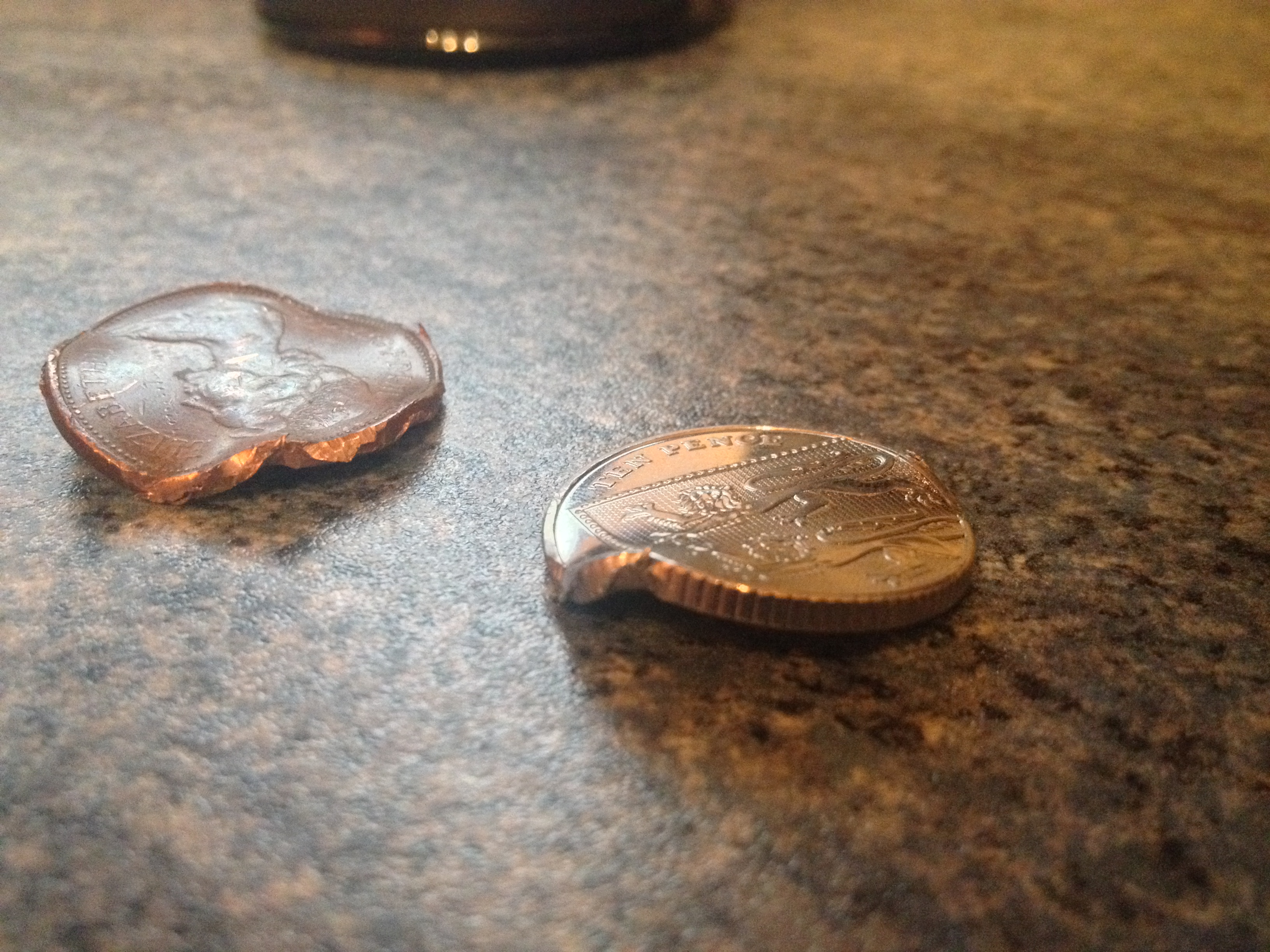

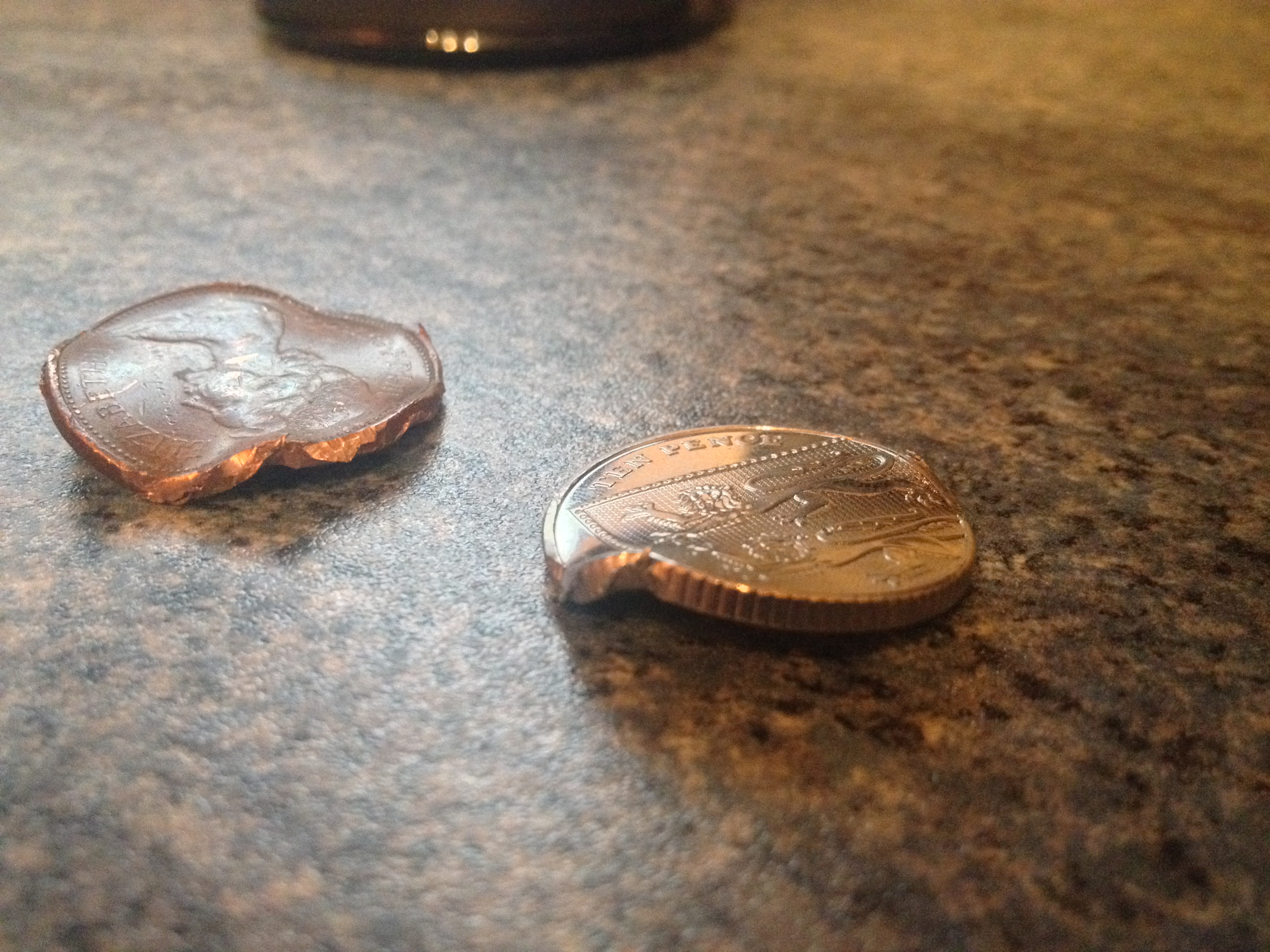

This worked! I only left it for a couple of hours. Put all my strength into it and the battery port shifted! It did completely ruin a couple of coins though.
Inside was cleaned by using a flathead screwdriver and scratching the gunk away, polished off with some rubbing alcohol and more vinegar+baking soda.
