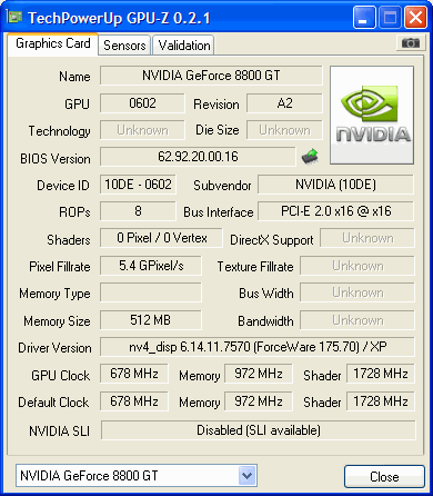

For those of you who are using 8800 GTS instead of non-apple 8800 GT, you can use NiBiTor to reclock your 8800GTS back to its factory higher clock speed and increase voltage back to factory firmware level without using software/registry overclocking (ie, RivaTuner). This way you dont even have to use RivaTuner (although it is great program if you want to overclock your card beyong factory overclocked speed or reference speed). But most importantly you can change back your card's voltage from 1.1V back to 1.15V.
You need NiBiTor 4.0, 8800GT32.rom (from this forum), and most recent Nvidia beta driver.
1. verify 8800GT32.rom checksum (under Adv. Info tab) before you start. Ignore integrity red warning as that is from different file size due to OSX EFI which you need to boot OSX
2. change Device id from 0602 to Nvidia PCI-E 8800GTS G92 (0600) under main screen
3. under clockrates tab, enable change amount of active performance levels. recycle levels from 0 to 4 to enable "extra" row. Enter your card's true core, shader, and memory speed from factory. Put 0 for all 3D, Thrtl, and 2D. Mine was 678 core, 1728 shader, and 972 memory.
4. Under Tools select voltage table editor, change entry 1 to 1v, entry 2 to 1.05v, entry 3 to 1.1v, and entry 4 to 1.15 v
5. Under Voltage tab, change "extra" under exact mode to 1.15v. VID mode should automatically change

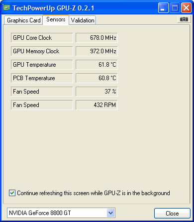

6. Under temperature tab, fanspeed column should now automatically have 100% for extra, 3d, thrtl, and 2D. If not put 100%.
7. open "fanspeedIC" under temperature tab. Fill into match your original 8800GTS firmware setting. Mine was TCirt = 83, min Duty cycle= 37. Rest were same as 8800GT
8. Save. and done. Just dont change Sub Vendor ID, Sub System ID, Board ID. Otherwise your card wont boot under OSX
If you want to overclock higher speed, you should experiment with RivaTuner before overclocking with firmware.
Maybe this would fix the problem with the 8800 GTS I had with the fan not ramping up properly. Too bad I returned it. Maybe I should buy another 8800 GTS.
So NiBitor supports the Apple 8800 GT 32bit firmware now huh? Nice.
NiBiTor doesn't support it yet, meaning program doesn't recognize it as 8800GTS when it has Apple 8800 GT firmware. I dont expect next version for awhile.
But NiBiTor can change this card's clock speed just like any other G92 chip. Just needed to figure out what can be changed and what can not be changed.
Just make sure you have most recent beta driver as older driver doesn't do too good job of recognizing the card.
Most program and OS will still consider the card as GPU 0602 (ie, 8800 GT)

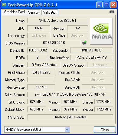

If your card is successfully flashed to 8800GTS, GPU-Z will show corrected Default clock speed (whereas software clocked card will still show 8800GT clock speed under default clock)
I have enclosed modified 8800GT firmware I am using and original EVGA 8800 GTS KO firmware. You can take a look with NiBiTor. IF YOU ARE GOING TO FLASH YOUR CARD, MODIFY YOUR OWN FIRMWARE. I am dont want to be responsible if you decided to use mine.

Just wondering, why you didn't increase base fan speed from 30% to 37%. How is your card running with higher clock and lower fan speed?
I am using default 8800GTS KO clock and fan setting.
Using RivaTuner to clock it to 750/19001/991 with fan speed of 60% for gaming. Runs pretty much all games (not sure about Crysis which I dont have) in 1920 x 1200 with max setting without any problem.
Yarrow,
30% fan speed is a default setup for 512-P3-E841-AR, that valie is obtained from the original firmware. Ckock speed i have used is default for 512-P3-E841-AR as well.
Card just running well.
