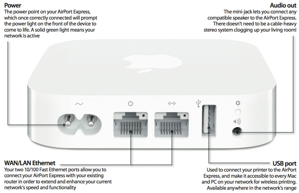

You can test it out very simply. I'm sure you will want to set it up as you wish later, but just to get an idea of how simple it is:
When you can, set the Airport Express, iMac and stereo up together.
Connect the iMac to the Airport Express network, either by ethernet cable or wirelessly.

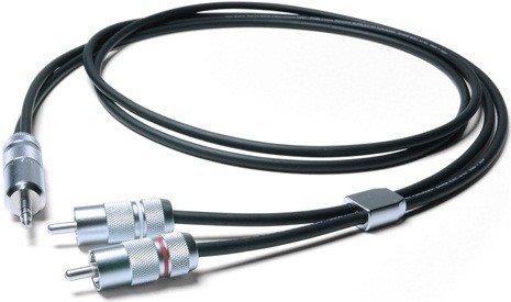

Connect the Airport Express to one of the Pre Amp inputs with a 3.5mm to RCA cable.

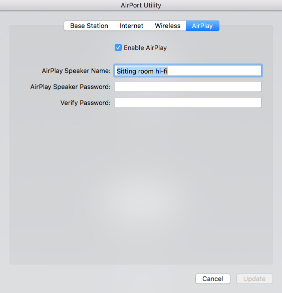

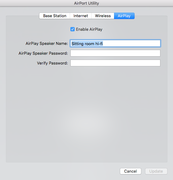

Install / Open Airport Utility on the iMac (or IOS) and select the Airport Express.
Click "Enable AirPlay"
Assign a name to to the field "AirPlay Speaker Name"

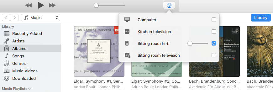

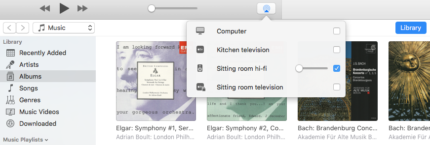

Open iTunes on the iMac
Click the Airplay symbol
Tick the box for your Stereo system
On your Pre amp select the input you plugged the Airport Express RCA's into.
Then play your iTunes music on your iMac and it will play through your stereo.
Later on you can think about connecting it all by ethernet cabling, external DAC's, remote apps and having the stereo and iMac in different parts of the house. But you should have a much better idea of how it works in principle. Hopefully, I haven't missed anything, but it is really simple.

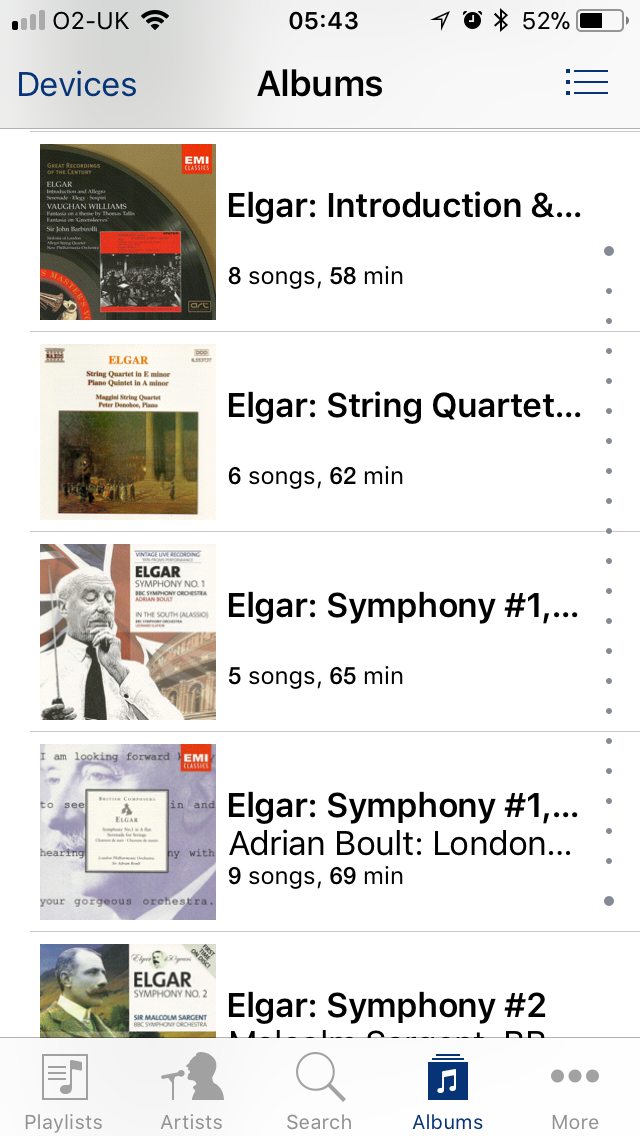

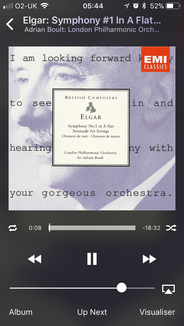

This is the remote app on the iPhone or iPad. The music isn't playing on the phone, the music isn't synced to the phone (though you can), it's just controlling the home office iMac, so that it plays through the Hi Fi in the sitting room / any room without you having to go back to the computer. All the music travels over ethernet, only the instruction from the remote app is wireless.
Album view

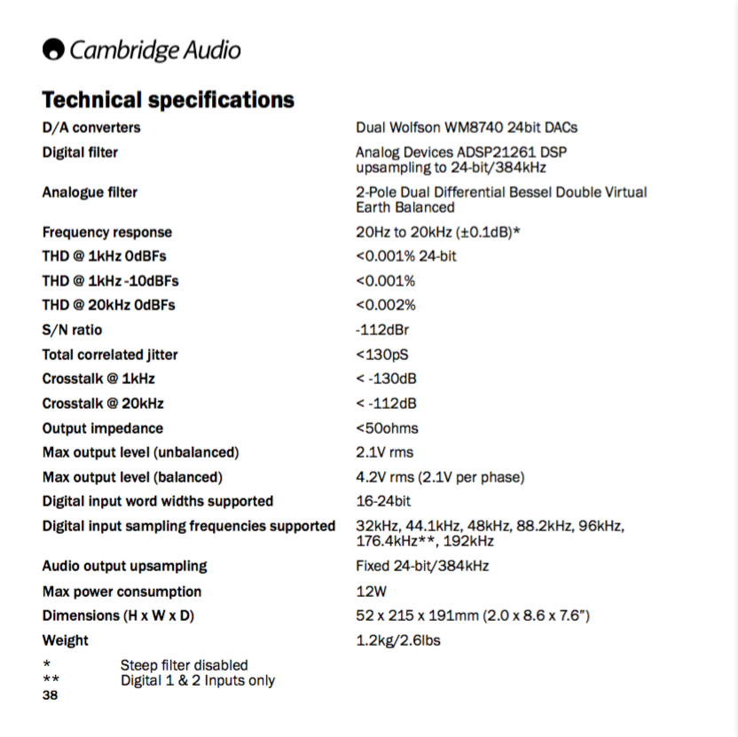

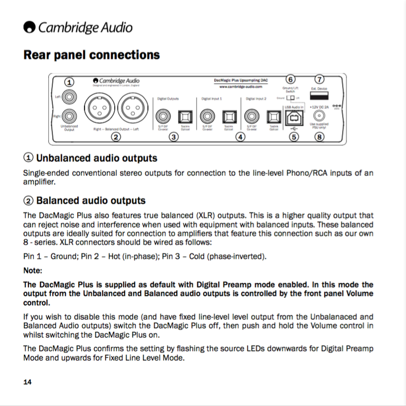

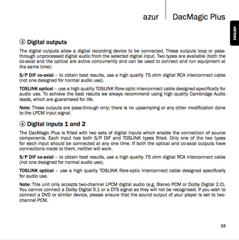

That should be good, but don't add your Blu-ray to the SMSL since it doesn't have Dolby decoding capabilities like those from HT receivers. If your TV and Blu-ray has a PCM out option i.e. the Dolby streams are decoded to PCM before going out, SMSL should work fine.
You probably don't have to spend that much for a DAC that will "do the job"...
While they often use the same high quality Wolfson or ESS Sabre chips, its worth paying for good design and quality components IMO. Also for a warranty from one of the known Hi Fi brands.
[doublepost=1511730882][/doublepost]
You can set DVD and Blu Ray Players to output PCM stereo and Dolby Digital 2.0 if you want to connect directly to a stereo DAC.

It has a fixed line level output which you can connect directly to your Pre Amp. It also has its own built in Pre Amp (you can turn it off) with volume control which you could could connect directly to your Power Amp, which might or might not be of use.
It has 3 Coaxial / Optical connections which is really good. My first Arcam rDAC had only one Optical, the later model two.
It has asynchronous USB.
It uses Wolfson DAC chips which are good quality.
