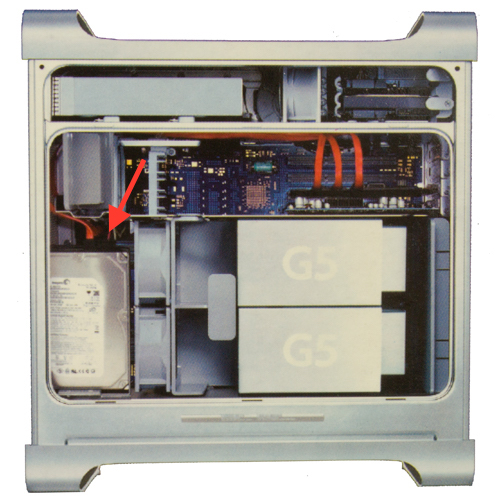

The easiest(really only) place to pull power from is to use a Molex splitter off the optical drive power supply.
I can't speak from personal experience, but you should be okay with 3-4TB HDDs provided that you format them HFS+ and GUID. They will not be bootable-your main boot drive needs to be HFS+ and APM, which will limit it to 2TB. GUID drives are completely readable in PPC Macs, however.

The hard drives would be powered by power connectors... You may need a Molex to SATA power adapter(s) for them, and you may need some y-splitters or some other kind of adapter to get more connectors.

So where am I going to get power? There are no Molex power plugs in this Mac.
I'm sure the cage will come with instructions, but I'd wager a guess they get the power from the back of the optical drive, which in my G5 is an ATA drive.
Here is a link to a webpage showing how to split the molex power connector on the rear of the optical drive. (scroll down 2/3 the page)
