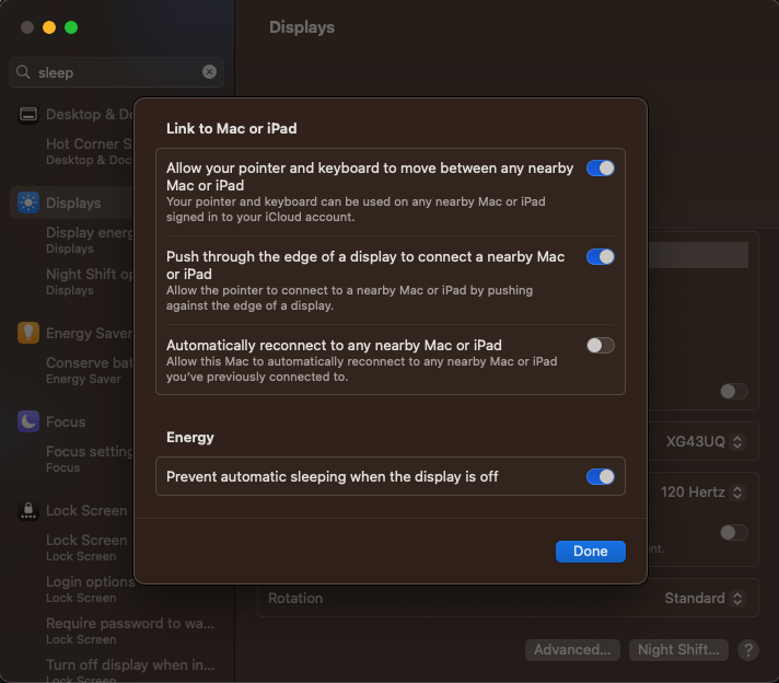

It looks like my Mac Mini M1 goes to sleep even if I set 'Preven computer from sleeping automatically when the display is off.'
Any chance to disable sleep at all? - I prefer it keep working 24/7 🙂

System Preferences > Battery > Battery > Turn display off after > Never
System Preferences > Battery > Power adaptor > Turn display off after > Never

When you are't using it, power off the display - see the first check-box
If I don't use the computer for a long period of time, I turn the display off but when I turn it on, the Mac Mini wakes up from sleep even if the checkbox is ticked... 🤷
Thanks but I don't want the display to be on all the time. I'd like it to turn off after 15 min. but keep the Mac Mini from going to sleep mode.
I see. You seem to have the right thing ticked then 🙂
Maybe someone else can come up with a setting for you.
Reactions: djivatma
With that checkbox ticked, if you turn the monitor off, it never goes to sleep.
So it's not waking when you turn the monitor back on - it never went to sleep
But why in this case my external drive is disconnected and the display has a different resolution / size of the desktop like many other Mac Mini M1 owners reported? ->> it all indicates that Mac Mini was asleep, isn't it...?
