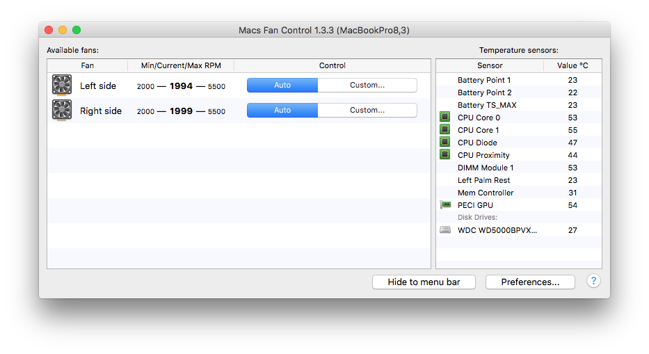

Install MacFanControl and find it out...
As powerpoint is just some pictures this will not stress your GPU at all...

I left the discrete GPU on for a while and check on Mac Fan Control

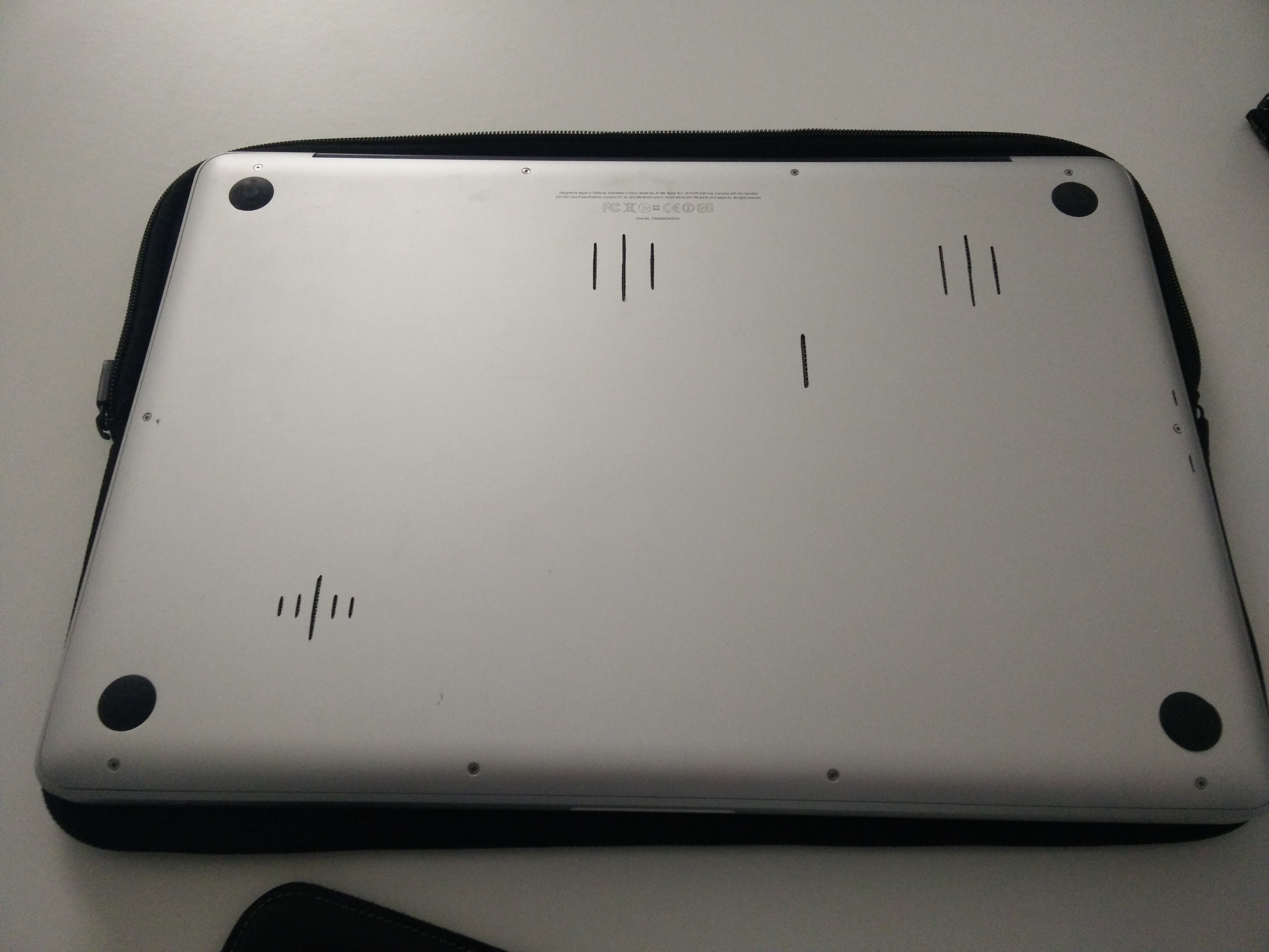

I bought a second hand back cover and drilled some holes to my macbook pro 15 2011
Also have a fan control app installed, no problems so far. Nonetheless I'm happy they extended the warranty.
You should make holes near the ports where the bottom case is curve. That way, the holes won't be covered when the laptop is sitting on a flat surface.
