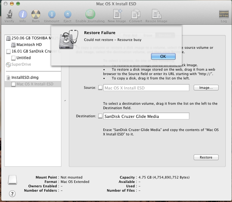

Urgent help needed!:
I'm attempting to do this now, following the directions in the pdf file at the top of this page. However, I'm attempting step 9, and after clicking erase and restore, I am getting the error "Restore failure - Could not restore - resource busy."
I have attached a screenshot of where I'm at..please help if possible!

try restoring the 'mac os x install esd' not the 'installesd.dmg' - just trying this now, should work, though i've read that error shouldn't have any effect on the working of the usb.
