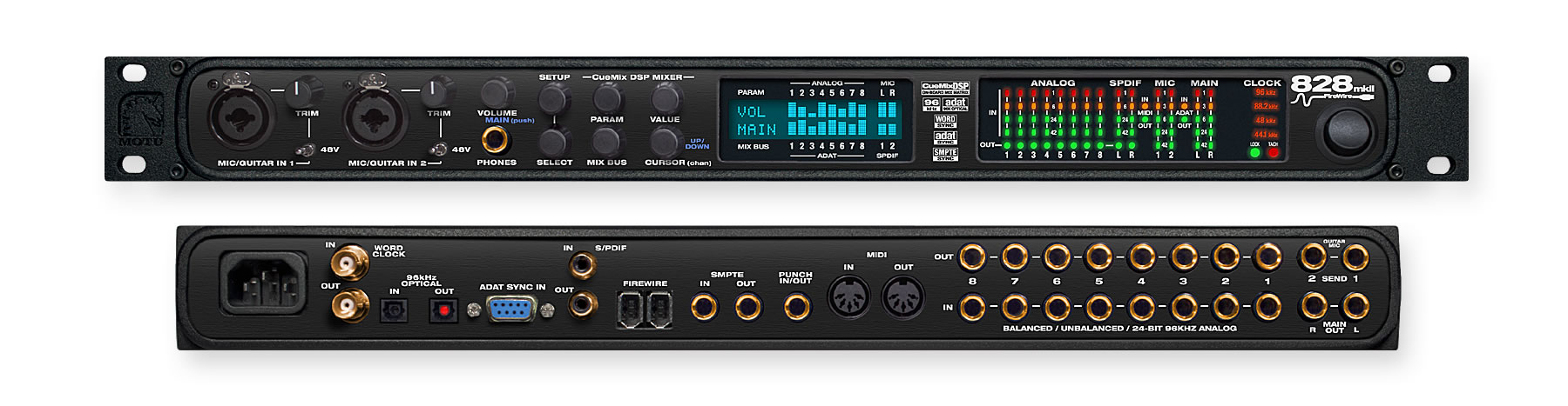

Here is a picture of my MOTU interface:
I have one end of the cable plugged into my guitar and the other end plugged into the back of the MOTU under the channel 1 input. In Logic, when I create a new track, I set the input to "Input 1" and the output to "Stereo Out", but when I do this, then it defaults to my microphone (which is plugged into the Mic/Guitar 1 input on the front). If I change the output to a mono output (Output 1), I still get the microphone.
I admit, I'm fairly clueless about this, so any help on what I'm doing wrong and how to get this going would be greatly appreciated. Thanks!
Your guitar should be plugged into one of the front inputs (labeled Mic/Guitar In).

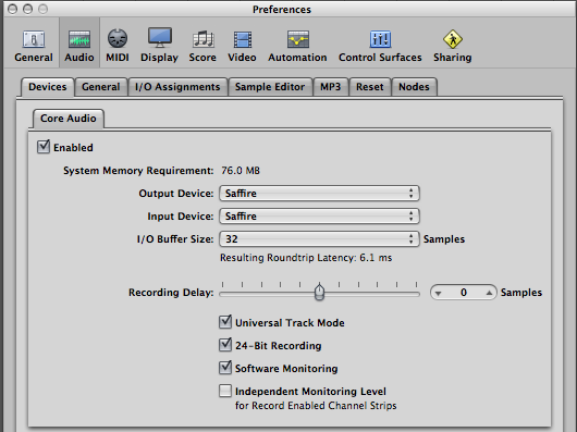

Just checking, have you gone to preference --->Audio ?
And then change your input to your recording interface?
