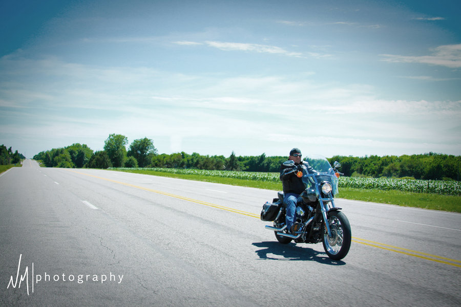

I tried a new type of photography today where I was in the back of a Jeep Grand Cherokee driving at 60mph to photograph a motorcycler because he wanted shots of him riding. I got plenty of good shots, but I was thinking it might look interesting with everything but him blurred, to imply speed. Here's one of the shots:
I was thinking maybe a lower exposure and higher aperture or something, but everything i tried caused the entire image to blur from the bounciness of the Jeep. So is what I want to achieve possible? If so, what settings would you recommend? I'm thinking it might not be possible due to the constant motion of the vehicle I was in.
For this particular shot, I thought the lack of motion blur was fine, but some of the others could've benefited from it.

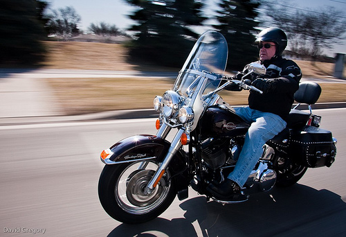

I took this shot of my father on his motorcycle from the window of an adjacent car.
Speed was 60 kph, 1/25s, f/14. Remember, the more to the side of you the object is, the faster the light travels, so, you won't need as slow a shutter speed than if the object were exactly behind you. Also, a lot of times people just use photoshop to create the same effect, you see it a lot in car ads.
