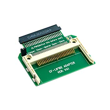

Hi,
you don't have to partition the sd card. Just format it. I use disk utility on my mac and I choose MS-DOS (FAT), maybe ExFAT also works. I also choose MBR (Master Boot Record). Then plug in the USB Cable and iTunes will recognize the iPod as Windows partitioned iPod. Just restore the iPod with iTunes and every partition that is needed will be created.
You need this adaptor: 50 Pin 1,8 Zoll IDE Adaptor
You also need a CF to SD Adaptor
Regards
Torsten
