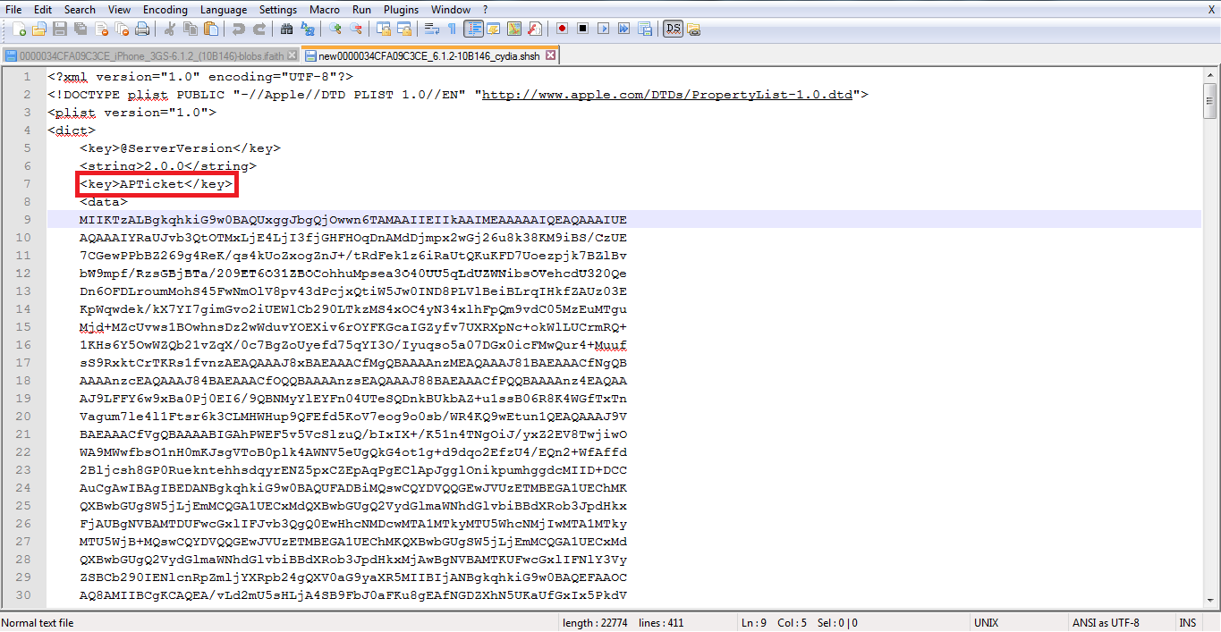

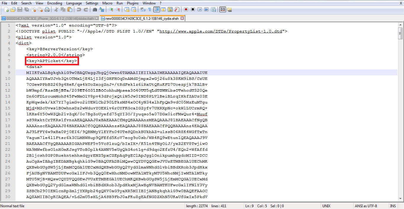

there will be a part in your blob shown as in "Step 1.png" in the attachments
there will be a chunk of data under there after the "<data>" line copy all that data up to </data> and paste that data in your broken 6.x blob under <data>
of <key>APTicket</key> (make sure u delete all that apticket data from your broken blob.)

Now as i have seen in most of these blobs, the apticket is messed up. so i just removed the messed up apticket part from the blob and replaced it with a fresh one from my working blobs (i used my 4.1 apticket)
to do this, open your working blob using notepad++ (it's easy)..
