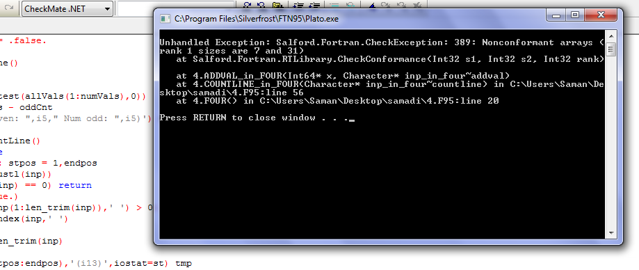

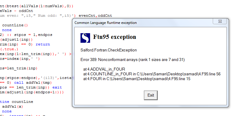

So
but this happens:
first 1
and after exiting 2

I don't know what compiler/runtime you're using (certainly not running on a Mac...). I think the issue has to do with resizing of the allocatable arrays? Or doing assignment from arrays with mismatched dimensions? It might help to add slicing in the addVal copies to/from the temp array. For reference, this all works in g95.

edit:
change
allVals=tmpStore
to:
allVals(1:size(tmpStore))=tmpStore
or even:
allVals(1:size(tmpStore))=tmpStore(1:size(tmpStore))
I think your runtime will be happier. The 7 and 31 threw me off, but it's really the first resize from 8 to 32 elements.
