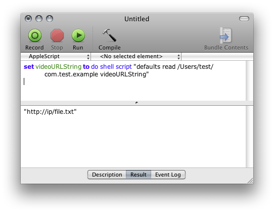

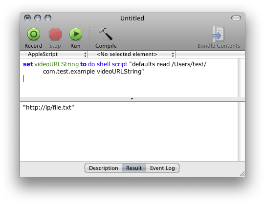

I tried code as below, but I got error, what can I do?
Code:
defaults read ~/Downloads.plist "showName"
The error message is as below:
Preference plist for {~/Downloads.plist : kCFPreferencesCurrentUser : kCFPreferencesAnyHost} was not a dictionary.
2012-08-26 00:36:42.168 defaults[8969:707]
The domain/default pair of (~Downloads.plist, showName) does not exist

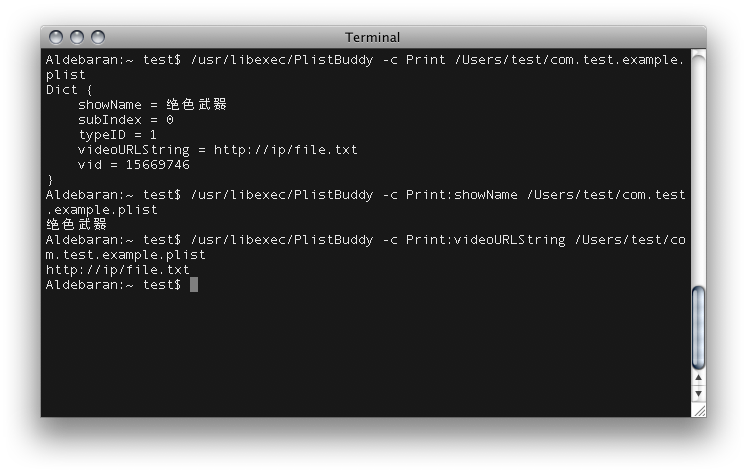

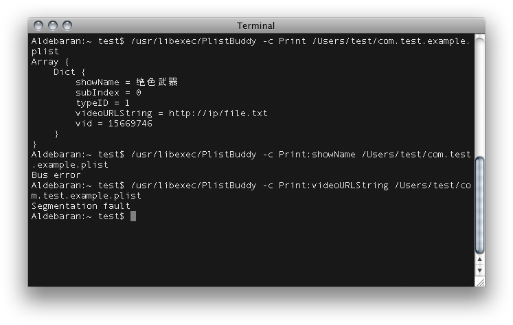

I got the same error when using your plist. Perhaps it has a syntax error. When using PlistBuddy like chown33 said I get this :
@chown33
Thanks for the PlistBuddy tip.

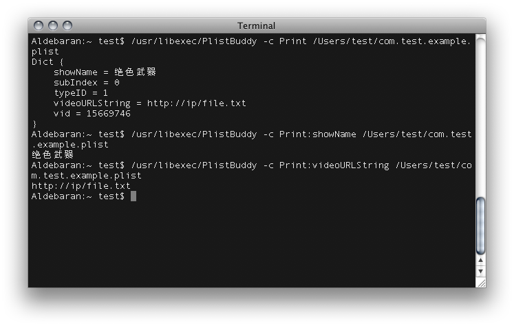

Edit after changing the plist to :
Code:
<?xml version="1.0" encoding="UTF-8"?>
<!DOCTYPE plist PUBLIC "-//Apple//DTD PLIST 1.0//EN" "http://www.apple.com/DTDs/PropertyList-1.0.dtd">
<plist version="1.0">
<dict>
<key>showName</key>
<string>绝色武器</string>
<key>subIndex</key>
<string>0</string>
<key>typeID</key>
<string>1</string>
<key>vid</key>
<string>15669746</string>
<key>videoURLString</key>
<string>http://ip/file.txt</string>
</dict>
</plist>

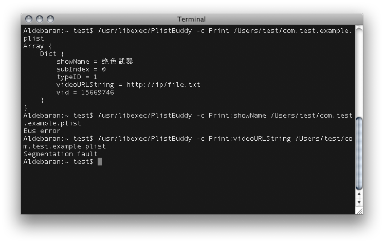

The result is the second tumbnail.
@chown33
Code:
<dict>
<key>showName</key>
<key>subIndex</key>
<string>0</string>
<key>typeID</key>
<string>1</string>
<key>vid</key>
</dict>
</plist>
You can't remove Array tag, that is what I have to parse element.
