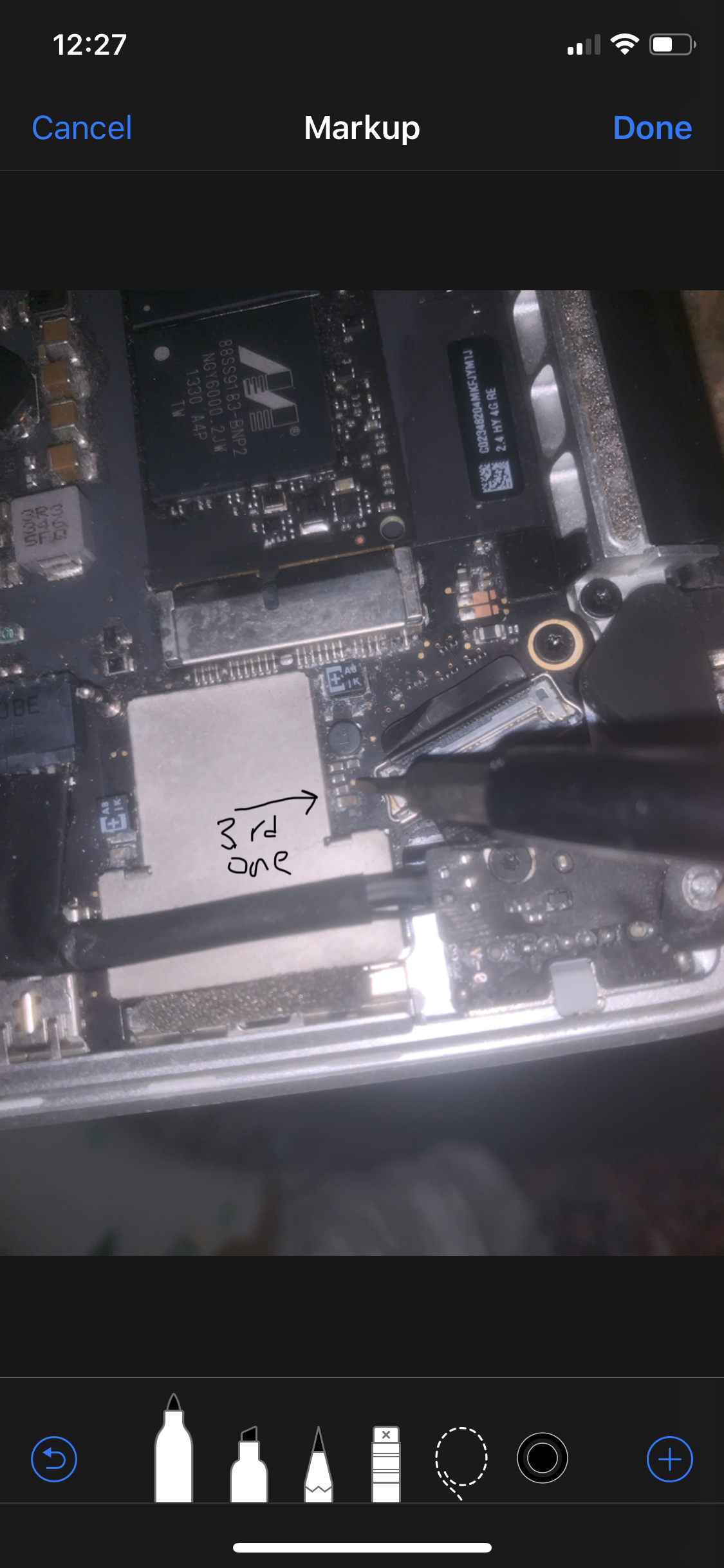

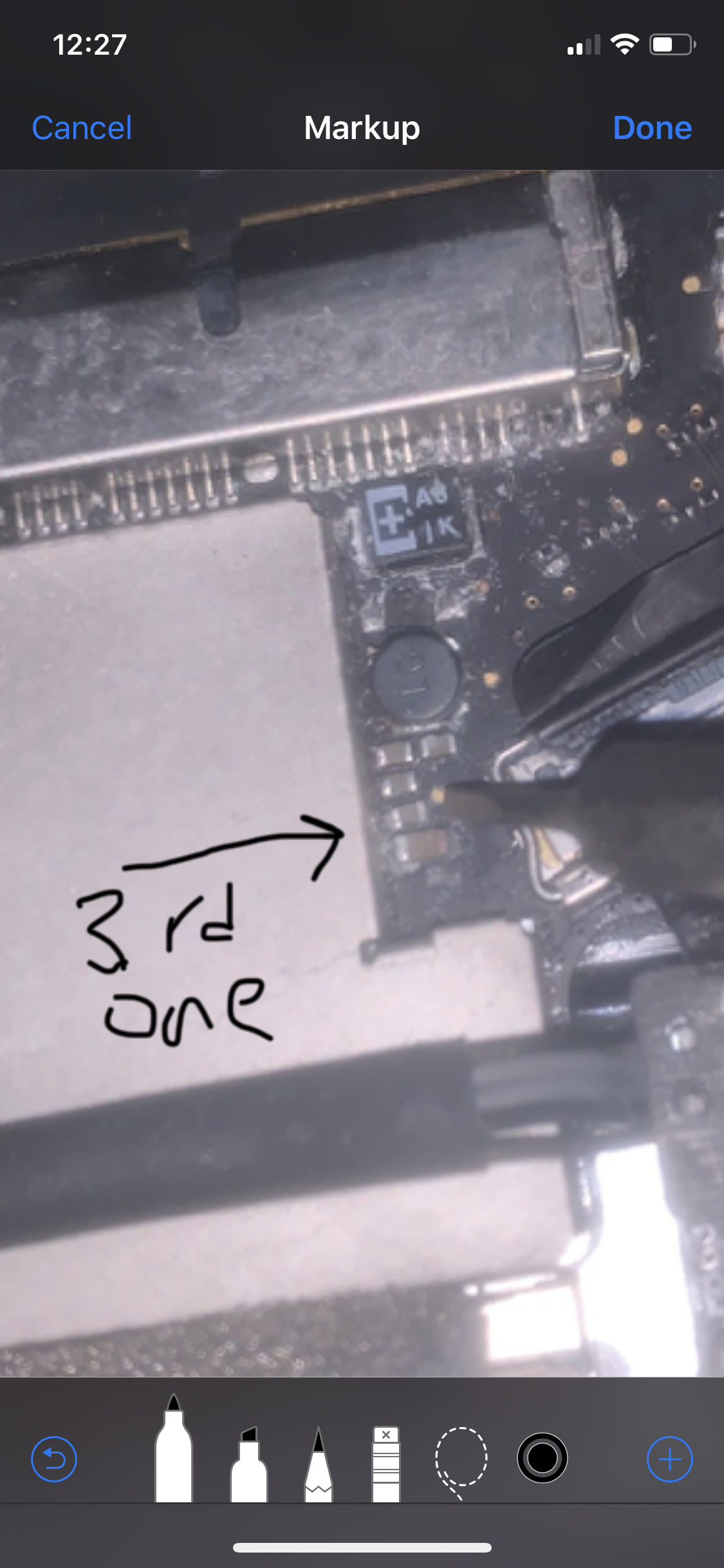

Some of milk leaked in a bag where my MacBook Pro was in its case. The milk went inside and I opened it up to clean it up. It had mainly dried at this point and I did a decent job. Except the last 30 seconds I had accidentally detached a tiny circuit/chip(?). I don’t know anything about logic boards or fixing computers. (Please save any comments on why I shouldn’t have done this.)
Is this an easy fix? How much can I expect this to cost at the Apple store vs an independent store (I live in SoCal).
Also, it didn’t turn on and there was a file with a question mark on it when I initially opened up my laptop. After trying a bunch of things, it made some noises and intermittent fan noises when I pushed Left shift, control, option and power at the same time, and then let go. And then power on again. Besides the noises and fan, nothing else and it stopped again.
Any help on if this is an easy fix and if my files are salvageable or not would be helpful. I don’t want to be overcharged when taking it in. Please and thank you!

It's a surface-mounted capacitor or resistor. In order to re-attached it, you'll need to find a repair shop that does board-level repairs.
The start-up behaviour indicates to me that there may be problems elsewhere on the board. Again, it's best to take it to a tech that can test the board before making repairs as it may be cheaper to get a replacement board.

Honestly, I would buy a new laptop. If any other components are damaged you will likely not find out until afterwards. You could try and get an external enclosure to attach the SSD or HD to and extract files providing the disk works.
So I turned on the laptop today and it works perfectly fine. I didn’t keep it on very long (30 seconds) in case something happens. I’m wondering what those chips are for and if the laptop can do without it. I’m sure they all have a purpose (otherwise, why would they be there?). I have an appointment with Apple today just so I can see what they recommend and before I got it to work, but considering if I should backup all my files before taking it in. If anyone has insight on this, please let me know!
Less than a new logic board. Tell us when you find out.
At the Apple store, I was quoted a flat fee of $750.
I took it to an authorized Apple repair store. He said it can’t be done by component parts because they have to do it the Apple way. He said the $750 is a steal as I would essentially be getting a new laptop.
In the end, I decided to extract my data and sell it for parts.
