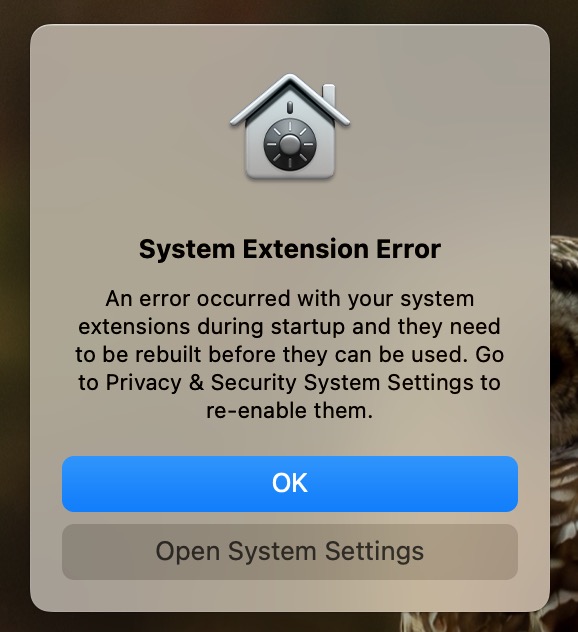

Lately, on bootup, I've been getting this alert after I first log in:
Well, ok.
I go to System Settings as advised, and...
... can't find any option that mentions "rebuild" or "re-enable"
I looked on the net for possible terminal commands that can do this, found what looked like one (or two), tried them, and...
... still get the alert. Probably didn't have the right command.
What should I try next?

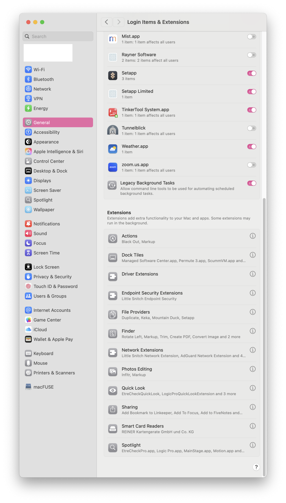

Go to
General
Login Items & Extensions
And scroll down if you have many login items. Maybe you'll find it there.

I went back into the System settings extensions area.
Started going through the items, eventually a dialog popped up about resetting/re-authorizing an extension (or something along that line, not sure).
A password authorization dialog came up, entered password.
It said (after I entered password) do you want to restart?
So... restarted, and -- for now -- no more alert msg.
Wasn't keeping notes, so not exactly sure -where- it was.
Will have to wait and see how repeated reboots go...
