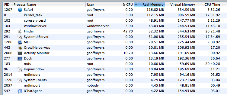

Hi, does anyone know how to REDUCE the amount of memory kernel_task is using? From my understanding, kernel_task consists of all the kernel extensions for the core system of Mac OS X. Is it possible to see, specifically, which kernel extensions are using up the most resources? Thanks! 🙂
What is your current kernel_task memory usage? Mine is ~85MB.
Kernel_task can often use more memory than Safari, and also more CPU.

Anyway, what is your machine? How much RAM have you got? When was the last time you rebooted? It also looks like you have done system modifications-if its _just_ icons then fine, but if you have haxies installed (like ClearDock, ShapeShifter, etc) I would remove them.
I run OS X Server on a Mac Pro and my kernel_task regularly uses well over 1GB RAM after a few days uptime... so if I were you I'd consider yourself quite well off 🙂

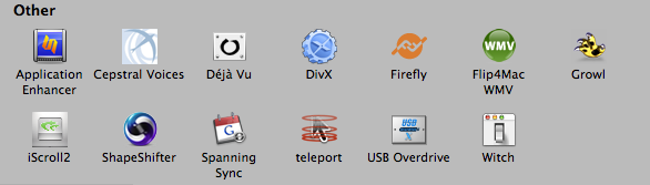

I have ShapeShifter installed, but not active. I've been using UNO now for awhile and I love it. I have quite a few add-on System Preference Panes, but many of them aren't active/enabled. I know that DivX, Flip4Mac, Growl, iScroll 2, and USB Overdrive are enabled.
OK, get rid of Application Enhancer (and associated haxies), ShapeShifter, Cepstral Voices (what is that?) and anything that isn't active. Check your kernel extensions folder to see what is loaded, and it would also be worth checking your startup items.
