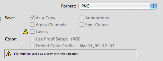

File is in Png format.
Really??? PNG does not preserve layers and is not a format for print (does not support embedded profiles or CMYK).
