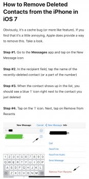

Is this what you're talking about? I know it says iOS 7 but I think it's still correct

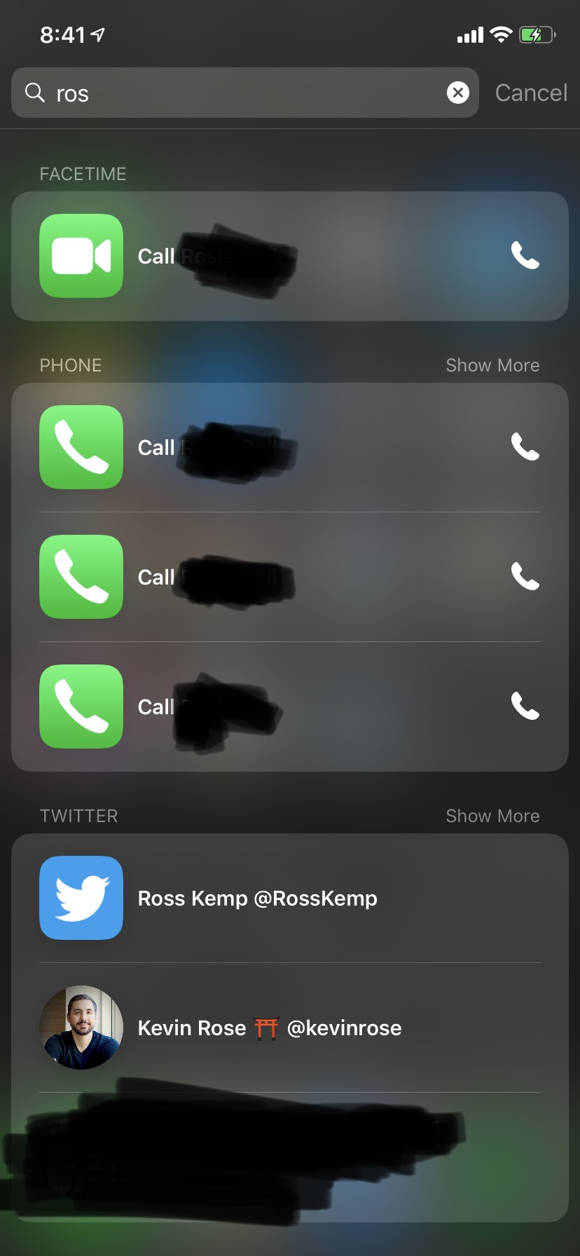

Ah, no not this - I know how to remove this.
So, let's call this contact 'David Jones'. I delete his contact, and then search my phone for 'David Jones' - and I see a 'Call David Jones' in the Facetime section, and Call 'David Jones' in the 'Phone' Section too. The contact just will not disappear. Here is a screenshot.
(The contact is NOT in my phone).
Hmm, just found that this 'contact' is being found by: Siri Found in incallservice
Whatever this is?

Thanks, man - tried that and this contact is still here unfortunately :/
This is rather weird.
I suggest resetting the device, and trying again.
Also, do you have an iPad or iMac? If so, same issue on those, too?
Try this;
Messages > New Message
Start typing the number of the contact. Press the "i" next to it. Then "remove from recents".
Try this;
That is the first thing I tried. I can confirm that this user was not anywhere on the phone. Apple support tried lots of steps, and in the end, asked me to backup and do a factory reset. Did that and that user is now gone. Ahhh, at last. lol.

..Bumping an old topic here..
This problem has happened again, but with a few other contacts, not related to the original in the thread.
I have just discovered from @russell_314's recommendation that disabling Siri search for phone, messages, and facetime actually does remove these unwanted contacts, but as soon as you enable them again, boom, they're still there.
So.... I am assuming that these contacts are stored somewhere in my iCloud drive? Or are they stored locally? How would one remove these?
Quite shocked that it's not really that straight forward, to be honest. Right now, I have all these options disabled (Siri search: phone messages and facetime) until I have a fix for this.
