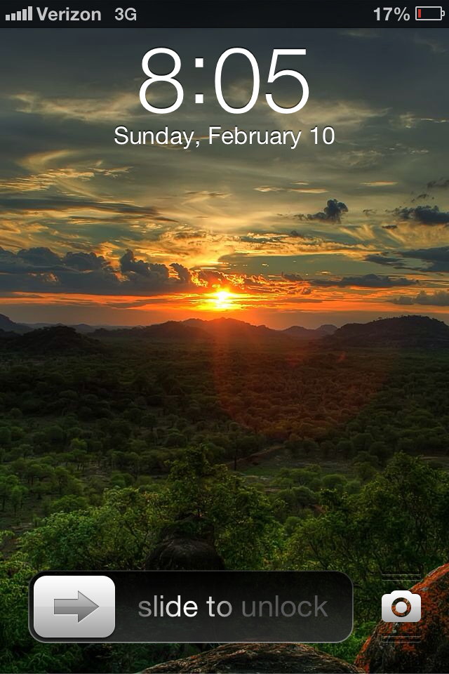

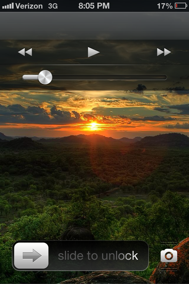

I successfully removed the black background around "swipe to unlock" and the clock. But, when I press the home button twice to bring up music controls, I get the black box again. Any ideas on how to remove it WITHOUT winterboard or springtomize? I SSH'd these changes, and would like to keep doing it that way.

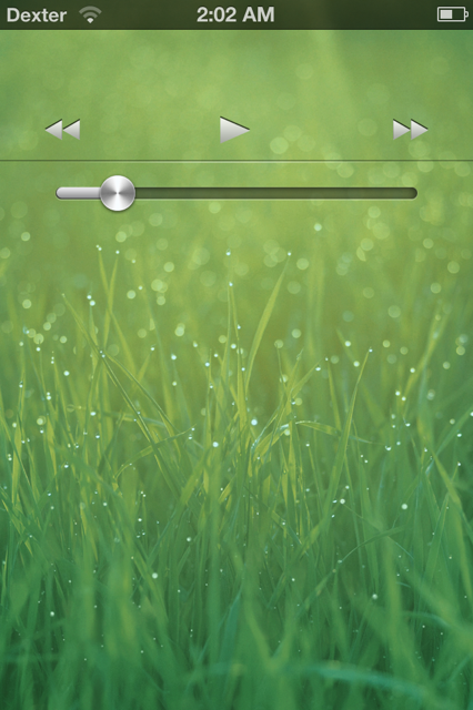

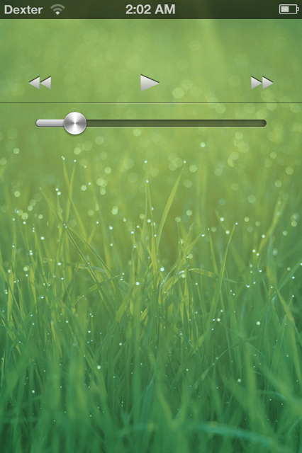

I was wanting to do this same thing, and after some poking around, I found that if you remove/rename the file "SBLockScreenControlsLCD@2x.png" in /system/library/coreservices/springboard.app, it will remove the black box. (see screenshot)
My next goal is to remove the grey line that's left, but I'm guessing that's in the SharedArtwork file somewhere, since that's where the grey line from the unlock bar was.

Careful with that that also disables the music buttons when you double press home button at lockscreen...

I got mine working. I think the custom slider on Springtomize was screwing it up. I have the entire slider hidden anyway, so I turned that off and now it will hide the background like gobbldygook said. But as you said, nwmtnbiker, none of the music control buttons do anything now.

Using a transparent image instead of renaming the image works better, and keeps stacked notifications from being in the music button area, as I found out after my text notifications piled up into my clock/music player. The music controls also work with a transparent bar. (Mine is attached, though I'm not sure if it's possible to download it from the post?)

This is the correct way. You need to drop this file in the com.apple.springboard in your lockscreen theme. If you just remove the file, the LS Music controls will not work anymore.
