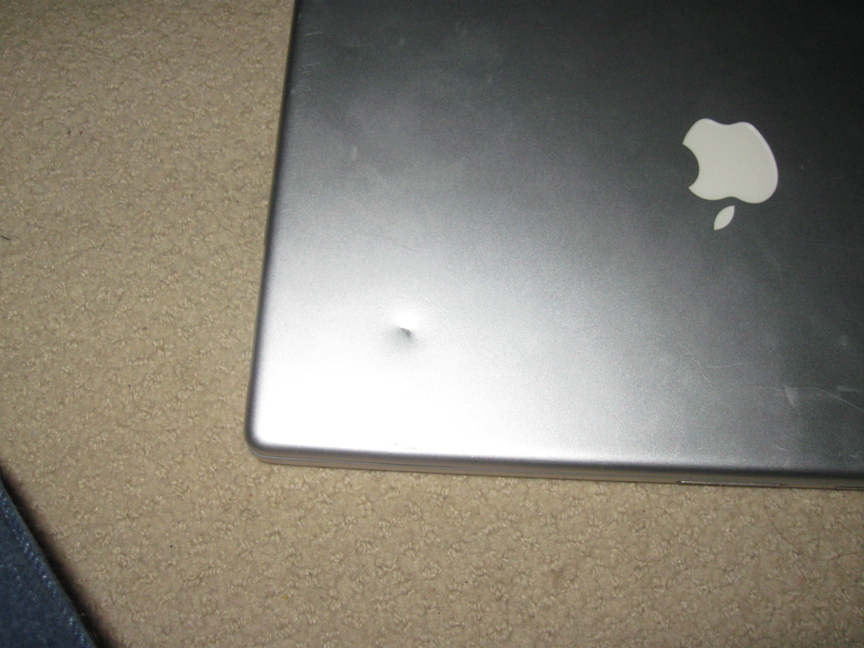

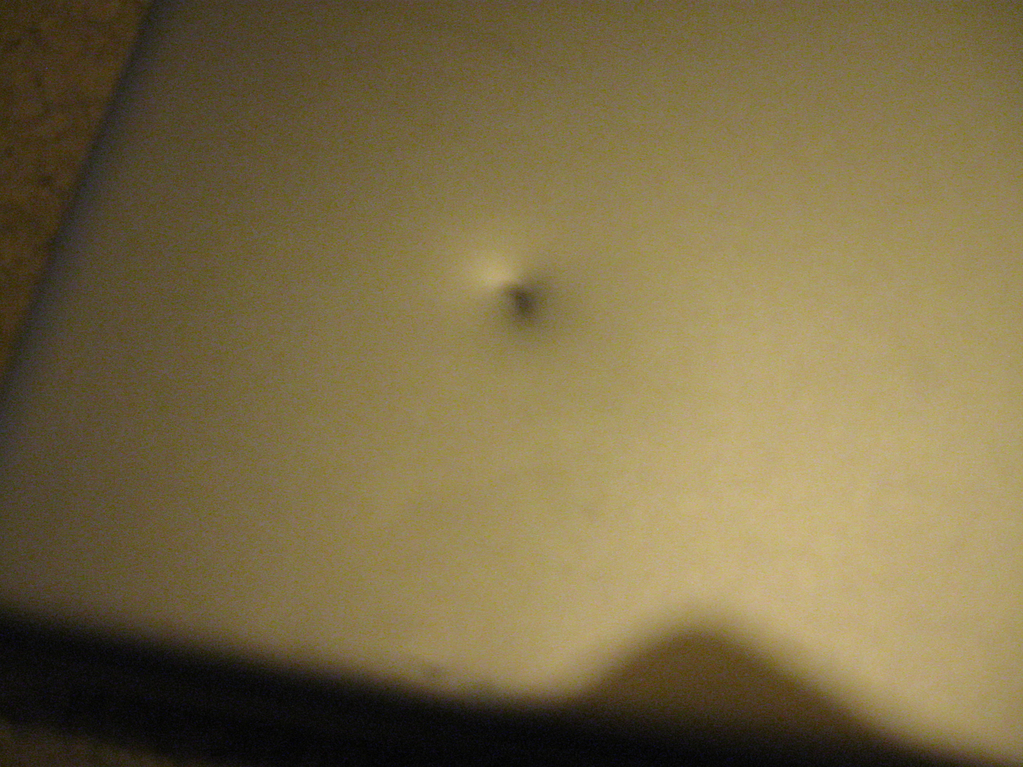

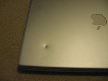

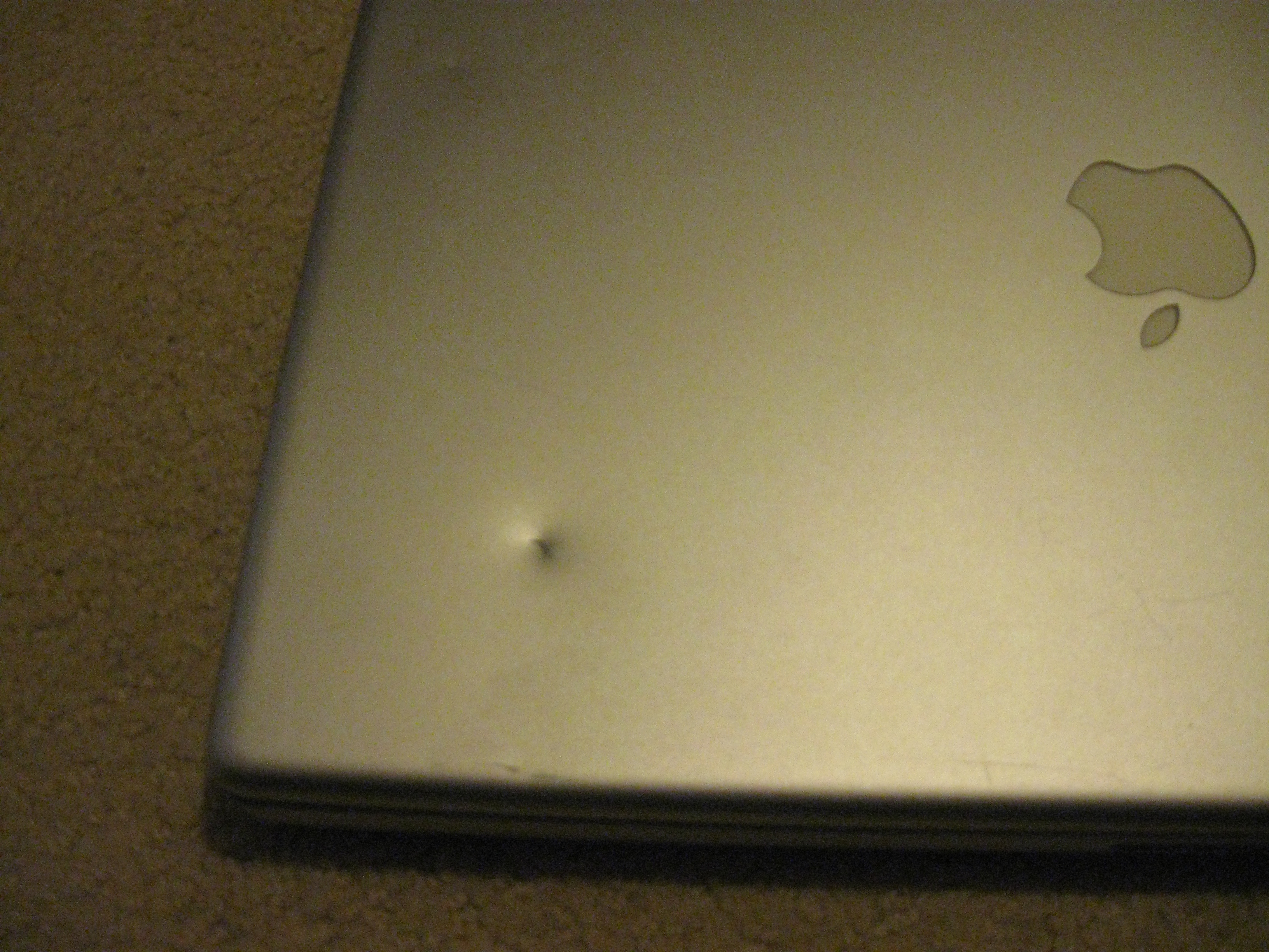

I have a dent in my PBG4's lid. I've attached a few pictures to the post. Normally I wouldn't care, but the dent presses against the screen, so when it moves at all I see a wave/ripple pattern in the top left corner where the dent is. How can I remove this?

You need to remove the lid and bang it flat from the inside. Then reinstall it.
I would use a wooden block + a hammer would do the job. Obviously only hit the wood with the hammer.

Suction cups over shallower and wider dents on less malleable and proportionally thinner sheeting. If you want to be flash, you can also use a flame but that seems more for social media clicks.
The problem with aluminium is its softness - it stretches. Even if you got that very deep ding out, the area around it would probably never sit quite flat because of the deformed metal. You often see the same thing around the lid button or on top of the optical slot. That part of the casing is very thin and gets easily stretched on opening the casing for the first time because of the damn clips on the top case that are so hard to release. They always bulge out or in afterwards and trying to squash that distortion back flat is a bit like playing whack-a-mole.
