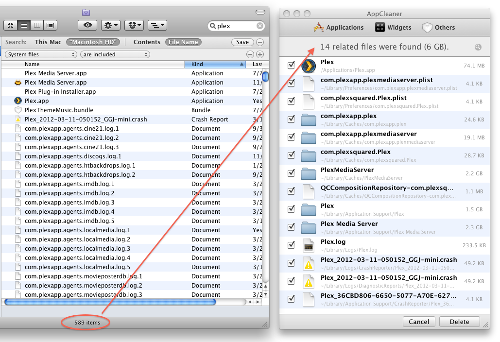

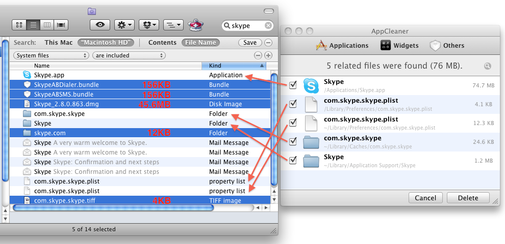

I just downloaded and tested AppCleaner again (version 2.0.5, installed on Snow Leopard 10.6.8). I tested with two apps to be uninstalled. In the first case, I used Skype. I disregarded email messages, which the manual search revealed, and show file sizes in red for the things AppCleaner missed.
In the 2nd case I tested with Plex. The results speak for themselves.

Yes, I checked for that, and the app removal apps definitely missed those files, as they do quite frequently.
In most cases, app removal software such as AppCleaner and AppZapper doesn't do a thorough job of deleting files/folders related to deleted apps. For more information, read this.
The most effective method for complete app removal is manual deletion:
