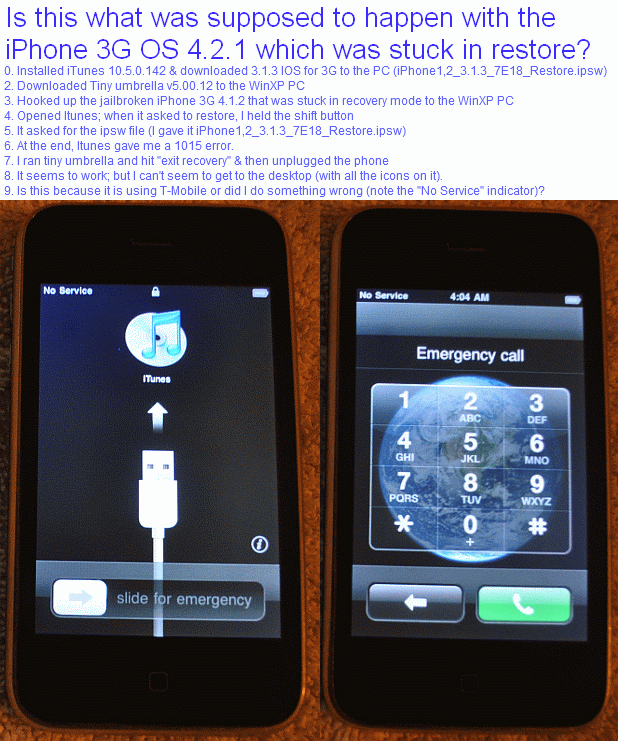

Unfortunately, to move forward, I was forced to additionally ask elsewhere:
- What are my options? (Jailbroken iPhone 3G iOS 4.2.1 stuck in iTunes recovery mode)
I'm not sure what I'm doing though ...
At the moment, I'm exploring the suggested Tiny Umbrella (TU) solutions, and if that doesn't work, I'll update back to the un-jailbroken iOS 4.2.1 on iTunes and then I'll try Sn0wbreeze to jailbreak, and then to install Ultrasn0w to unlock (none of which have I done so I'm breaking new ground for me).
Some on that very helpful forum are also advising me to skip the SHSH blobs for 3.1.3 on the iPhone 3G & to simply just download 3.1.3 for the 3G on iClarified's ipsw site and shift+restore in iTunes.
The problem, of course, is that I don't really understand these 'suggestions' so I have to research them as they come in ... but the GREAT advantage of suggestions is that it limits the research from infinity to something manageable!

anytime you do a restore you will lose your jailbreak no questions asked... but since your on a 3g its really no big deal. dont use snowbreeze if they told you to do that I would not return to that forum. go to helpmejailbreak.com and follow the instructions on jailbreaking with the firmware you are using. it will have snowbreeze as one of the solutions but dont use it. also tinyumbrella will help you kick the device out of recovery in most situations. its a very usefull tool. depending on what your firmware and baseband were prior to your issue will determine what you need to do next. try to kick out of recovery with tinyumbrella first then report what your firmware and baseband are. if that wont work go ahead and restore then report what you have. you may need to install the iPad baseband so you can unlock it again to use on T-mobile. you are looking for 4.26.08, 5.11.07, 5.12.01, 5.13.04, and 6.15.00
What is the next step after getting out of recovery mode by downgrading the OS?

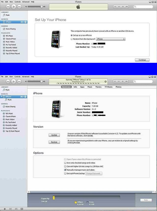

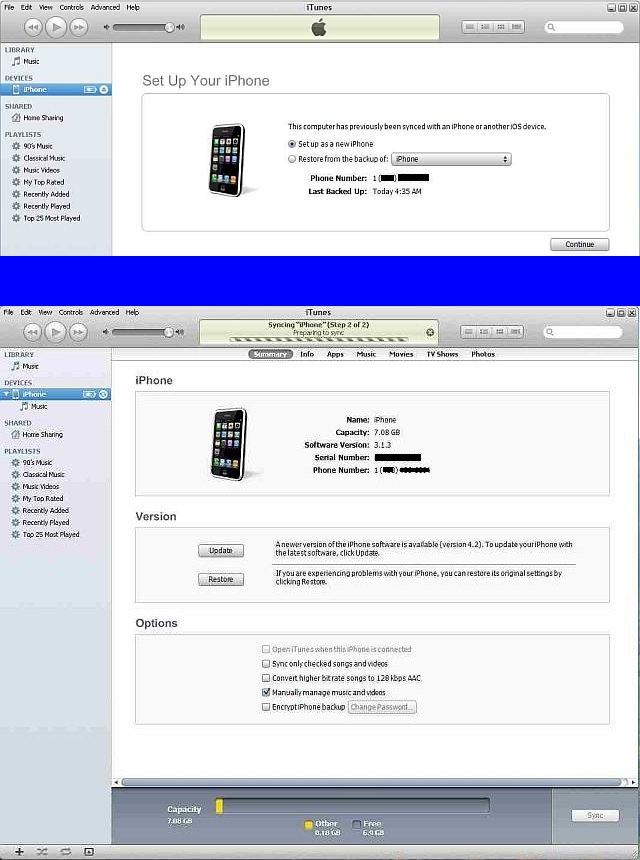

So, I followed your advice as shown below to downgrade the jailbroken iPhone from iOS 4.2.1 to iOS 3.1.3 in 'restore mode' (nothing was done in DFU mode yet).
Is my next step to somehow 'activate' (even though I'm on T-Mobile) or is it to jump right to a jailbreak (using redsn0w 0.9.4 or Sn0wbreeze 3.1.3 -V1.3) and then to unlock (using blacksn0w or ultrasn0w)?
You have restore your phone to 3.1.3 (factory setting). So, there are 2 ways for you go get pass this screen.
1. Use an AT&T sim card, put it into your phone, hook it up with Itunes and it will bring your phone to home screen. Inactive/use AT&T sim card works. It does not need to be active.
2. Hactivate it with Redsn0w.
If order for your T-Mobile to work again, you need to unlock it with Ultrasn0w. Check the baseband on your phone first.

Thanks. All this advice is great, but each suggestion entails hours of looking up the answers to find out the exact sequence of steps for my situation.
To clarify, Tiny Umbrella, on WinXP, reports the iPhone 3G I had bought initially jailbroken on iOS 4.2.1 which locked in restore mode, is now:
  • Device Model = MB702LL/A - iPhone3G
  • Installed Firmware Version = 3.1.3
  • Installed Baseband Version = 06.15.00-5.9_M3S2

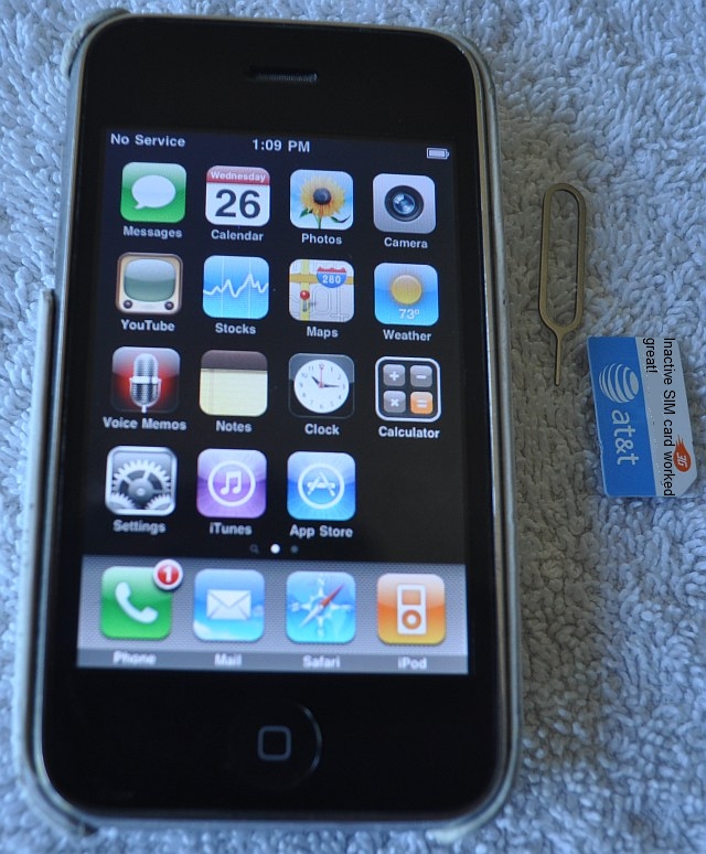

  1. This morning, I downgraded iOS 4.2.1 to iOS 3.1.3 using iTunes, iClarify, & Tiny Umbrella (in order to get out of iTunes restore mode)

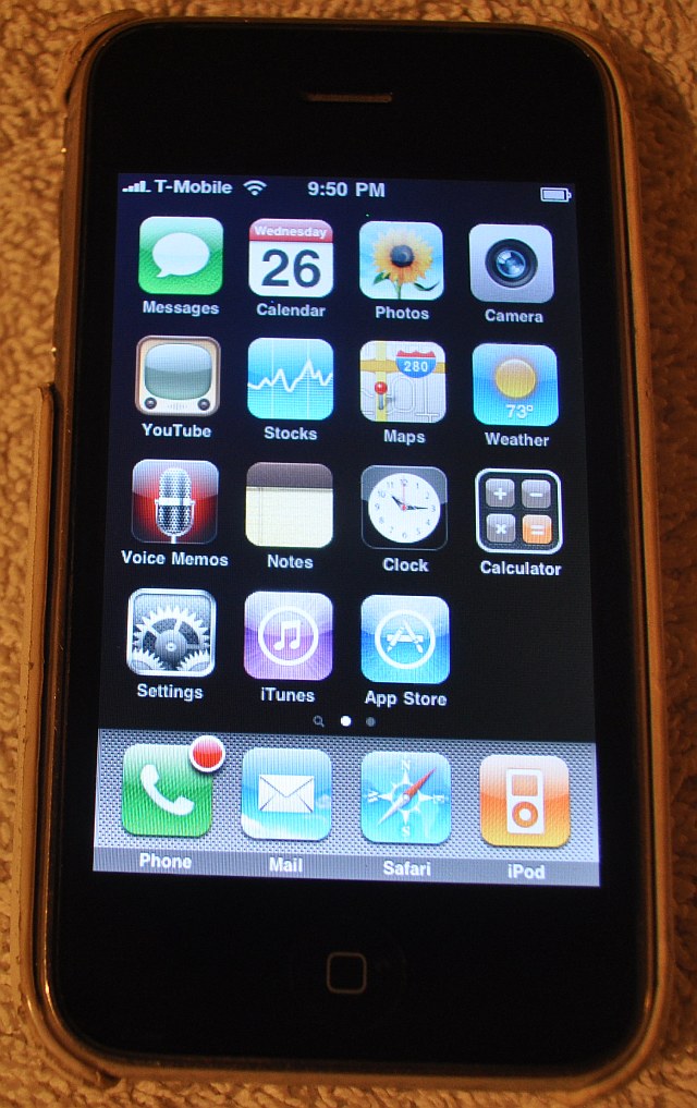

  2. But then, the iPhone 3G had no sea-of-icons home screen, and could only make emergency calls on T-Mobile
  3. My next step was to activate (either with an active or inactive AT&T SIM card or using Hacktivate (with Redsn0w & SAM)
    • Note: I never needed Redsn0w because a 3-month old inactive AT&T SIM card worked great!
    • That finally got me the sea-of-icons home screen! (THANKS!)

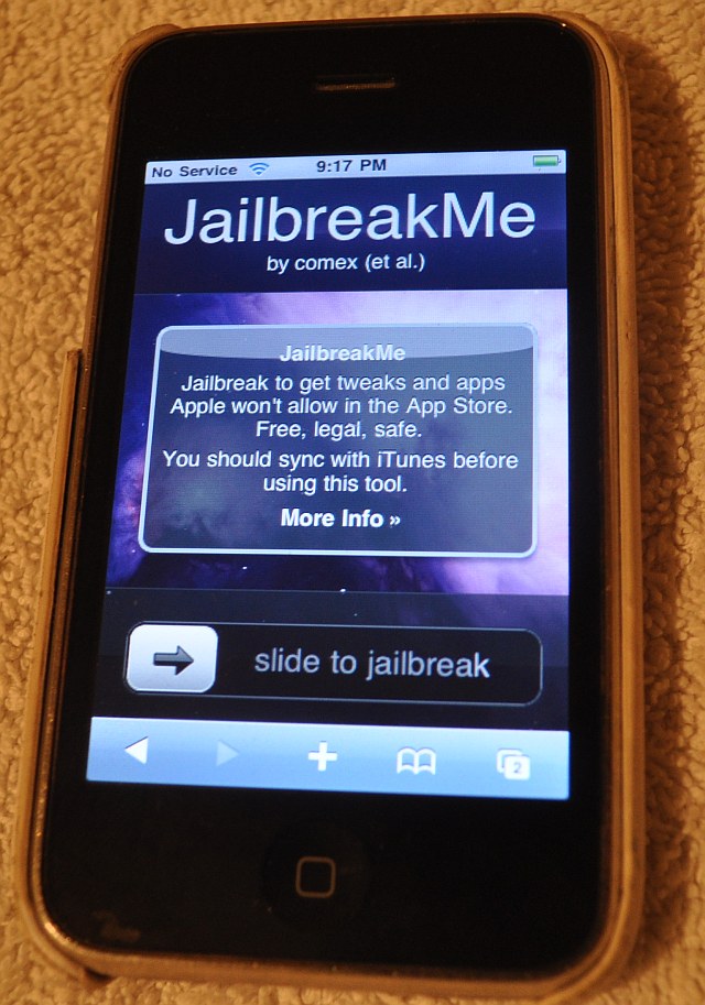

Which 3.1.3 firmware on your phone, there are lot of jailbreaking tools available to jailbreak your phone.
1. Spirit. This is very simple, all you need to do is download it, hook up your phone and hit 1 button to jailbreak.
2. Redsn0w. You know how to use it.
3. Jailbreakme.com. This is a simple tool where you don't even need to hook your phone up to your computer. Make sure your phone hook up to wifi, open Safari and type in www.jailbreakme.com and enter, it will ask you to slide to jailbreak.
Once you're done with one of the method above, Cydia icon will be added to your screen.

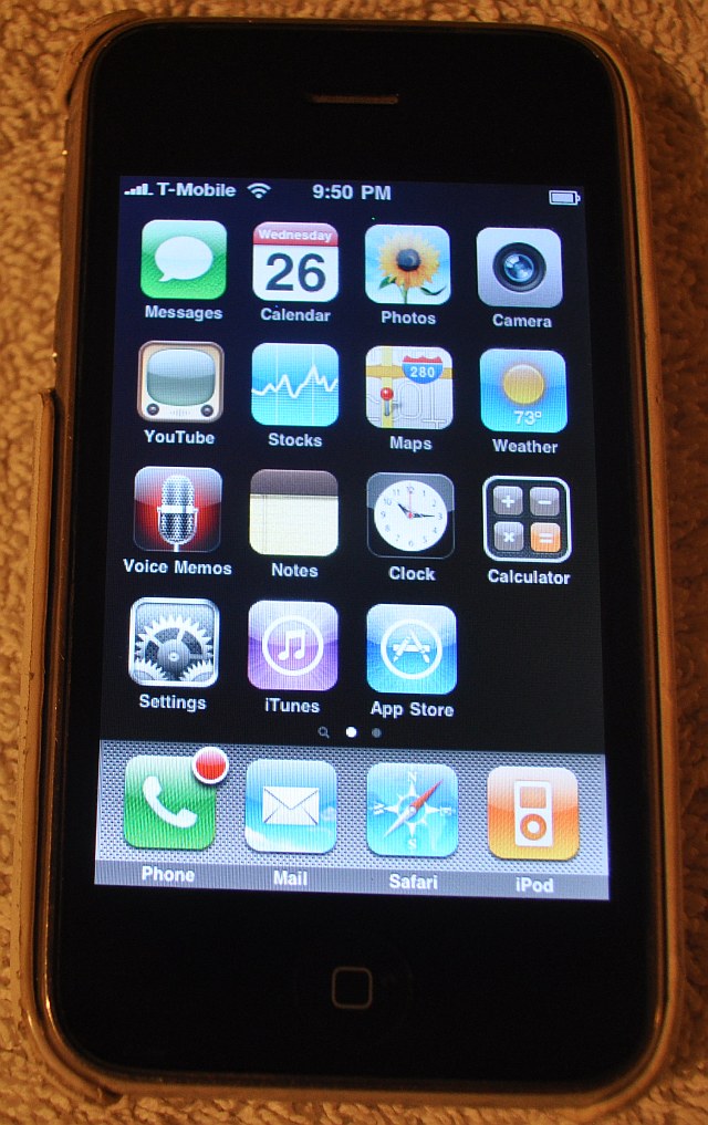

Success at last! (Thank you for your kind help!)
I'm hoping the 3.1.3 iOS will be faster & more compatible (e.g., with Cycorder) than the 4.2.1 was; however, I'm not really sure 'how' I downgraded to iOS 3.1.3 without going into DFU mode (must have been the TSS button in Tiny Umbrella); but with your advice, things moved (finally) right along! 🙂
1. With the iPhone 'activated' using a 3-month-old inactive AT&T card & with the T-Mobile SIM card in the still-locked iPhone ...
2. I set up the WiFi encryption for my home network (I don't have the T-Mobile data plan ... which is the whole reason for switching off of AT&T)

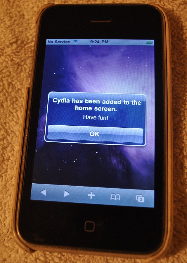

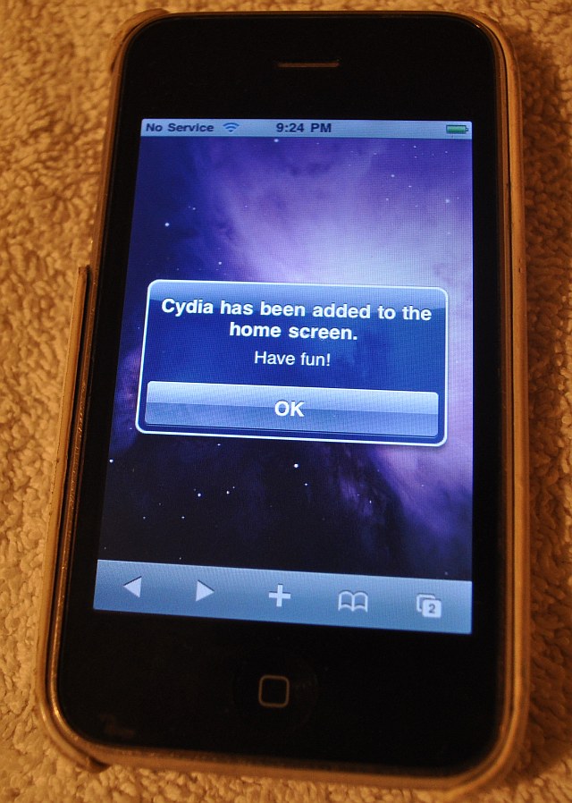

3. And then simply went to Jailbreakme.com, as you said, in Safari & moved the slider
- As you said, I eventually saw the message "Cydia has been added to the home screen" (so that solves the question of how to get Cydia on board)

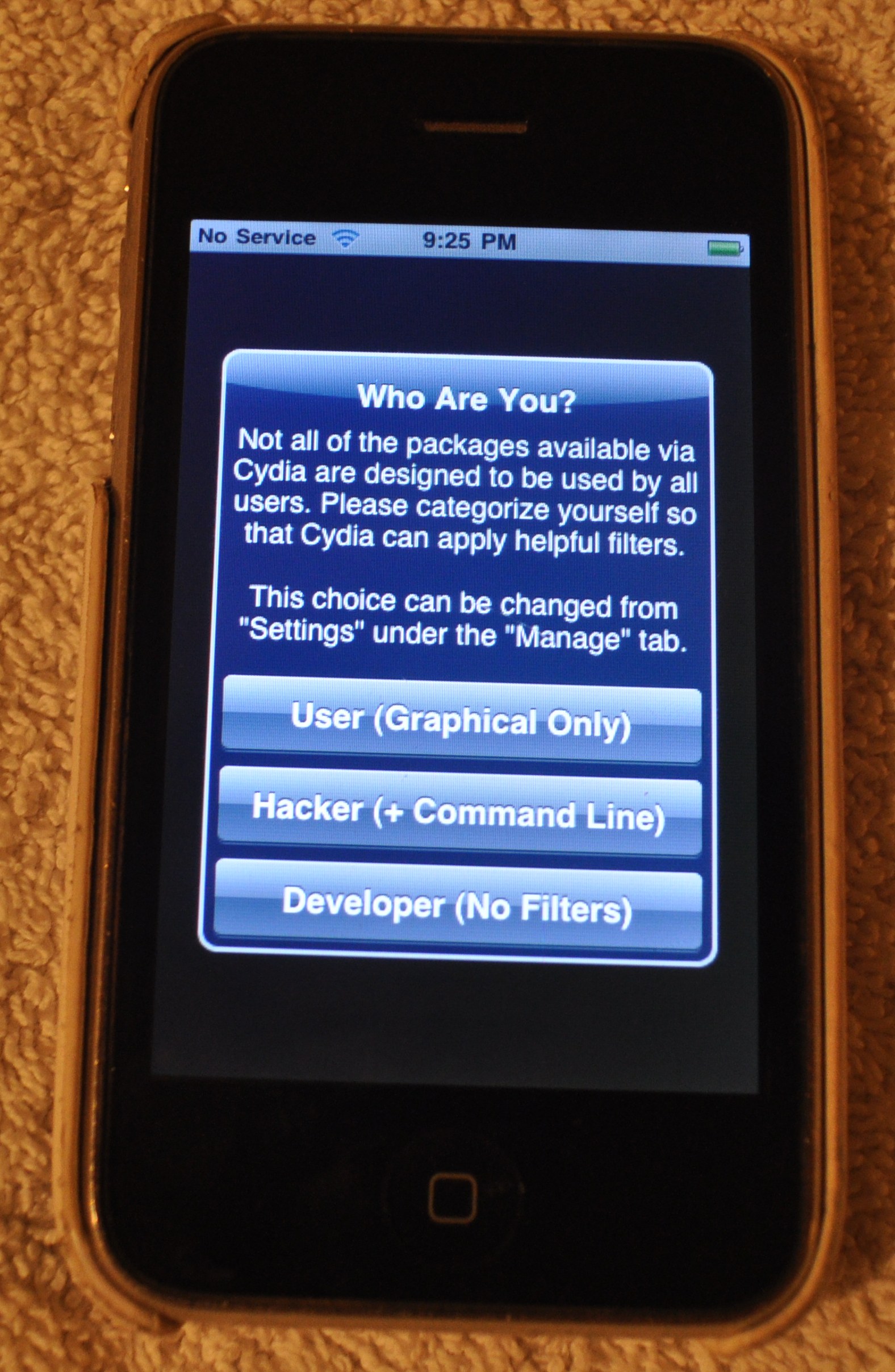

4. I started Cydia ...
- It asked "Who Are You?" (I said "Hacker" although that was being generous)
- Cydia started downloading packages & reloading data.
- Cydia requested one of 3 essential upgrades (Essential, complete, ignore).
- I let it do a complete upgrade until it asked to "Close Cydia & Restart".

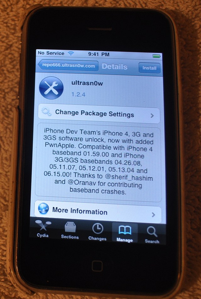

- Then I hit "repo666.ultrasn0w.com" & then "ultrasn0w" (which only then revealed itself to be version 1.2.4)
- I hit the "install" and "confirm" buttons & it installed & reloaded data.

6. I went to the home screen & pressed Settings, general, network, and changed "Enable 3G" from "ON" to "OFF".
7. I had the T-Mobile SIM card already in so I didn't have to pop it in at this point ... but ... everything was working perfectly!
Thank you very much for walking me through this (difficult for me) fix which started with a T-Mobile jailbroken/unlocked iOS 4.2.1 iPhone 3G (baseband 06.15.00) which was stuck in iTunes restore mode - and now ended with a working T-Mobile jailbroken/unlocked iOS 3.3.1 iPhone 3G (baseband stayed the same)!
To help others, here are some pictures of this set of steps you just walked me through.
- I had to hit the home button to "Reaload Springboard"
