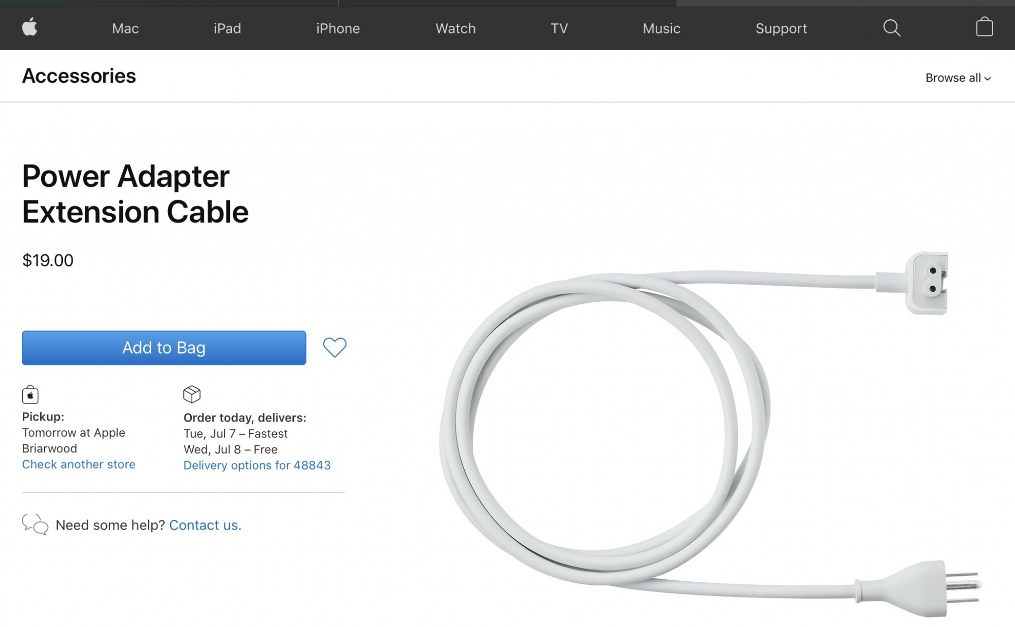

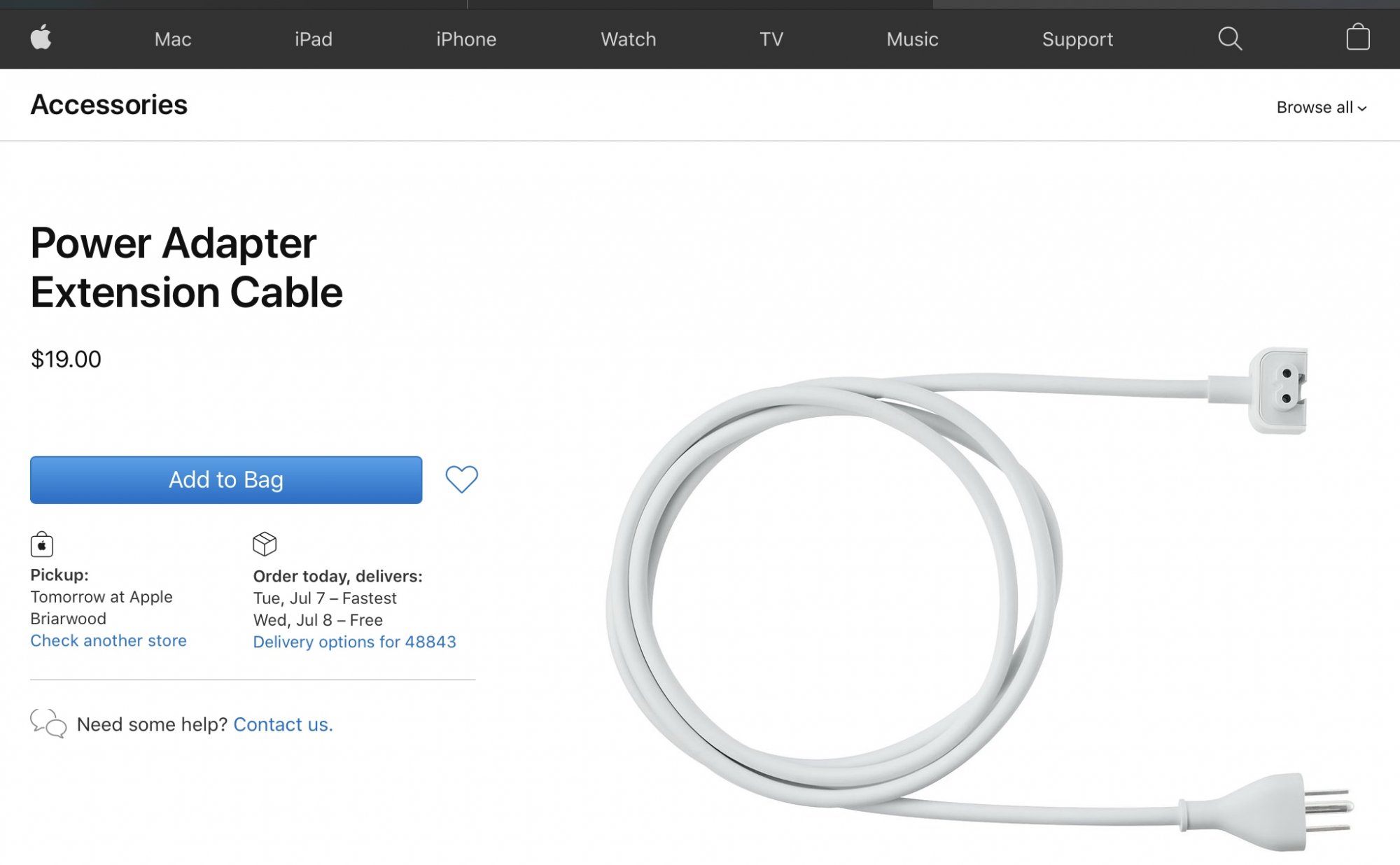

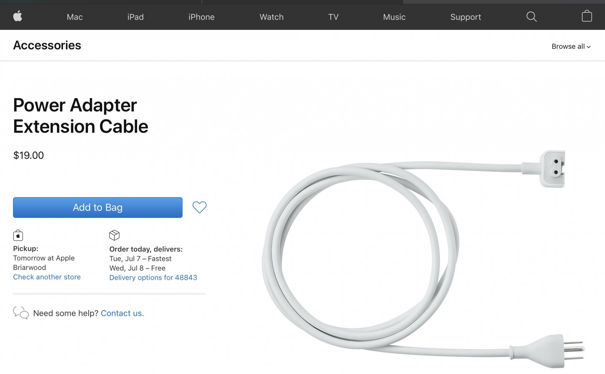

In the USA this solves the problem, maybe they sell the same thing for a UK plug?
Thanks. I'm sure I've seen something similar. Still wondering why this is only happening with an MBA and not the MBP. You would think Apple would have come up with a solution for this (that doesn't involve buying a $19 cable).

in the pic someone posted above the wall end has three pins but the other end only has two wires.

The problem is Apple's power adapter cord. The one that came with my new MB Air was 2-pronged - no ground connection. The MB power adapters up to now have always had a ground connection. The solution was simple: I replaced the plug on the new adapter (easily slides off) with one from an older adapter, and now there's no more current leakage. I can't understand why Apple ships a problematic plug with the new power adapters when they used to ship a better - grounded - cord, which is probably healthier for the Mac.
If you need a grounded connection, get the extender cable mentioned above - then you'll have a grounded connection. Far more people don't need the cable than do need the cable, so Apple quit including it some years ago. Yet it's still available for those who want/need one. Also available less expensively via third party sources.

Use the Apple extn cord with the metal ground all the way to the adapter and problem solved.
All my MacBooks from 2010 to my current M1 Air have this problem unless I use the ext cable with earth wire (this was originally supplied with my first MBP but Apple make it a separate purchase these days)
