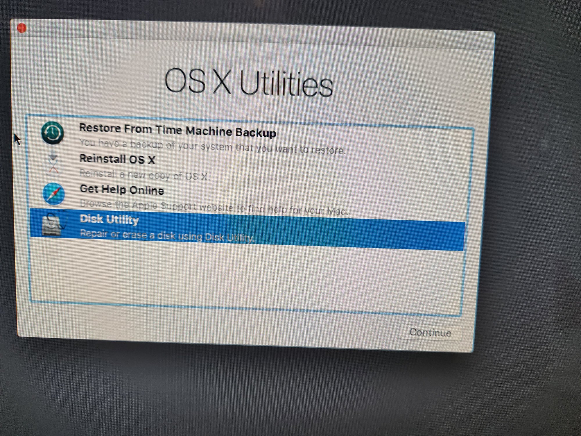

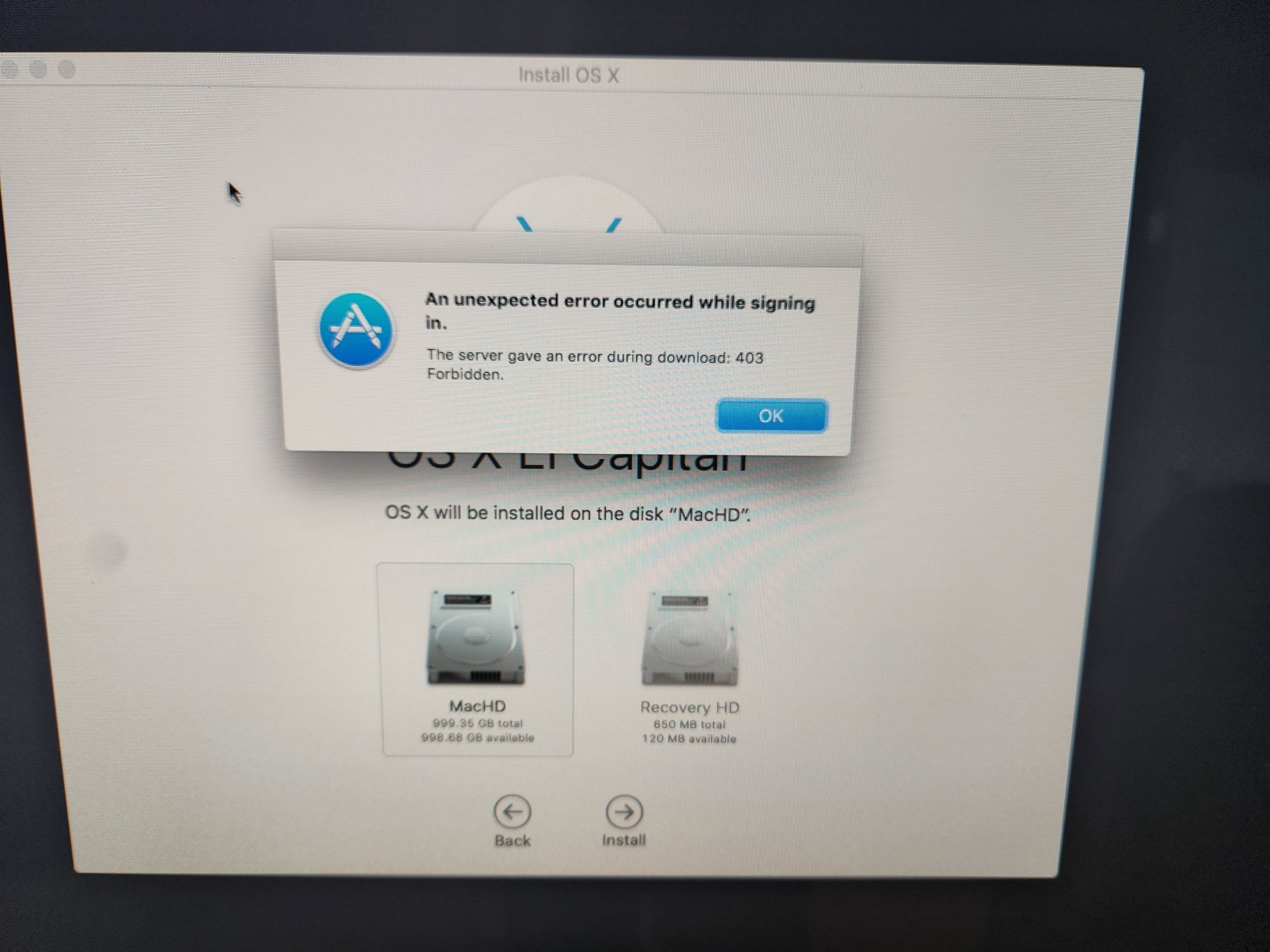

Have this old imac from 2009, now stuck at this disk utility , don't remember login already , and have made a Bootable usb from transaction, what shall I do now?

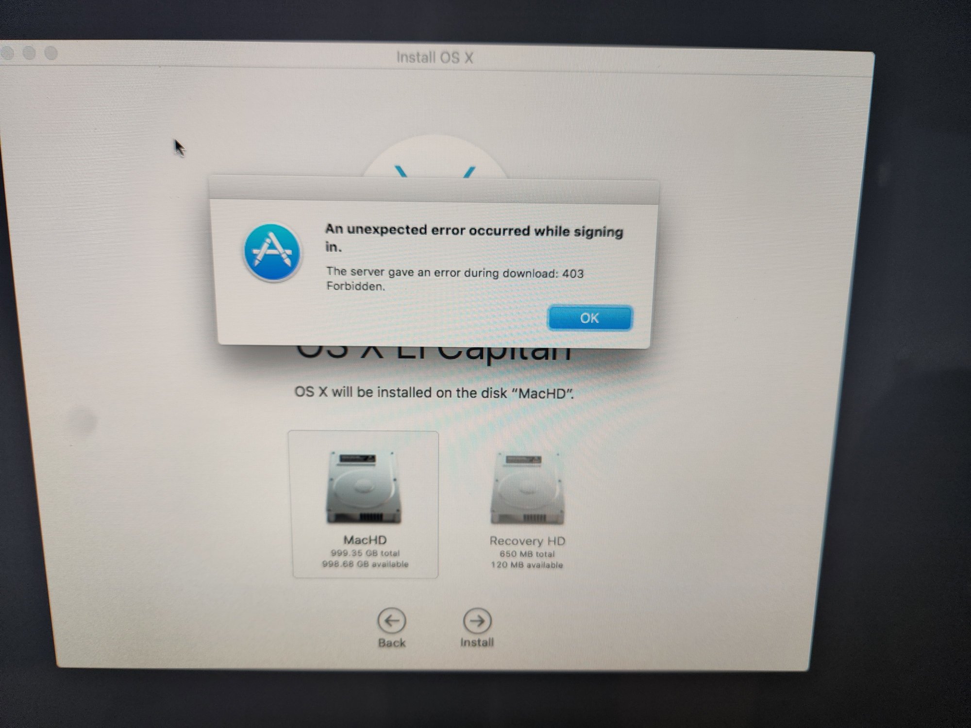

Tried select reinstall os x but said no network connection, where can I set wifi password ?
Or shall I erase the macHDD, but then what is next step ?

A google search quickly shows that it's a common error simply telling you that the server has denied you access.
I have a theory why this might be happening to you; a couple of years ago, I wanted to restore a 2010 MBP to an early, compatible macOS, and I found that apple had implemented a scheme where they would deny the online installation of macOS on models over a certain age. Setting back the clock on the mac would not work, because the clock would be reset when connected to the apple server.
So, the solution was simply:
Disconnect any internet connection. wifi or cable.
Set back the clock a few years, maybe ten, doesn't matter.
Install the macOS from a bootable usb drive - it will think it's dec 2014 and allow the installation.
This worked for me, and it's mentioned many times online, but is a bit tricky search to find it.
Thanks for help, but when I power up whole holding down option key, the Bootable usb icon was not shown up , only the hdd icon was there , does this mean my Bootable usb was not created correctly? I did it using transMac in windows , and no error, maybe a bad img fole used ?

Sounds like it. Here's Apple Support guide:
It's really just a matter of having the MacOS installer file in the Apps folder, inserting the pen drive or volume, or whatever you want to install it on, copy/paste the command in Terminal, and entering your password.
It can be a usb drive or a partition on any drive, only requirement is that it's formatted as Mac OS Extended (HFS+). If you use a partition, a size of 20-30GB should suffice.
OP wrote:
"Bootable usb was not created correctly? I did it using transMac in windows , and no error, maybe a bad img fole used ?"
The problem is that you're using TransMac. Chances of success using it (on a PC) are... well... they ain't so good. It works for some. Not for others.
Use A MAC to create the bootable USB.
If access to another Mac is impossible, you can go on ebay and buy USB installers with the OS of your choice for about $25 or so.
A 2009 Mac cannot do "internet recovery". That came later.
It can run from 10.6.1 (Snow Leopard) to 10.13.x (High Sierra).
What OS version do you want to install?
(actually, I would install ANY version of the OS that works).

yes. it's a very very old imac 2009 A1224.
it's definitely worth less than $100, i'm just reluctant to see things so nice and neat in the trash bin. so give it a try to make it reusable. for kids whatever.
i'll try to create a bootable usb from my macbook then.

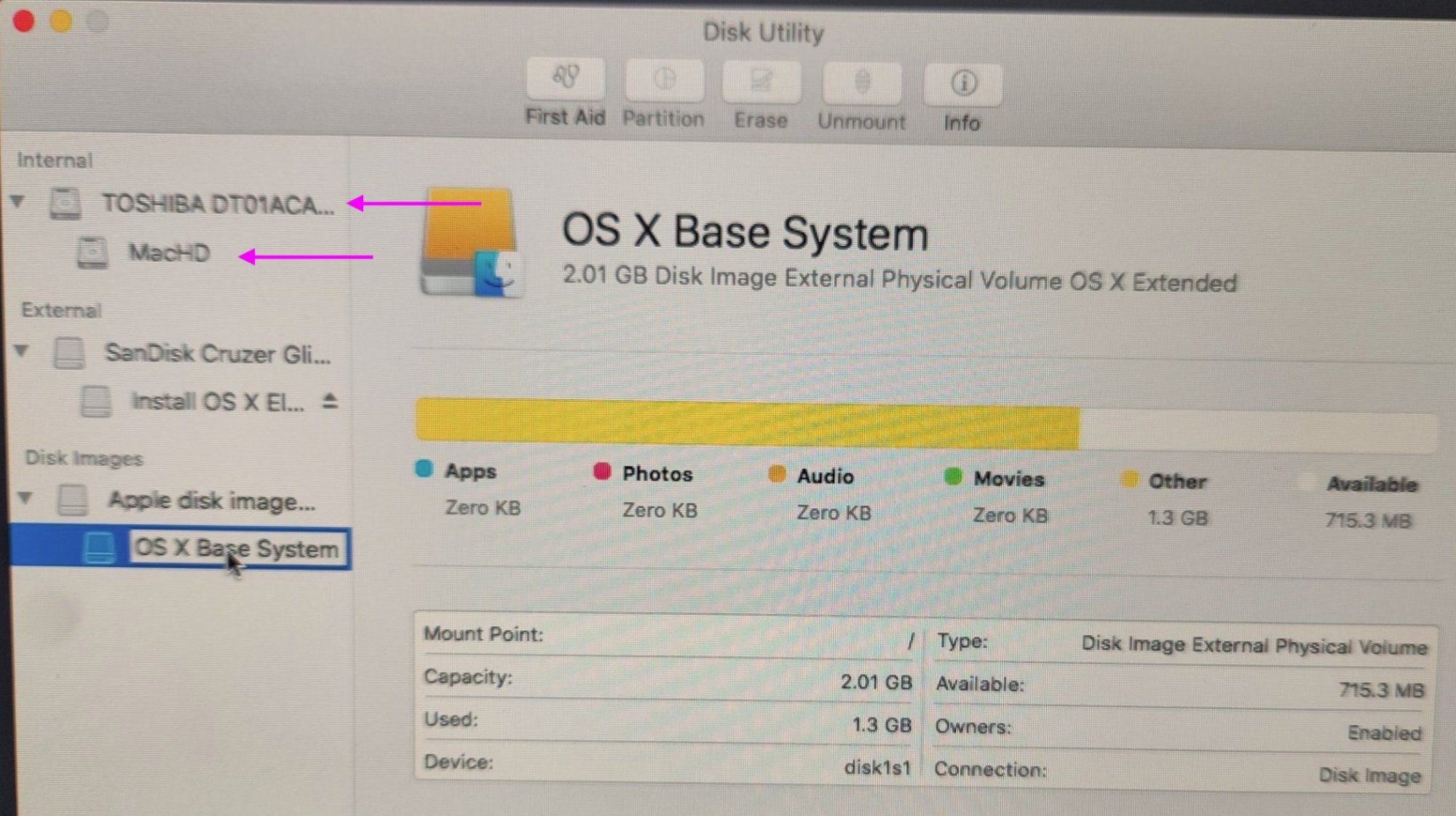

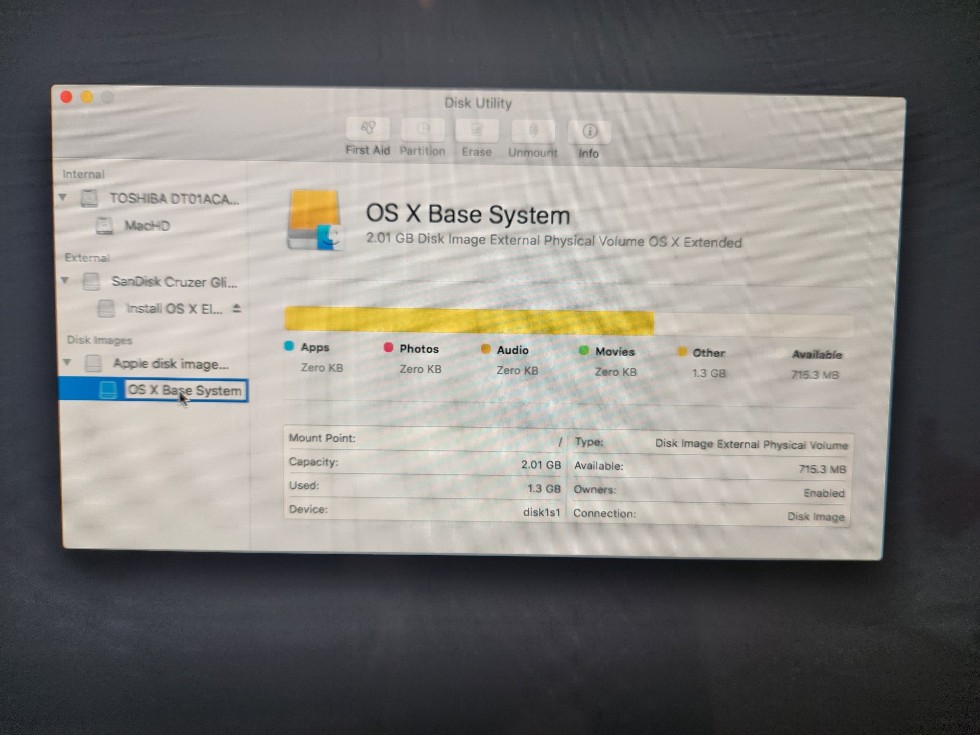

Can you boot back to the "utilities" screen you showed us above?
Go there, and open disk utility.
What happens if you click on the internal [physical] drive (Toshiba...) and then click "first aid"?
Do this first, and then...
What happens if you click on the logical drive underneath that (MacHD) and then click "first aid"?
