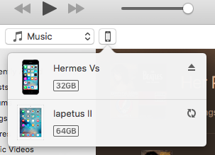

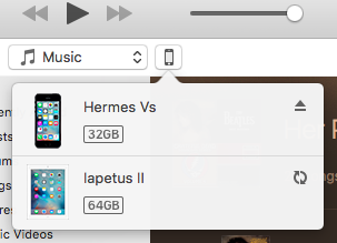

My main take away from your post is that you do not appear to be selecting any music to be copied to the iPhones. Let me see if I can help with that.
It is possible to sync via USB more than one iDevice to an iTunes library, and this is not dependent on the Apple ID. So, before you do anything make sure that each iPhone is signed into the appropriate Apple ID.

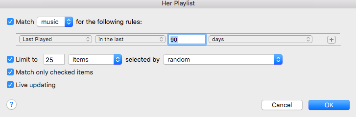

Now we’re going to work on getting some music onto the iPhones. For this demonstration I’m going to use my iPad, but the results will be the same. First we will create a Smart Playlist for your iPhone. We’ll call it “Her Playlist.”
  1. In iTunes pull down File > New > Smart Playlist. Make it look the image #1 below. What this playlist will do is collect 25 tracks that have not been played in the last 90 days. Click the OK button and name it Her Playlist (image #2).

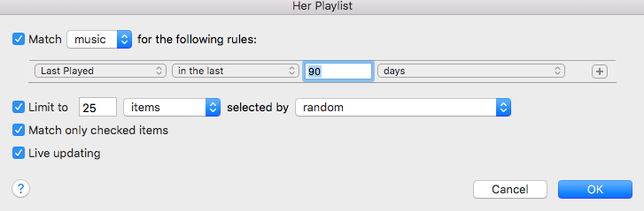

  2. Now connect your iPhone via USB. If it starts backing up and syncing let it finish.
  3. After the backup and sync is finished select the iPhone in iTunes (image #3).

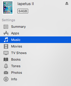

  4. Now Select Music in the left hand menu (image #4).

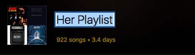

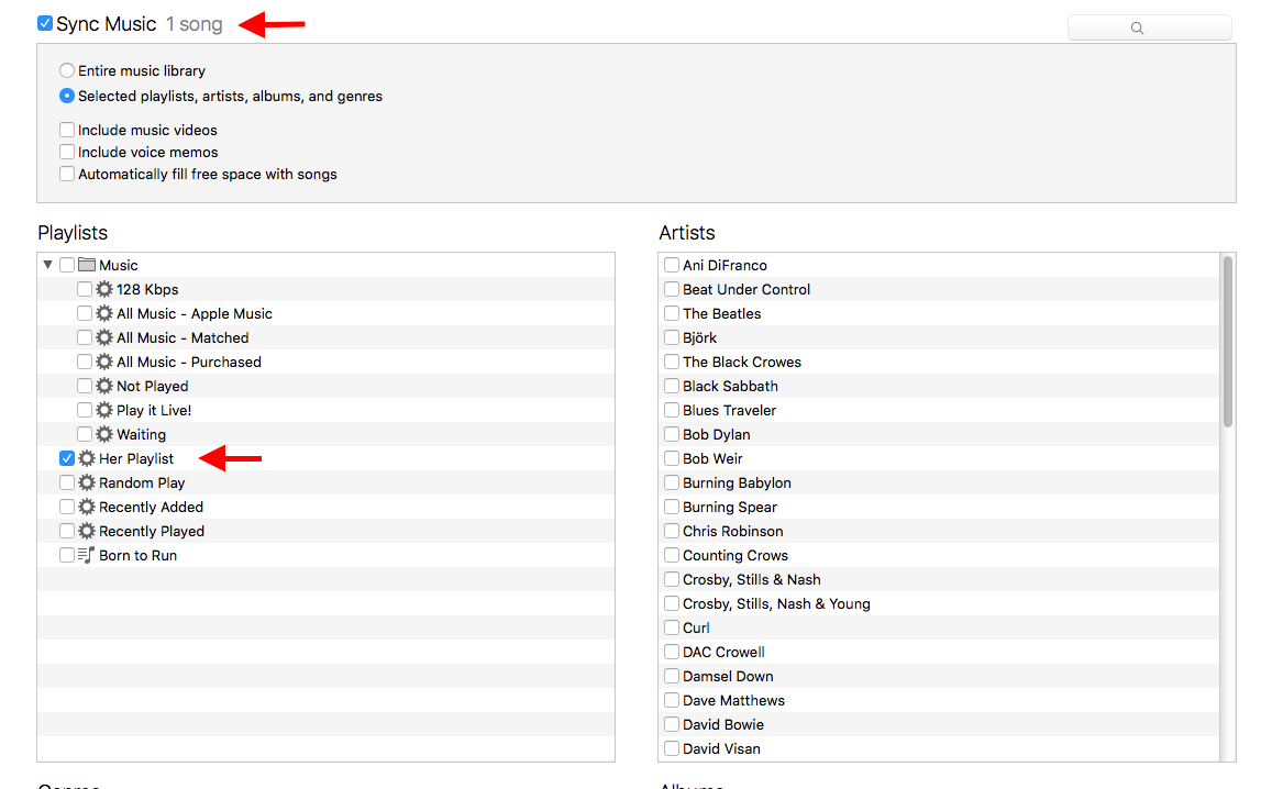

  5. In the main iTunes Window select “Sync Music” at the top. In the Playlists window select “Her Playlist.” Don’t worry about the number of songs at the top, yours ought to say “25 Songs.” Click Apply and iTunes will sync with the iPhone (image #5)
  6. Once the sync is finished disconnect the iPhone and open the Music app. If necessary tap “My Music.” You should see your 25 songs now.
You can now repeat these steps for your husband’s iPhone. Keep in mind that the playlist I created is only for demonstration. You can create Playlists that are appropriate for you and your husband. If you need any advice on creating playlists I’ll be happy to help.

Ok, so, I think the best solution for you is going to be to use Static Playlists. This will allow you to add tracks to the playlist via drag-n-drop, which, generally, you can't do with a Smart Playlist. You will also be able to delete tracks from the Static Playlist by selecting a track or tracks and hitting the Delete key. This will not delete the tracks from the iTunes library; only from the playlist.
Let's start with the Janis Joplin. In the upper right corner of the iTunes window type Janis Joplin in the search field. This should show you all her albums. Highlight all the tracks and drag-n-drop them into the left-hand column. This will create a new, Static Playlist which you can name something like His iPhone. Or anything you want to name it, really.
Now all you have to do is follow the steps I outlined for you previously to sync this playlist to his iPhone. If you do not wish to sync the Smart Playlist to the iPhone any longer unselect it. You can also safely delete the playlist if you don't want to use it anymore.
To add tracks to "His Playlist" simply drag-n-drop them from the main iTunes library. They will sync to the respective iPhone then next time it is plugged in.
Also, when syncing His iPhone be sure and not choose your playlists to sync and vice versa. Unless of course that is what you want.
