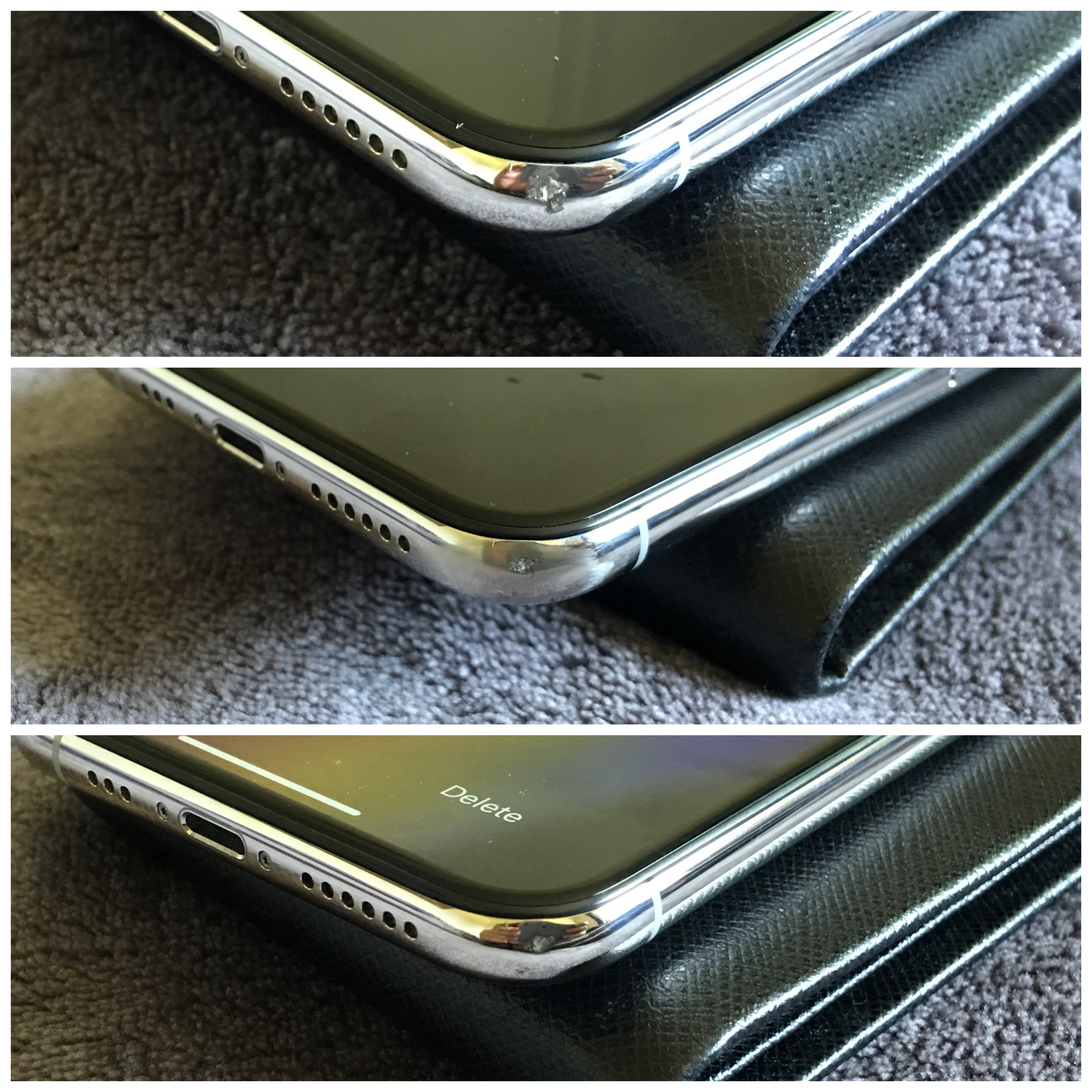

Step 1. Drop your iPhone from a non-obliterating height. My chosen height was approximately chest-height. Glass damage optional.
Step 2. Stare at the floor where your case-less iPhone lies and admit defeat
Step 3. Pick up your iPhone, turn it around, and be a bit excited the glass is only marginally cracked as opposed to shattered
Step 4. Sand your iPhone's damaged stainless steel corner with 1000-3000 grit sandpaper until the corner is smooth. Unfortunately my corner dented from a slightly more severe impact
Step 5. Polish with your polish of choice. I used a cotton pad and Autosol and worked it for about 10 minutes.
I upgrade my iPhone once a year. Some call it wasteful, but technology is one of my hobbies and I enjoy having the most up-to-date smartphone. I'll probably leave it this way for a couple weeks and then decide from there if the chip/crack is worth using Applecare+ on considering it doesn't affect the display weaving portion at all.
