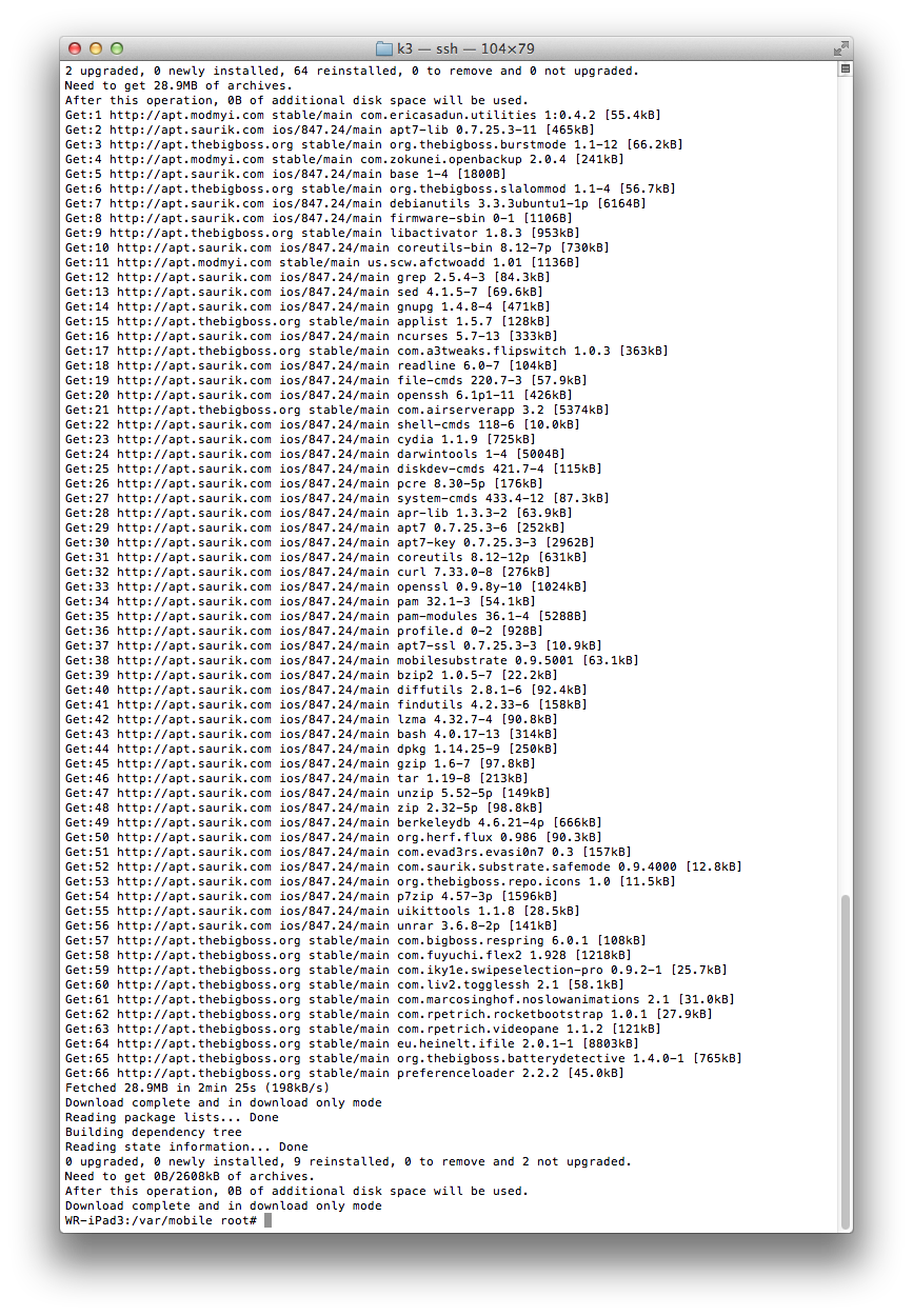

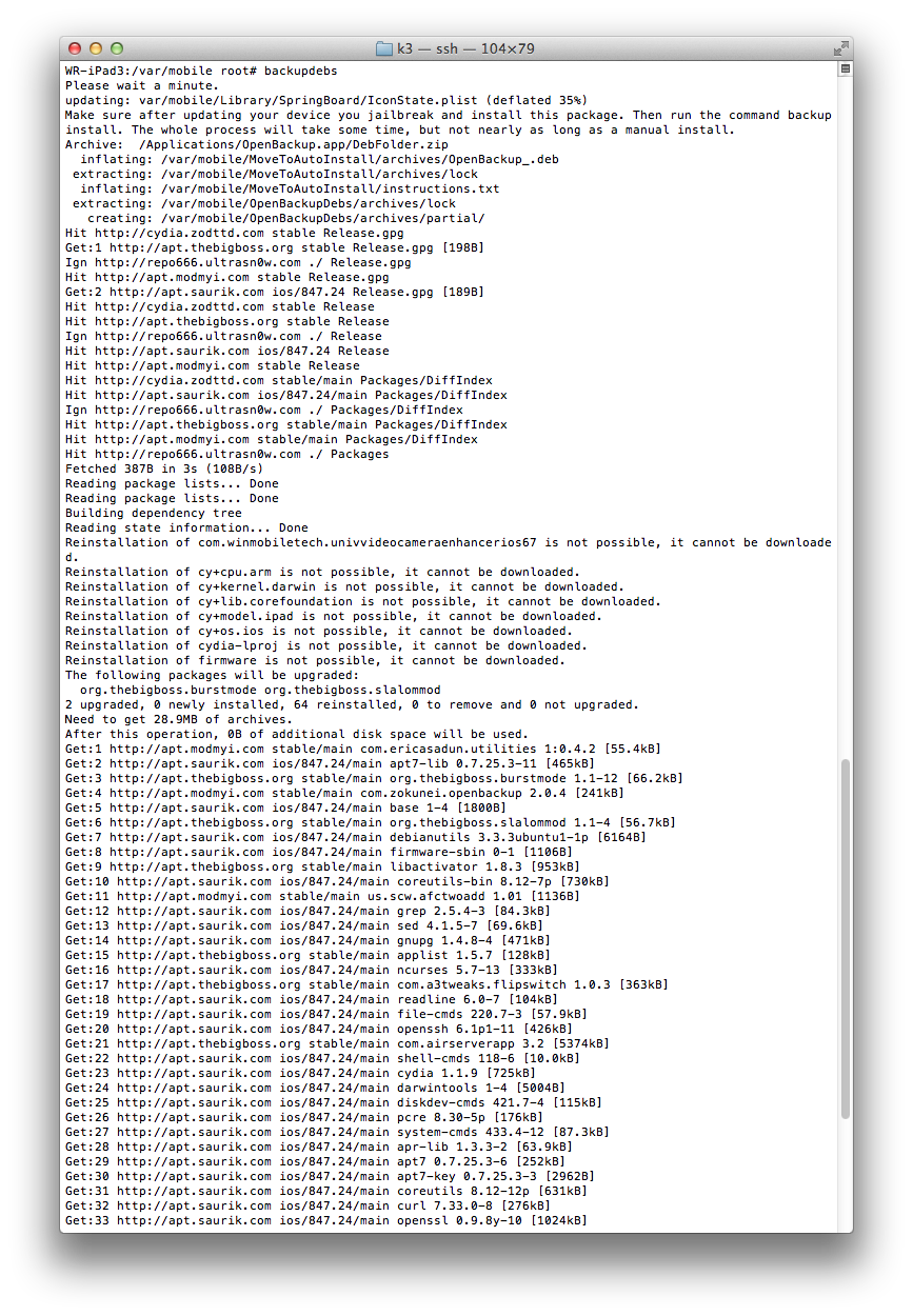

Incidentally, should you have problems with the GUI, I have some very good news for you: it contains no real backup / restore code as it just provides a front-end for the backup* scripts the DEB installer installs to /usr/bin.
Most important of these Unix scripts is backupdebs. If you, after installing OpenBackup, SSH to your iDevice and enter the backupdebs command, it'll nicely fetch every net-sourced DEB file, even commercial ones, to /var/mobile/OpenBackupDebs. As you can see, there's absolutely no need to even start the OpenBackup GUI - all the business logic is in Unix scripts and nothing in ARM binaries.
BTW, as these scripts all call stock APT functions, they're very robust and, again, allow for fetching even commercial packages, which, otherwise, would be a nightmare when directly trying to fetch those over a simple, low-level connection. (I know this as I, as has been pointed out above, played with DEB's, APT etc. a lot.)
Two example screenshots of the full output of the script on my iPad 3. As you can see (check out particularly the bottom of the second screnshot), it did fetch commercial DEB's too:
