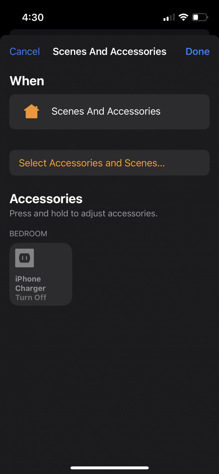

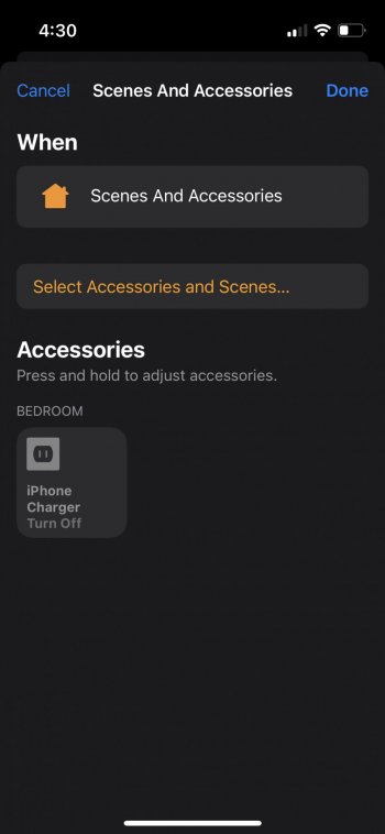

As the title states, I cant figure out how to set up an automation to turn off charging at a specific battery percentage. I am on ios 15 and just bought a wemo smart plug mini.

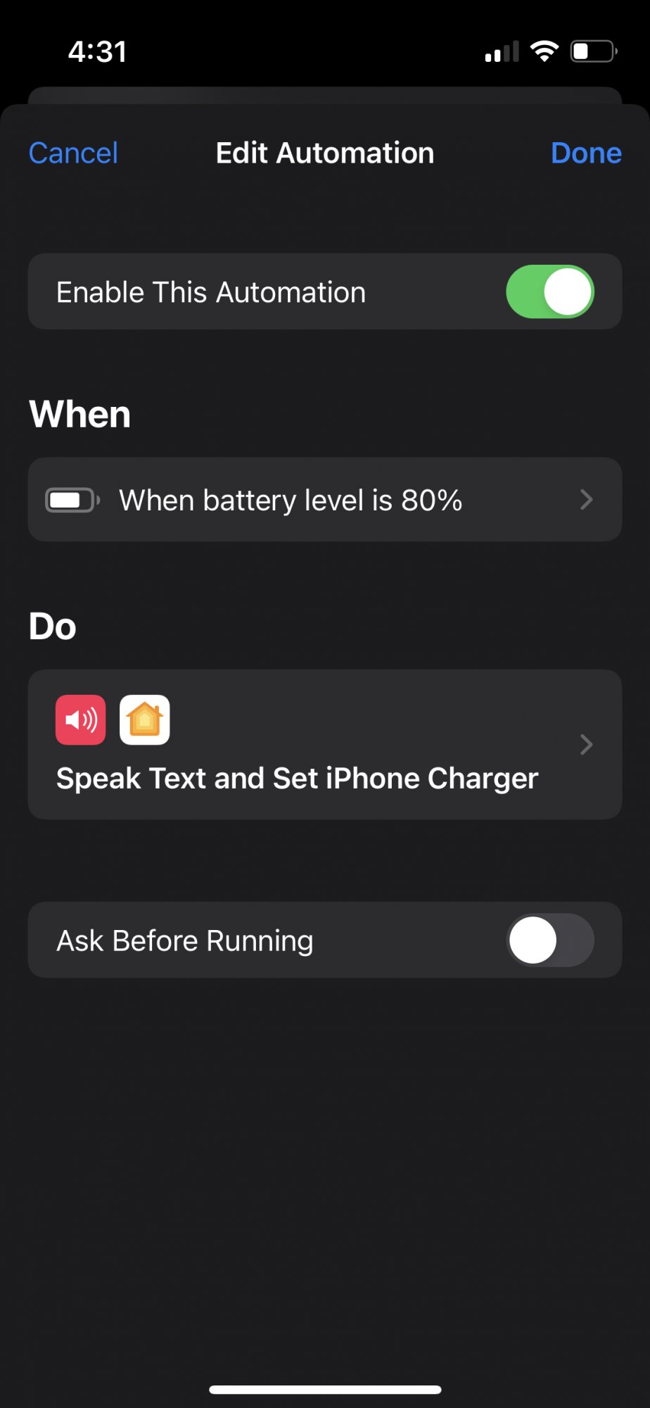

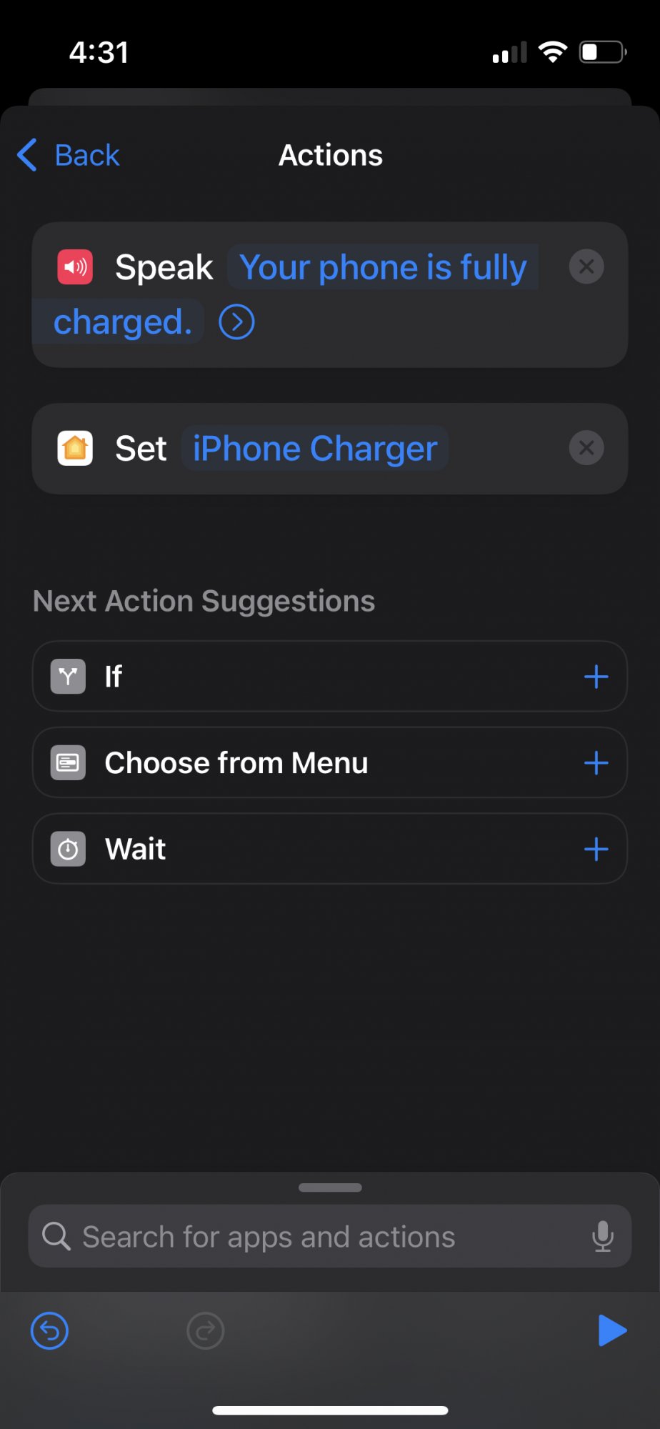

I setup one to turn charge when below 40% and stop at 85%. The way I did it was to have the plug turn on when the phone goes below 40% with one automation and another automation to turn off the plug when it reaches 85%. I probably made it more complicated then necessary but it works for me.. Forum member @Apple_Robert helped me and his help was appreciated as I haven't had much experience setting up shortcuts/automations

Can you send me a screenshot of what was. In the shortcuts app? If Apple Robert can help, I will appreciate it.

No, you don't have to use the speak function.
I got it to work, thanks for your help on that! I was wondering if I could let charge to 100% in the morning, and still keep the 80% automation. Is that possible? I would like to set another automation to charge it to 95% or 100% at 6:30 am.
There can only be one automation sequence. But it’s so easy to change the battery percentage sliders to whatever value you want that it’s not a hassle to change it.

I played with automation in Shorcuts recently to shut off my Homekit controlled plug when the battery is at 80% - from what I have observed, the automation sometimes ignores if the trigger is set as "When battery level is 80%" thus keep on charging my phone until 100%.
I changed the trigger to "When battery level rises above 80%" and so far it always works - however interesting thing that I observe is that I expect the automation to be triggered when the battery level is at 81% (which it does most of the time), but I saw one time that the automation triggered but when the battery level was at 82%.

I have had no issue with using “When battery level is 80%”, have not had it fail yet. One of things I do is turn on low power mode after I shut off the charger. I like putting my phone on low power mode when it goes into standby.

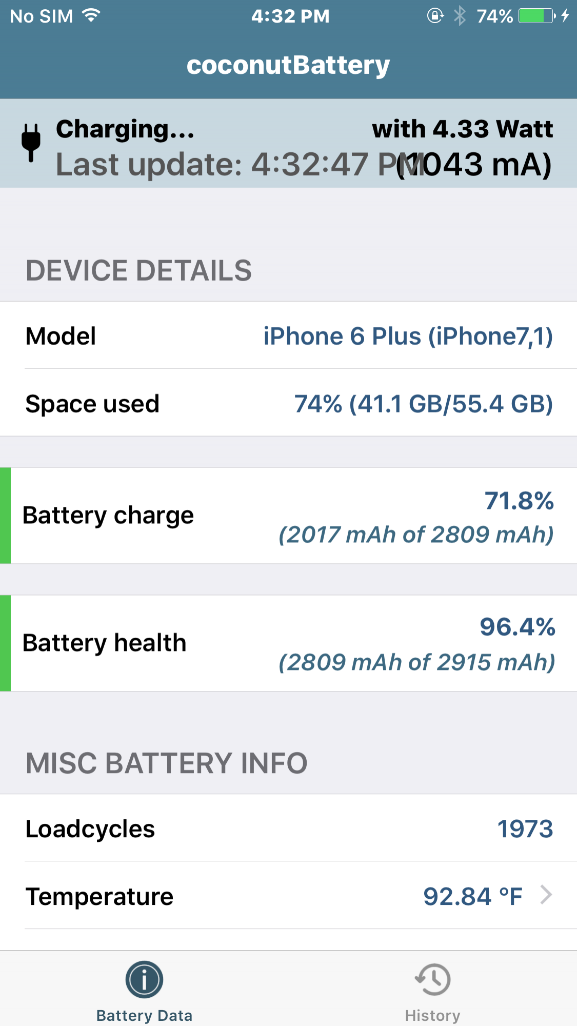

I’ve actually done a real world test over the span of 6 years with an iPhone battery - the original battery that came with the phone (iPhone 6 Plus). Over that time period (6 years) I tried my best to keep the battery SOC between 65% and 75% since I was usually near a power outlet. Sure there were times when I charged it higher and discharged it lower, but overall I’d say my SOC was kept within the range of 60% to 80% for six years.
The phone was used heavily at least 8 hours every day for 6 years.
Every battery manufacturer, including for EVs say that the farther you can keep a lithium ion battery away from 100% SOC, the better. The most relaxed state a lithium ion battery can be in is at a 40% SOC.
Also deeper discharging creates more stress on the battery than shallow (according to battery university)
Here’s the results of my 6 year test on an iPhone 6 Plus original battery:
1973 Load Cycles
96.4% Battery Health
Seems hard to believe- but it’s true (according to coconut battery)
I’ve seen the battery health % drop down to 92% when it’s cold outside)
So the take away is - if you’re near a power outlet and are plugged in all the time, if you keep the battery SOC between 65% and 75% using a Shortcut controlling a HomeKit charger - the battery will EASILY outlive the useful life of the phone by a factor of probably 3X.
