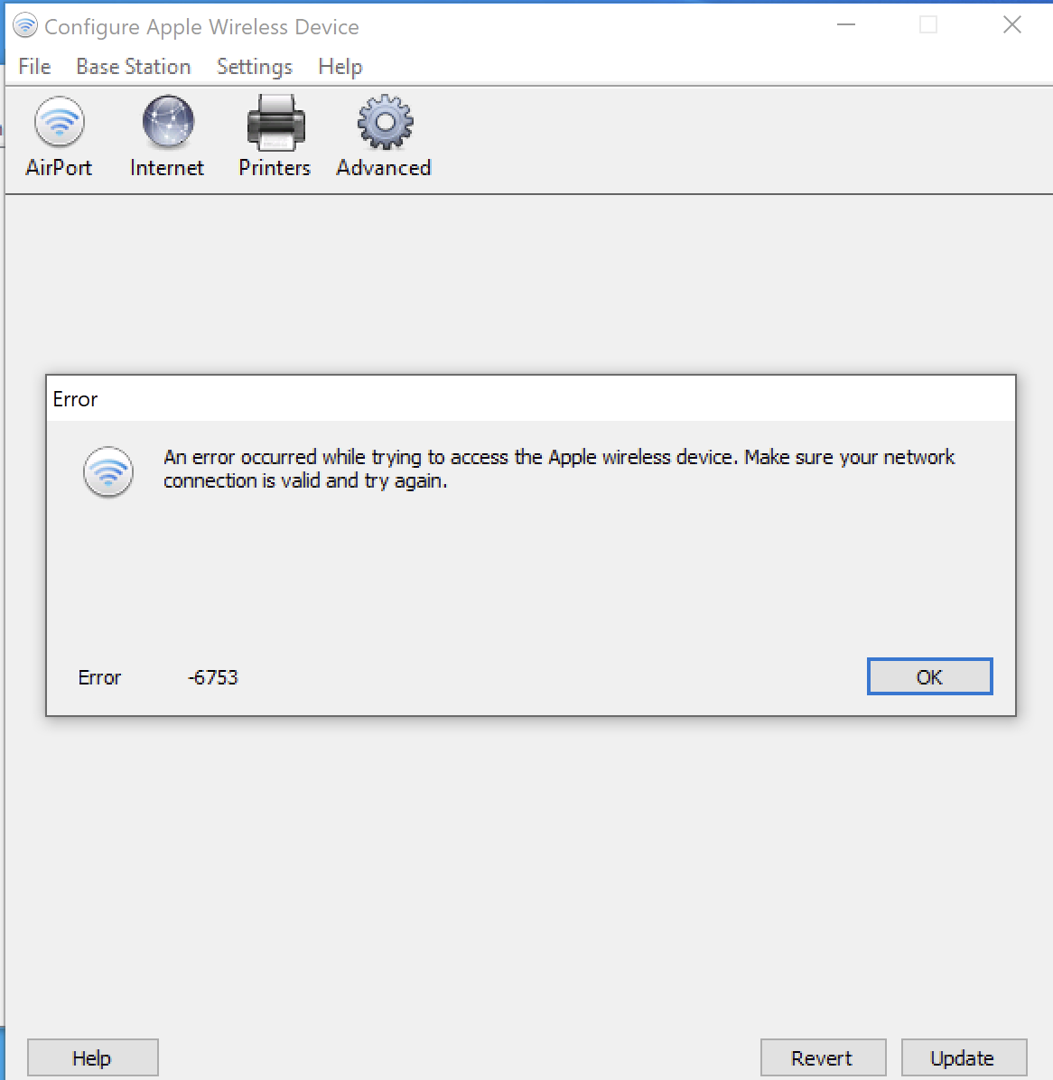

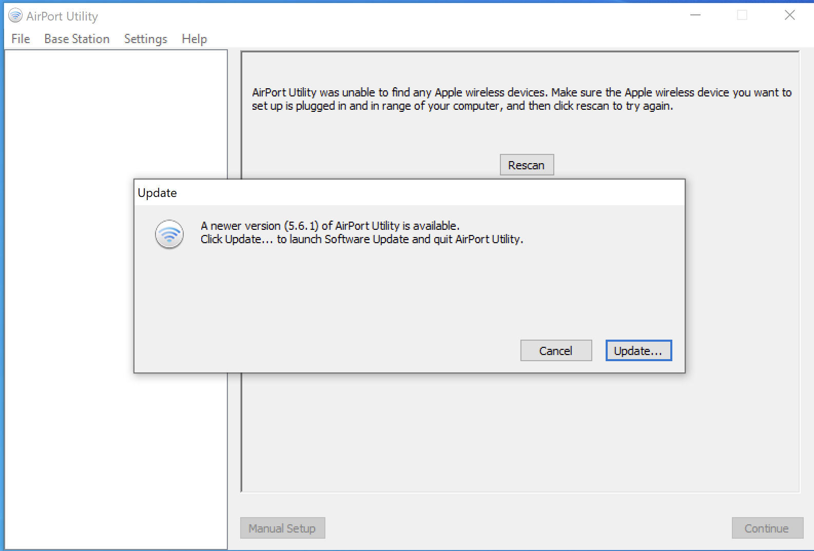

I've been running Win 7 on Virtual machine and I thought I might get a better result via Win 10 on Parallels. Downloaded Airport Utility 5.1 no problem, but it still won't recognise my device. So tried going into the file menu and Configure other... and got the password window. Tried both my wifi provider's password and the router password, then several other suggestions from the web. Also tried resetting the device. Still no-go. The update didn't work either.

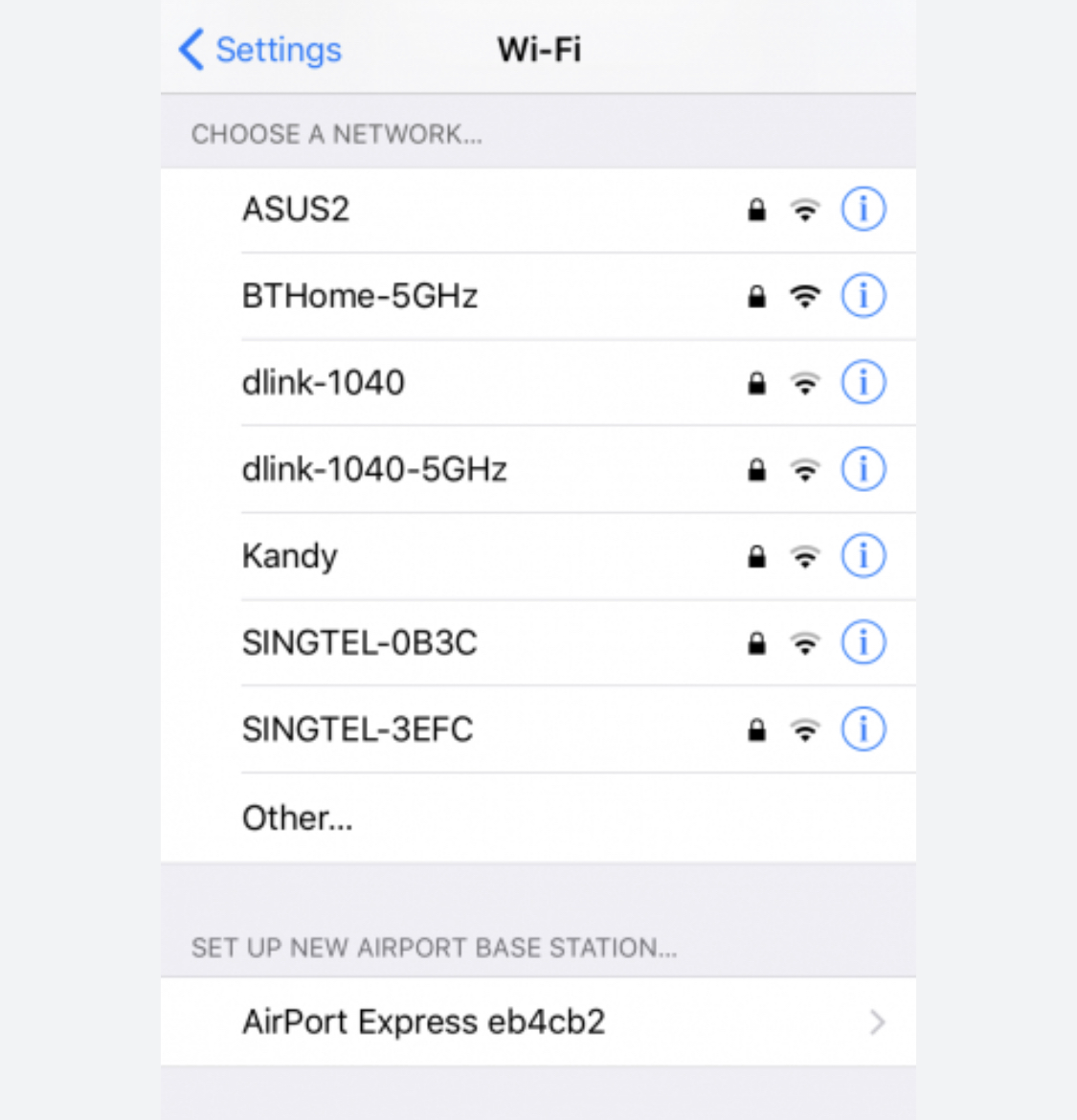

airport express gen 2 is configurable from an iphone.
just factory reset the device, then on your iphone goto settings -> wifi and scroll to the bottom. there should be a bubble that says setup new airport express something something
edit: found a screenshot, this should work on modern versions of ios i did it not too long ago...

i just told you none if that is required.
factory reset the AE, then goto wifi settings on your phone. done.
