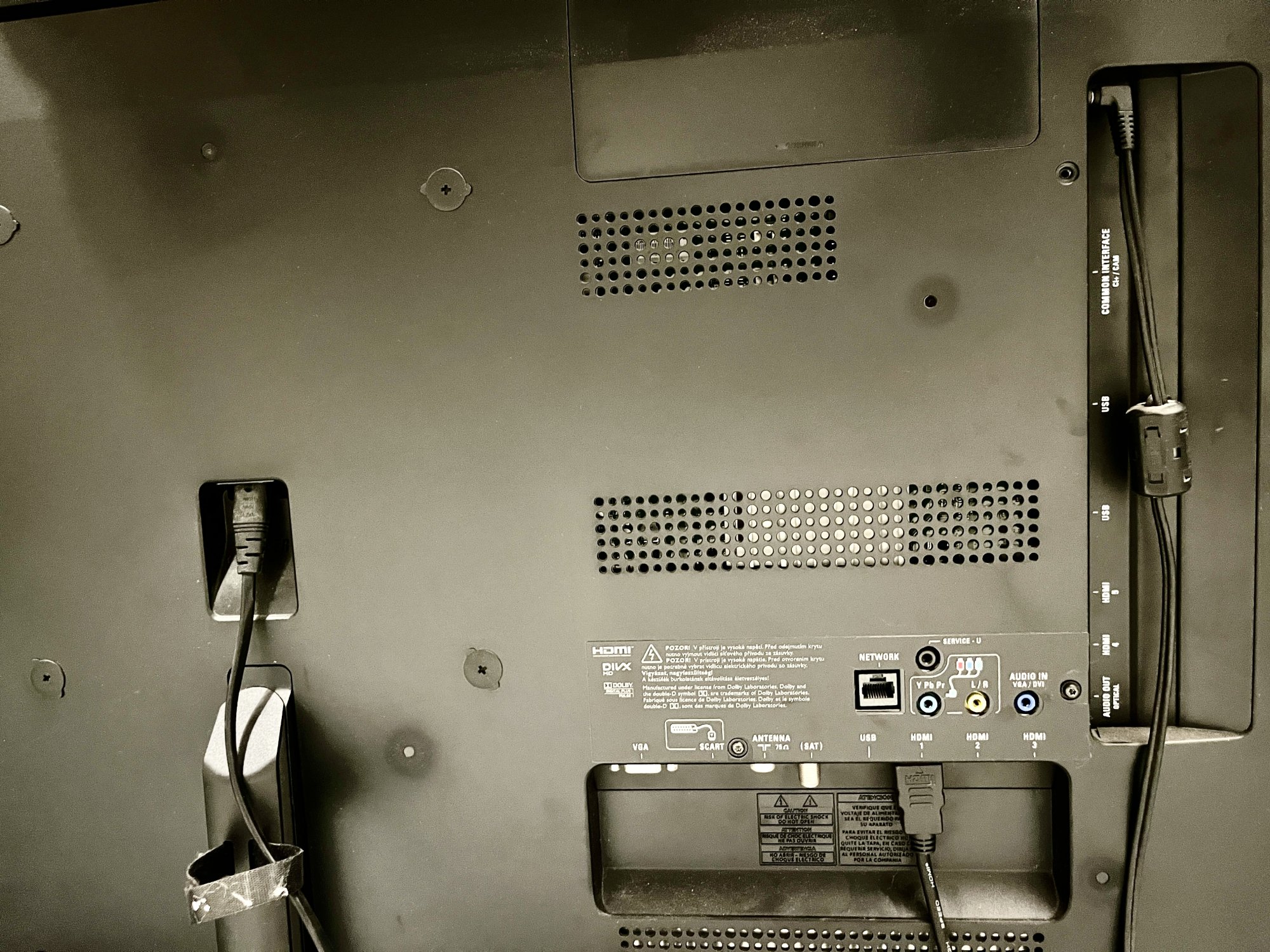

Hey people,
I just got myself an Apple TV 4K 128 and would like to connect it to our (rather matured) Philips TV.
This TV has really bad sound quality, so bad, that in fact I have to very much rely on subtitles a lot of times.
My goal is to connect a pair of passive speakers to it, and I would like to be able to adjust the volume level with the Apple TV remote.
Can this be done at all? I do have the speakers already, and I am willing to buy a small amp/receiver, but it shouldn't be more than what I paid for the Apple TV.
Can you give recommendations when looking at the connections our TV has? It's mostly HDMI, but I imagine that there are other possibilities?
Needless to say that I feel very uncomfortable in the receiver/amp/cable standard world.

Connect the ATV (apple TV) HDMI to the TV-HDMI 2. Connect your speakers to the TV Audio out (you may need an amp but try it anyway)
The ATV remote MAY turn on the TV when you turn on the ATV. If not try another HDMI port on your TV. (The TV's documentation may have this information in it) If that doesn't work just turn on the TV with its remote and then turn on the ATV. You WILL be able to adjust the volume with the ATV remote while using the ATV.
Don't forget to setup the Audio out on the ATV settings to TV speakers.
Hopes this helps.
