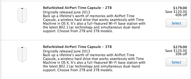

Yes that entire Airport family of routers is totally solid. :apple: The Time Capsule is as simple and reliable as can be. Today there are two in the Apple refurbished site for $90 less than the Best Buy sale prices. If you snooze...

I totally get not wanting to pay for router functionality that you don't need/want, but I did want to mention that if you got a Time Capsule for the wireless backups, you don't need to use its routing features at all. You can just connect it to your existing router or switch with an ethernet cable, put it in bridge mode, and use it as a nice reliable, automatic Time Machine backup destination for all of your Macs. You can turn on it's WiFi if you want (perhaps covering an additional area of your household) or just leave it off.
In that case, it would be a $180 backup system (ignoring its other features). Compare that cost to other wireless, automatic solutions...
[as mentioned above, a practically identical solution is an Airport Extreme (current model) with an external USB HDD plugged into it -- could be good for you if you want to use your existing WD drive. more power cables and more clutter, but cheaper still.]
[love my 1st-gen TC, and just bought the refurb TC mentioned above and put a 5TB HDD in it!]
