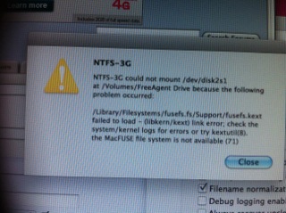

I'm trying to run a external hdd with macfuse and ntfs-3g. I installed both but come across an error message. see attachment.
after some searching, i think it's because i have 64 bit snow leopard on mbp w/ i5. any other suggestions? if i boot into 32 bit mode, will everything work or will it crash/slow down?
Everything will run just fine in 32-bit mode.
