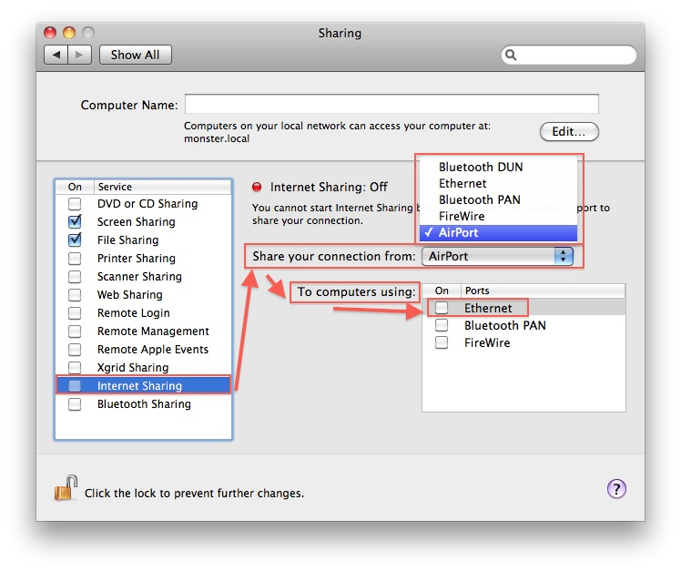

Did you set System Preferences > Sharing > Internet Sharing > Share your connection from: AirPort > To computers using: Ethernet?
Is your XP laptop connected directly to the Mac?

Yes I have set up the mac side so that Internet Ethernet sharing is on.
The xp laptop is plugged directly into the MacBook.
