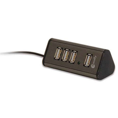

The AirPort Express supports "several printers connected to the base station via a powered USB hub", so yes, that would work. As far as the hub goes, the Macally Mini hub comes with an AC adaptor and has a rather small footprint.
