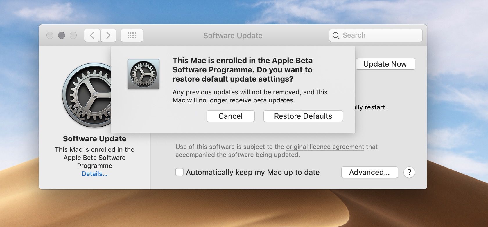

Before you reinstall Catalina you should first remove the Mac from the Beta program as this will stop the beta updates from arriving on your Mac.
Here's what you should do:
Open System Preferences on your Mac.
Click on Software Update.
On the left side, under the cog icon, you will see the message: "This Mac is enrolled in the Apple Beta Software Program". If you want to stop receiving beta updates on you Mac click on Details.
A pop up will appear asking you to confirm that you want to restore default update settings. It will indicate that any current updates won't be removed but you will no longer receive beta updates. To confirm this click on Restore Defaults.
Then follow the advice given by @Mr_Brightside_@ above.
