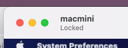

EDIT I just noticed this "locked" indicator in Screen sharing. Never seen that before? Any way to turn that off

Go into screen sharing, & view all connections on menu bar, then delete them all & set them up again?
As for the locked, I thought that referred to the Mac mini status ie. screen locked?

Thanks. The thing is screen sharing works perfectly. Its connecting in the Finder that doesnt work - ie selecting "network" then "macmini" works up to the point that mini is mounted. But nothing can be opened - it shows logged in as my applie id email. The Disconnect button doesnt work. Nor does the Screen sharing button (have to open the ss app myself to get the screen shared). The mac mini "mounts" and appears in left panel and presents the root list of drives and its user folder etc but you cant open anything. There is also a crossed pencil icon (read only?) in bottom left like when you open and NTFS volume.
The mac mini is headless so I have no idea what locked means in that context? Certainly I didnt lock it and no functions of screen sharing seem to be affected as it works perfectly.

All's well that ends well I guess, but screen sharing still says "locked" - but that seems to have no effect on functionality as I can copy to and from via drag and drop between my mac and mini, and I can control the mini completely.
