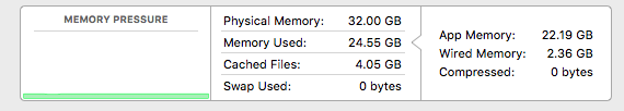

only thing id add is small amounts of "swap used" is ok but large numbers are bad, also if you can check it as you do tasks you may want to be faster to see what is going on, if your working and it's slow check activity monitor and see whats maxed out.

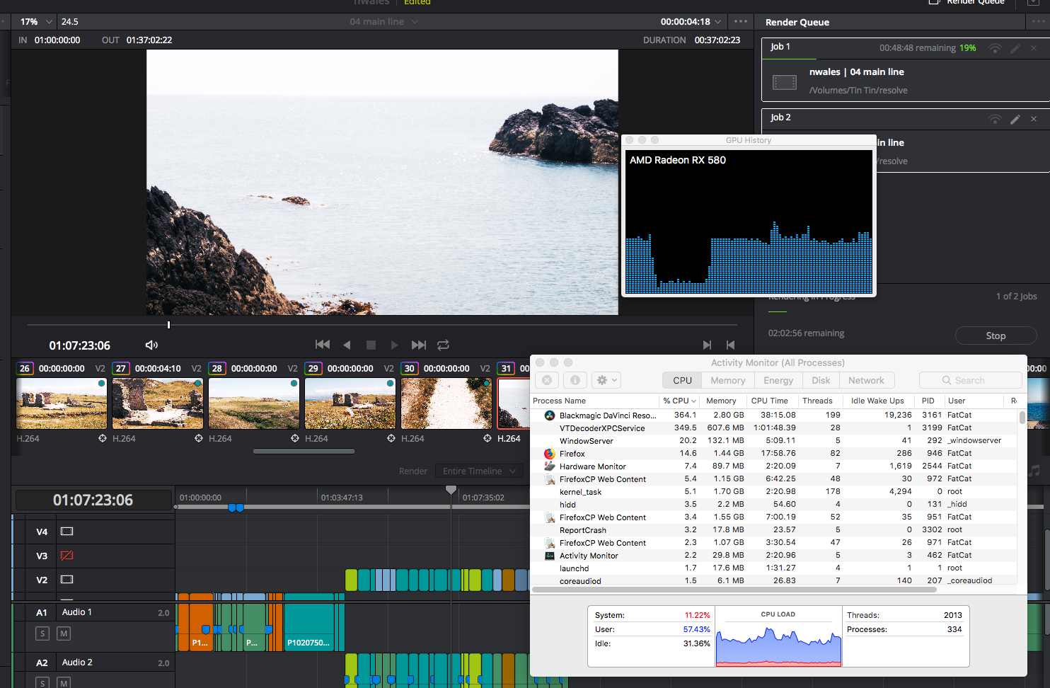

thats an example of me exporting video, you can see the GPU is about 40% used and the CPU is hitting about ~700% (the app has two main processes going each using about 350% ie 3.5 cores so 700% total) which means it's CPU limited not GPU limited ram use is low only ~4GB live ram for the program/processes but id gess more cached in ram.
osx by default will now cache as much as it can in to ram so memory used is not a good measure of ram use & now will when running low on ram start compressing the contents of the ram before it starts hitting the "swap" hard which is relay cool.
iv got 32GB of ram and 99% of the time in CPU limited now at peak use times like exporting video etc..
edit the video is 4K h264 export with some effects added, so use of GPU/CPU can change but mostly that screen shot is a good example for my exports

While the swap advice given by AliGT83 and orph is correct I would recommend ignoring the swap number and look at the "Memory Pressure" graph. It will be green when memory is plentiful, yellow when its nearing exhaustion, and red when there's insufficient memory. It graphs it over the "Update Frequency" so you can see a history of memory usage.
Memory Pressure is Apple's way of representing memory consumption in a simple manner. Swap is useful if you know what swap is and how to interpret the value provided.

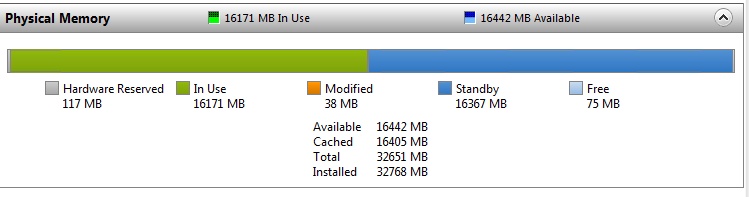

Looking at swap and memory pressure data might not show you that a lot of performance is lost because there's no free (or "standby") RAM available for filesystem caching. Right now my Windows laptop shows:
In other words, it shows about 16 GiB of RAM in use, and about 16 GiB of filesystem data in cache as "standby". So 50% of RAM is dedicated to active programs, but 100% of RAM is actually "in use". ("Standby" RAM will immediately be given to any program that asks for more active memory - so it is "available" according to this chart.)
I'm not sure if "Activity Monitor - Memory Pressure" reflects that there isn't RAM available for filesystem caching - but if it doesn't you might see "green" when in fact additional RAM could really speed things up by increasing the effectiveness of filesystem caching.
