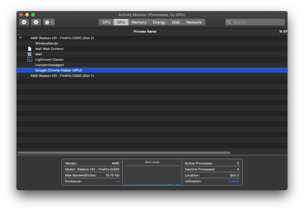

It's not possible. Only one GPU is used for monitors. The other is for computation when needed.
I use GPU History under Activity Monitor to see how much the second one is used and when. But normally it's not used a part in FCPX on my side.

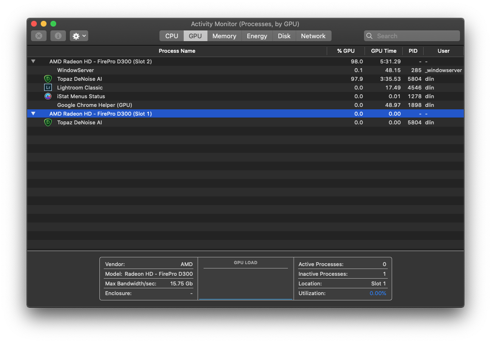

One GPU for displaying images to monitors and one GPU for processing. Isn't this a good idea? With the Catalina OS, the 2nd slot GPU seems to be more active than before.

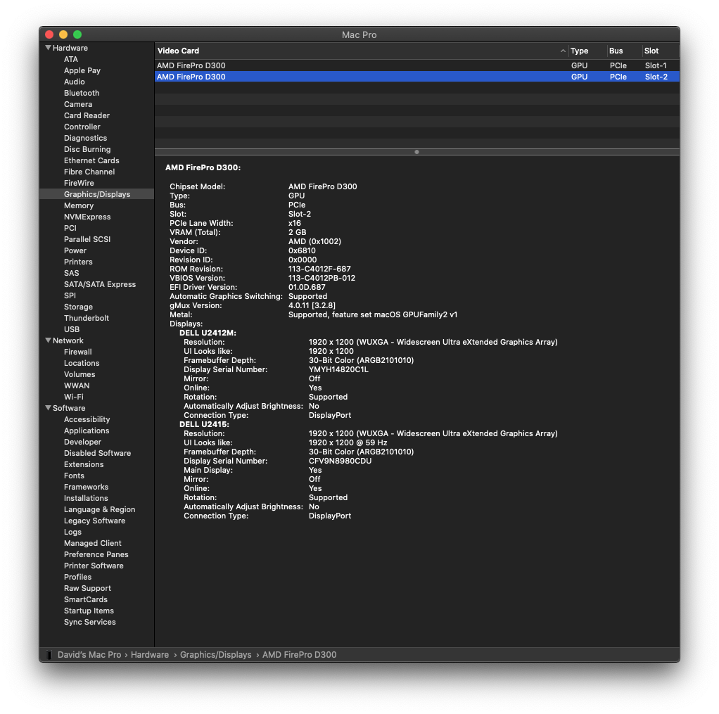

The above may be a bug in Mac OSX software. According to the System Information panel, the monitors are connected to Slot-2 of the GPU cards. However, the above Activity Monitor showed the opposit.
Monitor via hdmi, thunderbolt etc are from slot2 this is why you see LR,Topaz,istat in slot2.
Slot1 is used for processing as you can see Topaz is the only process in slot1 that use gpu processing.
If you look at the chart, the GPU in Slot 2 was the one that had a high CPU level when Topaz was performing the task.
For me it mean that the other one (slot1) is almost unused. So all the processing and projecting on the monitor is done in slot2.
