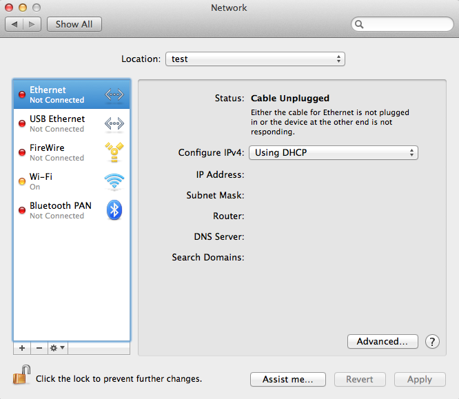

You said the icon doesn't go green? What icon are you talking about? What color is it? Also, grab a screenshot of the window you're talking about and post it here.
Here is a screenshot...

I took the screenshot shortly after disconnecting the USB - Ethernet adapter.
That's probably it still says set for DHCP.
A screenshot when it isn't connected to a network port isn't as useful as one from when it is connected as is might have been yellow or it might've had a useful status shown.
As said, wouyld still have the electrical connections. I suggested using a known working port and cable to eliminate everything outside the Mac.
