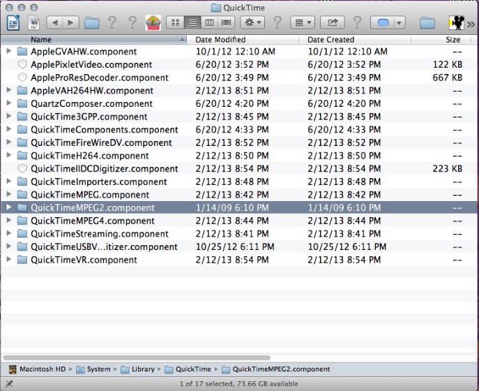

I followed the instructions and now have my fingers crossed hoping I didn't screw something up. If anyone sees a blunder on my part, please don't hesitate to warn me. I am in a little over my head.
Apple says the QuickTime MPEG2 component only works up to Snow Leopard. What OS do you have? (I know that the MPEG2 component that I used for Snow Leopard doesn't work in El Capitan although I didn't try hard to see if there were workarounds.)

I'm on Mountain Lion, but I haven't tried to use the MPEG 2 yet, nothing to try it out on. However, the MPEG I downloaded is on this website.
