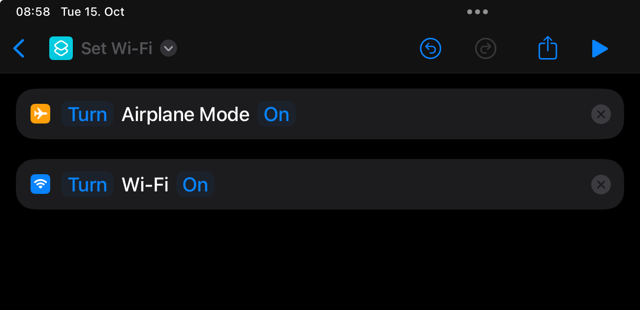

you can easily do this in Apple Shortcuts. First create a shortcut like this:
save it under some adequate name. 🙃 Within Shortcuts then switch to »Automation« and create an automation which “on arrival” at the geolocation you specify, runs this shortcut “immediately”. Done. 🤓

And just in case your home can't be pinpointed correctly for whatever reasons, you can set joining your WiFi as trigger:
When *Your iPhone* joins *Your WiFi* Do *The Shortcut from above*.
Same as for geo-fenced triggers, you will get a notification once the Automation is run that cannot be suppressed.

So I couldn't get the location-based automations to work. Did lots of research, and my phone is set up in such a way that it should work.
However, using "wifi" as a condition does work...when my phone connects to wifi, airplane mode is turned on and wifi is also turned on after that. When my phone disconnects from wifi, airplane mode is turned off, so cellular is turned back on (if available).
I like it, it's simple and it works. The location-based automations seem a bit on the touchy side *smile*.
