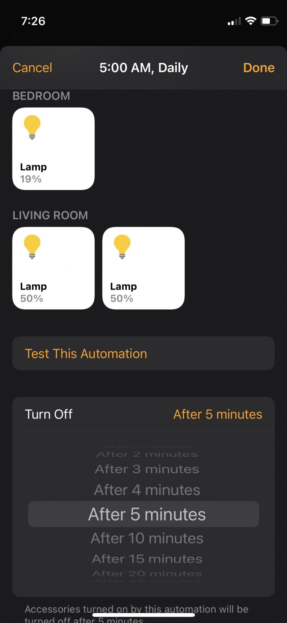

Great. What is the command because if I ask Siri to turn on a smart plug for 3 minutes it doesn't work?
Where? There is nothing like that on any of mine (Merros) from what I can see. Cheers.
Look under automations in the HomeKit app. I set up an automation where my lamp turns on at 5am and turns off after 5 minutes.
