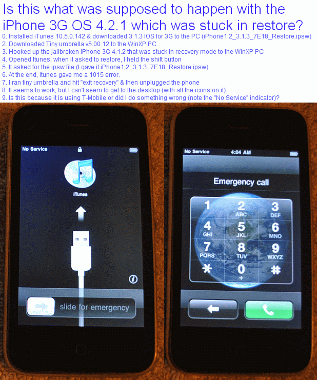

Once I get the iPhone 3G out of recovery mode, I'll attempt the downgrade from 4.2.1 to 3.1.3:
Thanks to your advice, I'm out of recovery mode!
Now I'm stuck in "emergency call" mode (which may be because I have a T-Mobile SIM card in the iPhone 3G).
So, I followed your advice as shown below to downgrade the iOS from iOS 4.2.1 to iOS 3.1.3:
NOTE: This was all done in 'restore mode' (nothing was done in DFU mode yet).
  1. I first installed iTunes 10.5.0.142 on the WinXP PC
  2. I then downloaded the iClarify iOS 3.1.3 for iPhone 3G (iPhone1,2_3.1.3_7E18_Restore.ipsw)
  3. I downloaded Tiny umbrella v5.00.12 to the WinXP PC
  4. I tethered the jailbroken iPhone 3G 4.1.2 stuck in recovery mode to the WinXP PC
  5. I opened Itunes: I held the shift key & then pressed the Restore button
  6. Itunes then asked for the ipsw file (I gave it the iPhone1,2_3.1.3_7E18_Restore.ipsw)
  7. After a while, Itunes gave me a 1015 error (which, I think, means I have the iPad baseband)
  8. I ran tiny umbrella and hit "exit recovery" & then unplugged the iPhone & tried to use it
  9. I then ran through the entire process again (and again I got the 1015 error).
Tiny Umbrella says the versions are the following:
  • Device Model = MB702LL/A - iPhone3G
  • Installed Firmware Version = 3.1.3
  • Installed Baseband Version = 06.15.00-5.9_M3S2
I had expected the phone to have all the desktop icons; but it doesn't let me get there (is this because the SIM card is for T-Mobil?). All I can do is make an emergency call.
Was this supposed to be the expected results?
If so, would someone kindly summarize the next expected steps?
Thanks for all your help ... I much appreciate it and realize you don't have to help me ...

Thanks to your advice, I'm out of recovery mode! Now I'm stuck in "emergency call" mode
To close the loop on that issue (and to provide help to anyone using this thread for future research), Crystal-RX (and others) kindly walked me through all the steps over in this thread to a complete recovery (sans data):
- How to resolve locked up jailbroken iPhone stuck in "recovery mode" (see pictures)
I spent an hour writing this up expressly so that others who have the same problem can follow easily the recovery sequence below (which took me very many days to decipher even with lots and lots of help) - but - if you follow it - you'll traverse the steps in just an hour or two!

JAILBROKEN iPhone 3G 4.2.1 BB 06.15.00 STUCK IN RECOVERY MODE:
- After much research, I installed iTunes 10.5.0.142 on the main computer (which didn't have iTunes on it previously).
- I downloaded the iClarify iOS 3.1.3 ipsw for iPhone 3G (iPhone1,2_3.1.3_7E18_Restore.ipsw)
- And, thankfully, I also downloaded Tiny umbrella v5.00.12
- Tethering the iPhone 3G 4.1.2 stuck in recovery mode to the WinXP PC, I opened iTunes
- The original danger was that iTunes would load an updated iOS & baseband onto the iPhone; but those worries thankfully vaporized because the latest signed iOS for an iPhone 3G was 4.2.1 already and the baseband was already 06.15.00 (unbeknownst to me at that time).
- In Itunes, to prevent iTunes from installing the latest 4.2.1 iOS, I held the keyboard shift key & then pressed the iTunes "Restore" button
- Itunes then asked for the ipsw file (I gave it the iPhone1,2_3.1.3_7E18_Restore.ipsw from iClarify)
* I presume this ipsw contains a lower baseband than the one I had so the baseband apparently didn't load.
- After a while, Itunes gave me the expected 1015 error (apparently due to the iPad baseband)
- I first ran tiny umbrella and hit "exit recovery" to get past that error (which probably worked without me knowing it).
- Since some said to install the iOS twice to get past the expected 1015 error, I (probably unnecessarily) again ran the iTunes shift-restore install (and again got the 1015 error, which was surprising because doing it twice is supposed to work).
- Hoping it would help, I clicked the Tiny Umbrella TSS button without researching what it did; that seemed to work but who knows what really worked in this particular instance.
* I'm surprised I was able to downgrade the iOS from 4.2.1 to 3.1.3 without ever consciously skipping iBoot by putting the iPhone 3G into DFU mode!
iPhone 3G 3.1.3 BB 06.15.00 STUCK IN EMERGENCY MODE:
- At this milestone, the phone was stuck in "emergency-call only mode"
- Tiny Umbrella reported:
* Device Model = MB702LL/A - iPhone3G
* Installed Firmware Version = 3.1.3
* Installed Baseband Version = 06.15.00-5.9_M3S2
- My next step was to activate (either with an active or inactive AT&T SIM card or to hacktivate with Redsn0w & SAM)
- I still had my now-inactive AT&T SIM card so I chose to activate through iTunes which was the easiest method
- Now I had an iPod with the familiar home screen sea of icons; but no phone.

- My kid lost all the data ... but now, thanks to your help and from others, we started with a Craigslist T-Mobile jailbroken/unlocked iOS 4.2.1 iPhone 3G (baseband 06.15.00) which was stuck in iTunes restore mode - and now ended with a working T-Mobile jailbroken/unlocked iOS 3.3.1 iPhone 3G (baseband stayed the same)!
Note: There was no need to save or load SHSH blobs! (whew!)
The only remaining questions:
Q: How did the iOS downgrade occur without going into DFU mode (i.e., the iBoot loader was still running AFAIK)? Maybe the TSS button in Tiny Umbrella allowed the downgrade without DFU mode???
Q: At no point did the baseband change but many articles I read warned against upgrading the baseband. Which step in the process above 'would' have updated the baseband without my knowledge? Is the baseband inside the ipsw?
Q: My kid transfers audio & video without iTunes; but I now realize we need a freeware tool to backup and sync data. What is the most recommended non-Apple tool for backup &/or sync?
Please help anyone?
