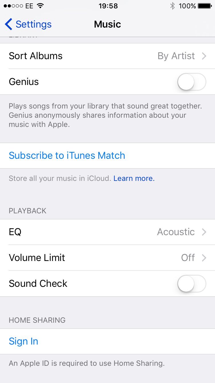

I thought the cap was only on the iPod?
On the iPhone it is just a switch in the music settings.
The EU cap settings in the music settings are useless. To get the iPhone/iPod Touch truely uncapped you have to get root access to the volume settings through iFile while the device is jailbroken.
