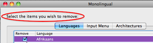

  15. GGJstudios macrumors Westmere
    GGJstudios
    Joined:
    May 16, 2008
    #15
    Monolingual is safe to use IF you pay attention to what you're doing, as you should with any such app. You should also make a current backup before attempting to use any such app. You should check the items you want to remove, not the ones you want to keep.

    Removing Architecture files
    So let me get this right - people are finding that it isn't even safe to remove PowerPC files if they are on Intel??
  17. GGJstudios macrumors Westmere
    GGJstudios
    Joined:
    May 16, 2008
    #17
    Yes, it is safe. Just pay attention to what you're removing.

  19. GGJstudios macrumors Westmere
    GGJstudios
    Joined:
    May 16, 2008
    #19
    It is important for those who want to maximize their internal storage space to avoid having to carry an external drive, especially those with MBA or MBPr models. It's not a problem at all if unused architectures are removed. As far as languages, there have been a few instances where an app didn't perform as expected if a certain non-English language was removed, but such cases are extremely rare and none involved removing the Chinese language. If you run a backup before using Monolingual (as you should before performing any such operation), it's perfectly safe.
