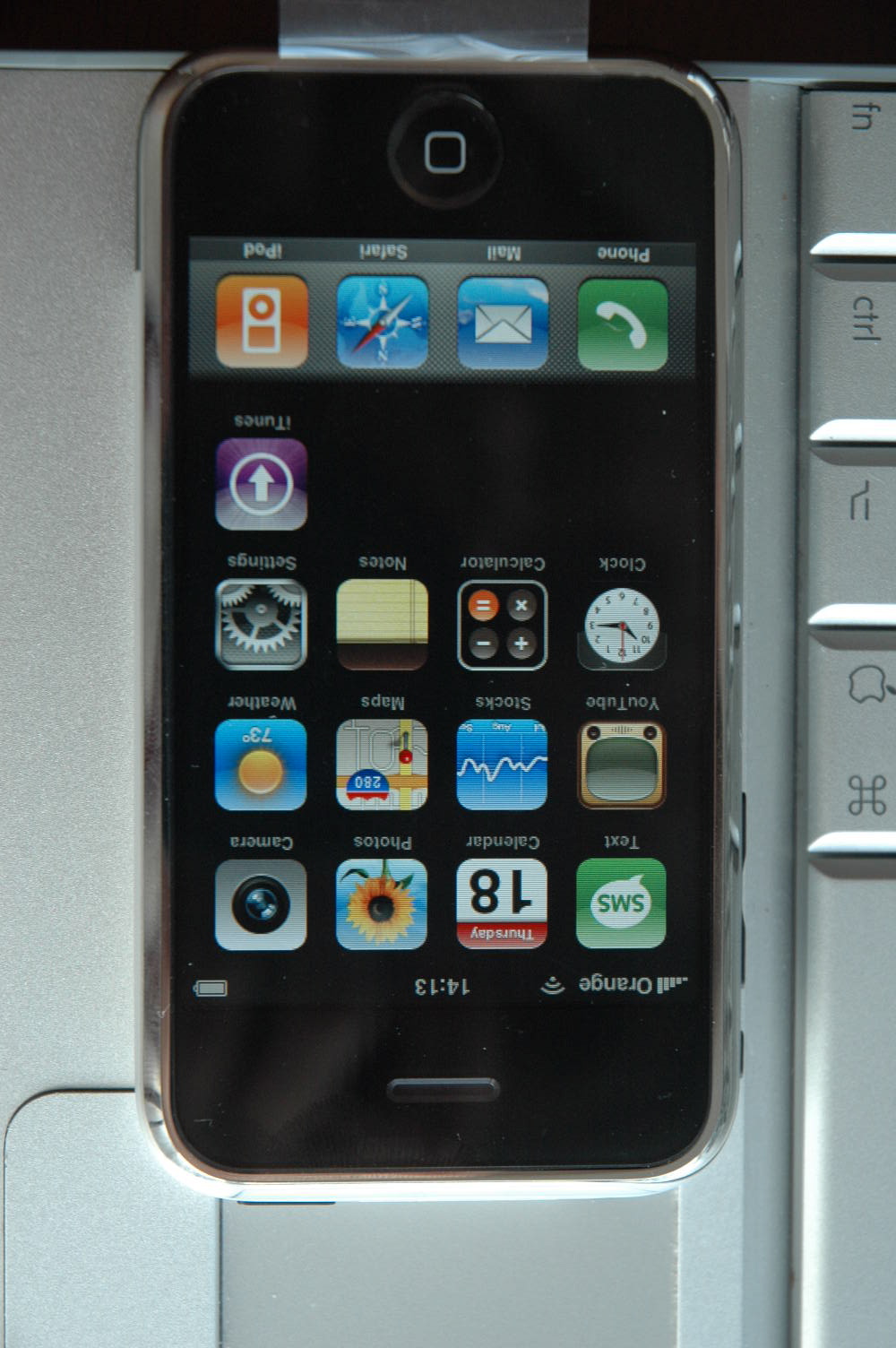

Success!
Arrived this morning, 1.0.2. Decided on the $60 iphonesimfree method- worked like a charm
Went to freeouriphones.com/mactutoral.html
Bought licence.
Downloaded folder of all the stuff you need to turn a phone in any state to a 1.1.1 sim unlocked state (this contains iNdependance, and the Simfree software that needs a licence).
Followed the steps very carefully.
Panicked slightly in the middle.
It takes you through the steps to upgrade to 1.1.1 and then activate again.
No complicated file transfers or programming type things, just simple steps.
AND IT WORKED!! Would recommend to anyone in the absence of a easy free method (which there isn't at the mo).
I have also made a donation to the DevTeam for all their groundwork and think we all should support their efforts.😉
Gotta go play...😀

OK, finally got to open my box. It's a 1.0.2. Is Dans way still the best (its been 2 weeks since his instructions and things are moving super fast). I saw something on the front page about a website you could go to but I think that was only for 1.1.1 phones. Time to do some research
eV
Ugh. Why is this so difficult for me to understand. Dan, I went to your site
We are happy to announce the long awaited tutorial on how to Unlock, Jailbreak, Activate and allow your iPhone to run 3rd Party applications.
The easy tutorial only requires the iPhone to have the v1.1.1 software and a WiFi connection. No PC or MAC needed and also no technical experience is required.
Make sure you have purchased a license and you have submitted your the IMEI from the back of your iPhone in the checkout form)
We suggest that your phone is freshly updated to v1.1.1 and the screen is displaying "Activate iPhone". If you have an activated phone please read Section 2
If your phone is not v1.1.1 you can update it with iTunes. IF THIS PROCESS DOES NOT WORK JUST RESTORE TO 1.1.1 AND TRY AGAIN BEFORE EMAILING US
Now it says the phone needs to be 1.1.1 mine is 1.0.2. They say you can update it from itunes but when I take it out of the box won't it try to activate it with ATT FIRST before updating it to 1.1.1?
I'm going mad, and just want to play with my new toy
