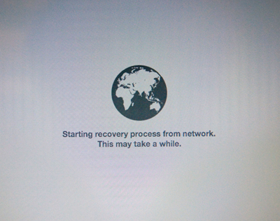

Not sure what the "internet recovery" screen is; can you upload a shot?

I've googled a pic of one of the screens once you start internet recovery. Cant take a screen shot until i get home.
But basically I believe if you start the recovery console and the recovery partition isn't there the internet recovery begins. This is on new macs only. The next screen that comes up before the one i have attached here is a dropdown box that asks you to connect to a network (wifi) once you connect (unless I assume you have wired connection) it connect with the apple servers and then gives you the recovery console via the internet.
