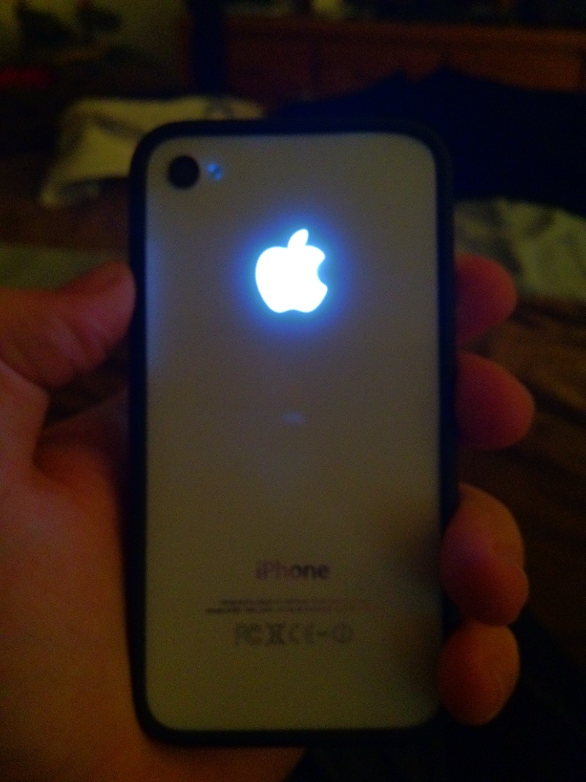

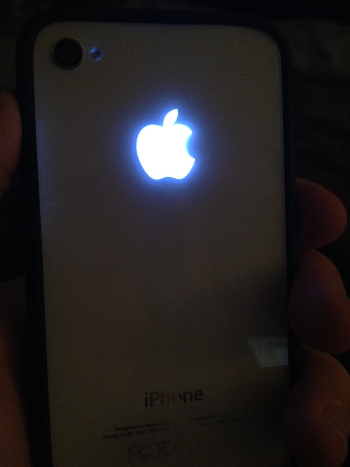

Well I finally got them out and mod is completed! It's really sick! Many complements so far on it haha

Used a really sharp but small blade and literly just turned it till it popped out haha and got 2 new screws from apple they just gave me 2 for free
